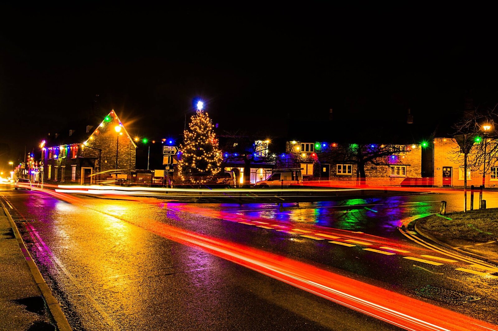

The festoons with coloured lamps along the houses are 1 Watt LED bayonet cap lamps and directly mains fed via RCDs, no isolation transformer. All out of reach for a person unless they are using a ladder.
The lights on the tree are a mixture of festoons that can be touched by a small person on the ground, the lamps are not easily removed from the cable.
Four strings of 150 lamps at 24 Volt AC incandescent fed from 2 toroidal transformers
Two strings of 150 lamps rated at 12 Volt DC supplied from 2 switch mode power supplies (with a lower voltage to match the brightness of the incandescent lamps)
The mains supply to tree is via an RCD in the base of a lamp post.
This arrangement is considered to be safe and there have been no adverse incidents.
