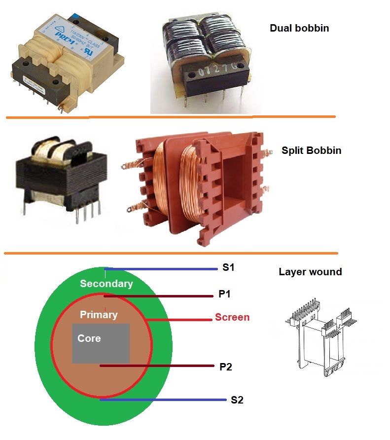

There is a lot to think about when choosing / evaluating an isolation transformer. Be it high power or an audio signal isolator.
Apologies for a thrown together image.
Safety Isolation galvanic
Dual bobbins on different legs of the magnetic core provide 100% separation of the primary from the secondary, even if one winding self-destructs due to overloading the isolation is maintained long enough for safety devices or procedures to cut the supply.
Split Bobbins may fail to isolate when one winding self-destructs and melts / burn the isolating material that separates the primary and secondary winding. Isolation may fail befores afety devices or procedures can react and cut the supply
Layer wound may or may not have the Screen which should be Earthed ( supply Earth )
Without the screen safe isolation may depend entirely on the insulation on the wire in the windings and this can be abraded by vibration if the coils are loosely wound and not vacuum impregnated
Safety Isolation
capacitive
Dual bobbins have the least capacitive coupling between secondary and primary
Spilt bobbins have some capacitive coupling between secondary and primary
Layer wound without the screen being Earthed can have significant capacitive coupling between secondary and primary. In the worse case this can lift the floating secondary to a potential above Earth potential and close to the potential of the Live of the supply.
When P1 ( outer layer of primary winding ) is connected to the Live of the supply then S2 ( inner layer of the secondary winding ) will be pulled by capacitive coupling towards the potential of the supply Live
This lifts the S1 potential up to supply voltage plus the secondary voltage which means 480 Volts on a 1:1 transformer or 345 Volts on a 2:1 transformer.
The amount of capacitive coupling may not ( should not ) be enough to allow a lethal amount of current to flow through a person standing on the ground or at height on scaffolding and in contact with S1 due to faulty equipment. But this current could easily be enough to create a mild shock and the person's reaction to this mild shock could result in a fall or other accident that results in injury.
