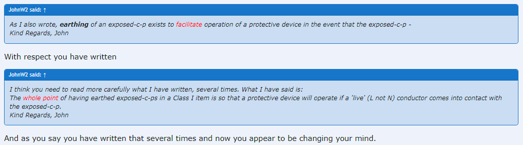

And I know that. The reason I write earth/bond is either may be required depending on the situation.
Fair enough - but it is crucial to understand what situations require one and/or the other - in p[articular, as I keep saying, that if "the situation" is that one has a floating supply, then earthing will achieve nothing (but will increase some other hazards).
I really don't understand what makes you think that I have changed my mind. Putting together the two bits you have highlighted in red, the meaning of what I have written several times is that "The whole point of having earthed exposed-c-ps in a Class I item is to facilitate [i.e. 'make possible'] the operation of a protective device if a 'live' (L not N) conductor comes into contact with the exposed-c-p." - which, as I've said, is only possible with an earth-referenced supply, since it simply doesn't 'work' with a floating supply.
You seem to have a rather worrying degree of faith/trust in what is achieved by 'earthing' (as opposed to bonding, which doesn't, per se, need to be earthed) exposed-c-ps. Consider a Class I item supplied by 2.5/1.5mm² T+E. In the event of a (negligible impedance', aka 'short') fault between L and the CPC/exposed-c-p in that item, the potential of its exposed-c-p will rise to about 62.5% of supply voltage (about 144V with a 230V supply) above MET potential. If there is another nearby Class I item on a different circuit, or even just a nearby earthed pipe/whatever, that exposed-c-p/whatever will still be roughly at MET potential. A 'touch voltage' of about 144V will therefore exist between those two 'simultaneously touchable' items, even though both are 'earthed' (connected to MET via {different} CPCs). The only thing that can minimise that PD is bonding between the two (both 'earthed') items.
