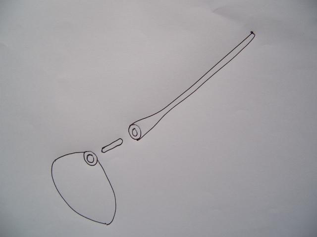

My aerial snapped off, the bit of metal that connected the aerial to its housing sheered off leaving a bit of metal in the aerial and a bit in the housing. I have managed to drill it out of the aerial and out of the housing, unfortunately there is no thread left.
I now need to find myself a small peice of metal (like a bolt without the end) and push one end into the aerial and the other into the housing to make the connection. Ideally I would hold both ends in place with a blob of weld or solder, unfortunately I don't have either. I need a glue for metal! Probably doesn't exist.
Has anyone got any bright ideas? I don't want to remove half the interior of my van to sort this out.

Time for a bit of thought here....there is a possibility that you could tap out the aerial and its mount up to the next metric size - i.e 4mm thread becomes 5, 5mm becomes 6, 6mm becomes 8. It depends on how much of the parent metal is remaining.
Araldite adhesive will cheerfully stick metals together - I guess your aerial shaft is made from aluminium so that won't solder, and welding isn't appropriate here. The thing is, you will need some sort of dowel peg plus adhesive to join these bits properly - but Araldite is an electrical insulator so you'll have to be very sparing where you put it!

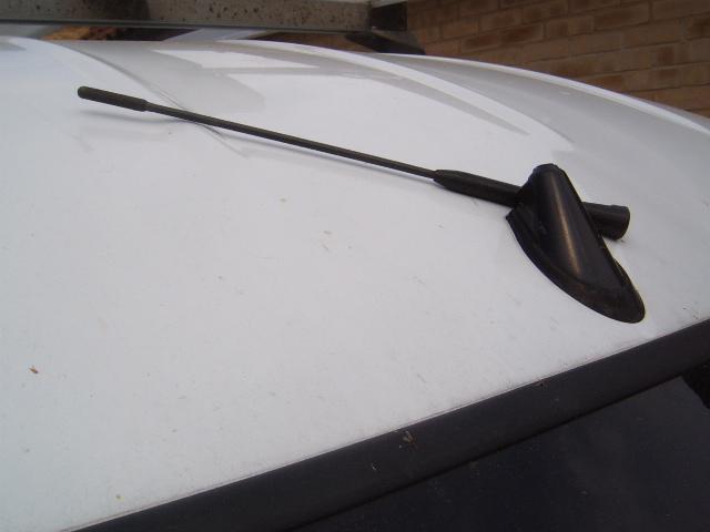

Thanks for your help. I have a Vauxhaul Combo 1.4tdi 55 plate. You can see by the photo what is left on the roof, looking from the inside of the van there is a ceiling panel covering the area, looks like a major job to tackle it from the inside. Thanks again.

isnt the interior light just under there, If so, Im pretty sure its just pop the light out, one bolt, and bobs your uncle.

By the way, the reason you can get talk sport is because thats on Medium Wave, and that aerial is inside the radio. The aerial on the roof which has snapped is for FM only. Cheers.

Just replace it all. Scrapyards often have the parts required, so you can rip it apart, and learn how to fit it back together properly.
The internal roof in these vans is modular, so comes off in one piece, as opposed to the glued, studded, old fashioned type of roof, so pretty straightforward job, and cheap.
Or just bypass the aerial, fit a new one, run it up to radio, job done.
