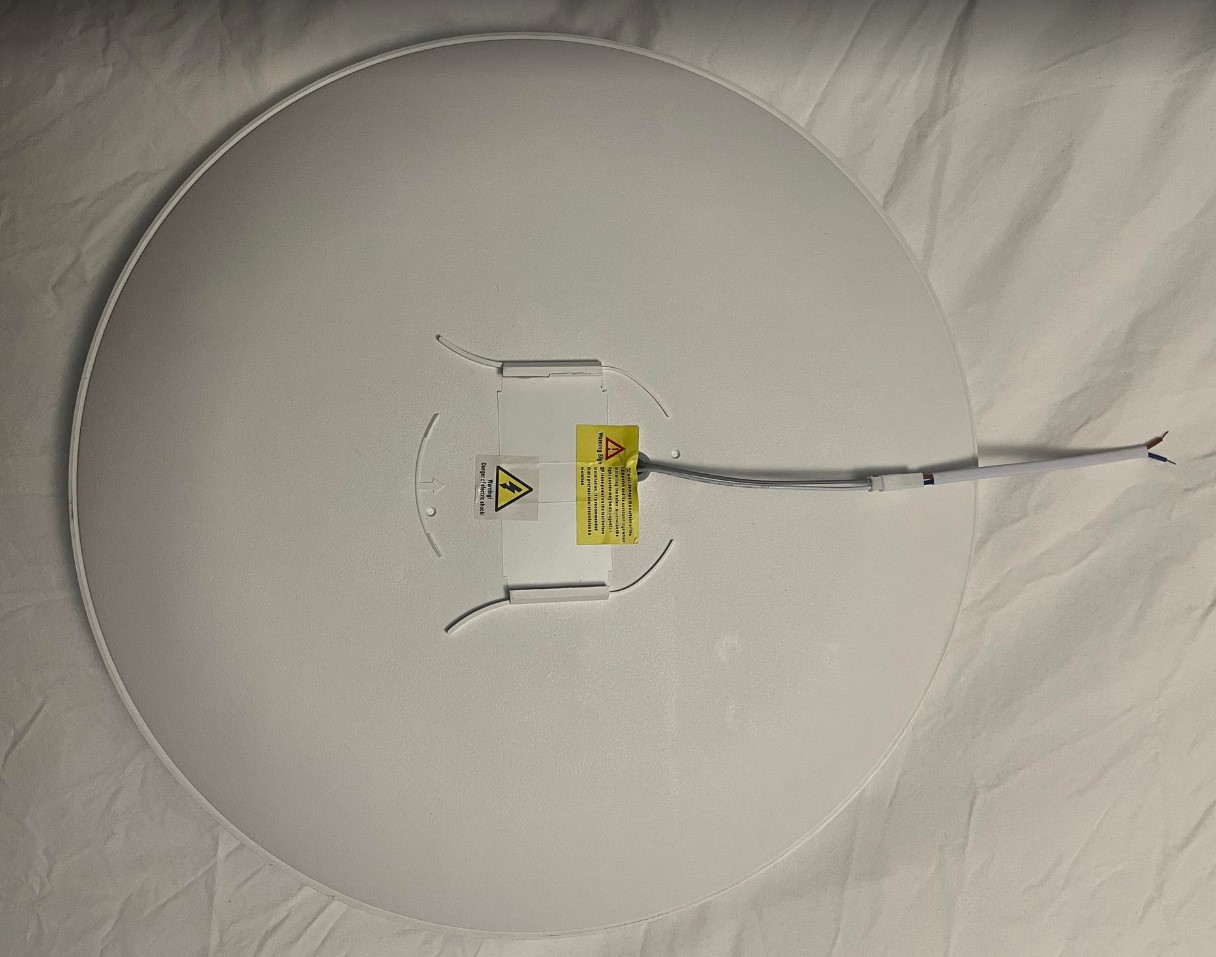

The LIVE (BROWN) and NEUTRAL (BLUE) wires on this new light are tiny (2 x 0.5mm2) compared to the existing wire LIVE (RED), BLACK (NEUTRAL) and GREEN/YELLOW (EARTH) in the ceiling. I've looked at my fuse box in the house for lights and it has a 5A fuse.

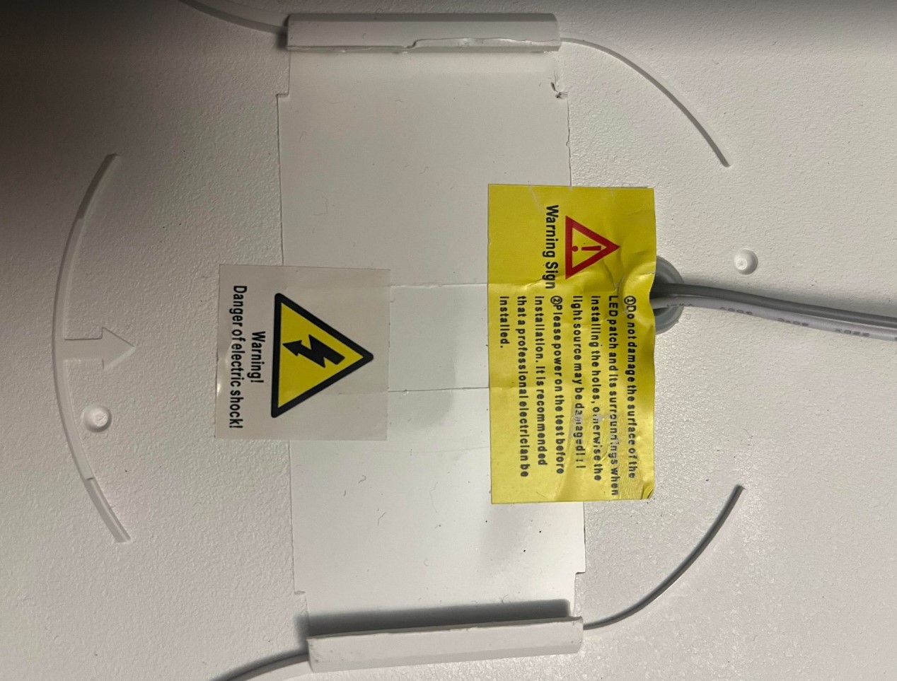

No class 2 warning on it. Only warns 'Warning, Danger of electric shock' and 'use a professional to install'..... no comment needed i guess

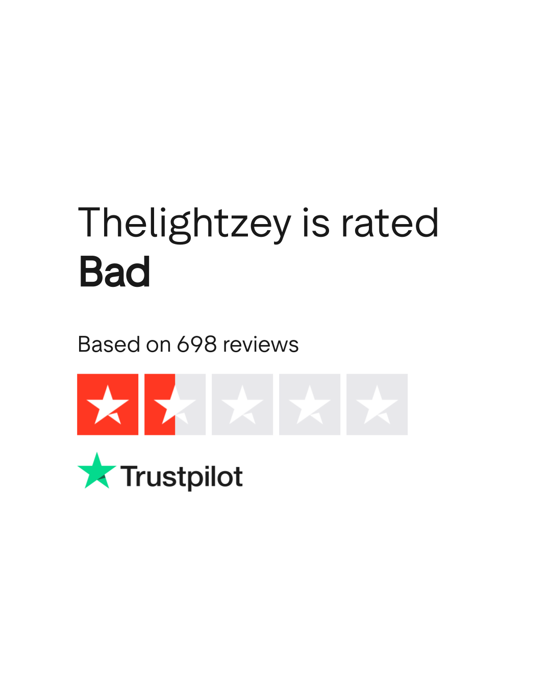

Oh dear, sounds a bit like this direct from China supplier we saw recently (Coobuy, also Manchester based):
Reviews aren't great either - and that's including all the fake positive reviews:
At least this fitting has instructions with it (for what they are worth :( )
EDIT
...the website registrant is "domainsbyproxy" - a company that obfuscates the website true owner's - not something to fulfill anyone with confidence.
If it's all plastic with no exposed metal, then, looking at your picture, the joint will be in the ceiling and in reality it should be safe enough. With the joint in the ceiling you need an enclosure for the connector. Others with more recent experience may be able to recommend a specific product. In practice the wire size should not be an issue as the current drawn is not likely to be very high.
