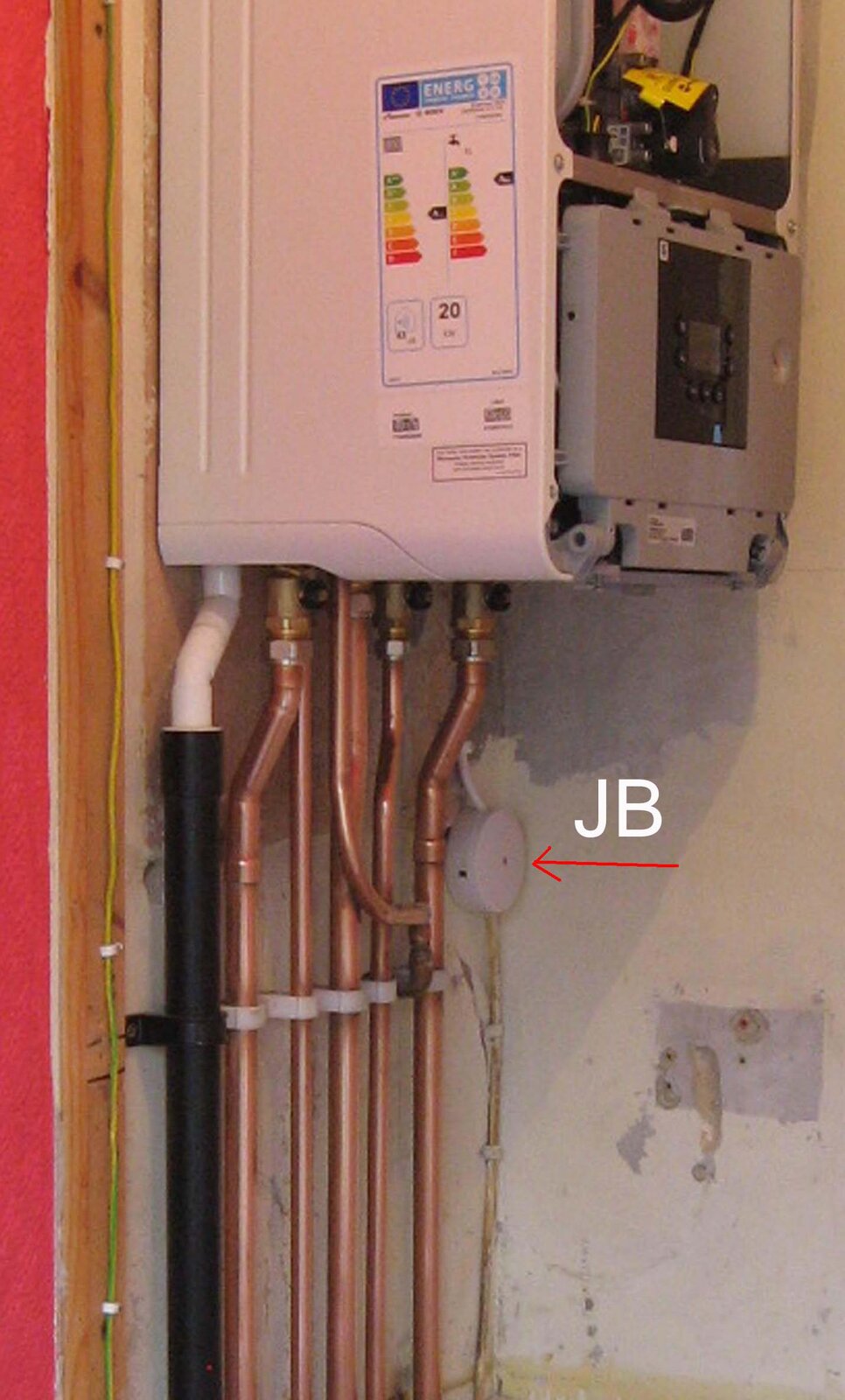

Hi,
Opinions please on the use of the junction box, under this new ch boiler installation.
The boiler is in Zone 3.
The 230 supply entering the bottom of the JB, is from a switched fuse spur on other side of the wall outside the bathroom.
Assuming it is screwed to the wall, it looks fine.
No zone 3 any more, not that that makes any difference.
The boiler isn't in a zone, there is no zone 3, is the boiler going to be boxed in a cupboard? As long as the cables are clipped up to the jb providing cable restraint, then it is fine. would benefit from the boiler cover being installed tho
OK, thanks.

Cupboard will eventually be resinstated.
