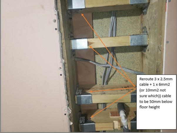

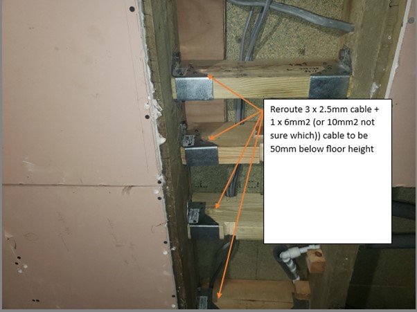

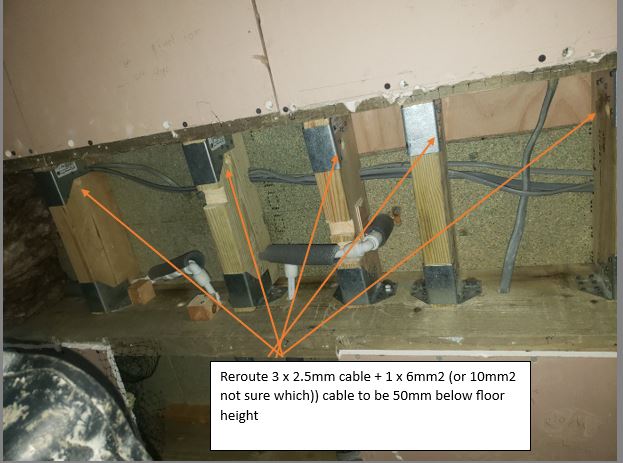

I am planning to cut and reroute 2 core and earth cables 50mm lower through precut holes in noggins. Specifically three x 2.5mm2 cable and one x (either 6mm2 or 10mm2, I can't tell which) cable. The noggins were added to better support the floor above. All three cables should fit through the precut 18mm diameter hole
The problem is that, according to the circuits, each 2.5mm2 could be part of a B32 ring main and the 6mm2 or 10mm2 is part of either a B32 or B40. B32 is 32A and B40 is 40A so larger than the 30A provided by the Essentials junction box.
On the screwfix site it says that the 'Essentials 30A junction box' can do 6mm2 x 2, but it implies 30amps maximum not 32A (B32). Also different sites describe this Essentials box as being 4mm2 x 4 maximum. Website is: https://www.screwfix.com/p/essentials-30a-3-terminal-heavy-duty-junction-box-black/7552d

Any suggestions of what junction boxes I should use for the 2.5mm2? I don't know what junction box to use. Can a '30A junction box' be used with a 2.5mm2 32A (B32) ring main?

Don't all electric cables that are installed under floorboards in joists have to be 50mm or lower under the floorboard? To prevent someone puncturing the cable accidentally with a screw. This screwfix community forum weblink describes the same issue https://community.screwfix.com/thre...ists-meet-regs-not-notched-or-drilled.140883/.
"17th 2008 Edition. Does say The cable should be run so that it is not liable from damage due to fixings from either the floor above or ceiling below and that it should be installed 50mm from top or bottom of a joist - Or mechanical protection to be installed."

The current rating of terminals and joint boxes is a guide figure only, rather than a fixed limitation. All that really matters is - can you get the conductors into the terminal, without a struggle, and correctly tighten the terminal screws. For through terminals, where the conductors can go in from both sides of the terminals, choc blocks, I aim to get the conductors, to each overlap the other, so both screws bear onto both conductors, so the connector body takes a minimum of the current flow.

Just leave them where they are. You need to weigh the chances of someone drilling into the floor against the chances of your junction box terminals failing.
You do have a couple of other options: disconnect the cables at one end and re-run them, or add protection (i.e. metal plates) above them.

It's too much work to disconnect the cables and reroute as these cables go through partition walls, it would take weeks to reroute them
I could add a thin 2-3mm metal plate and push this above the cables to prevent accidentally drilling through them, I could indeed to this end to end as long as this long thin metal plate was the right size.
These cables run underneath a partition wall under floorboards - very unlikely to drill through them

I rechecked and there is a 3"x2" CLS timber (which forms a horizontal part of a partition wall) above the 18mm floor. So, technically, the electric cables are 18mm (chipboard) + 50mm (timber) from the surface so 68mm. Does the horizontal timber count as height?
If not I can install safe plates (https://www.screwfix.com/p/sabrefix...ck/30038#product_additional_details_container) between the top of the cables and the bottom of the chipboard (install from underneath)
