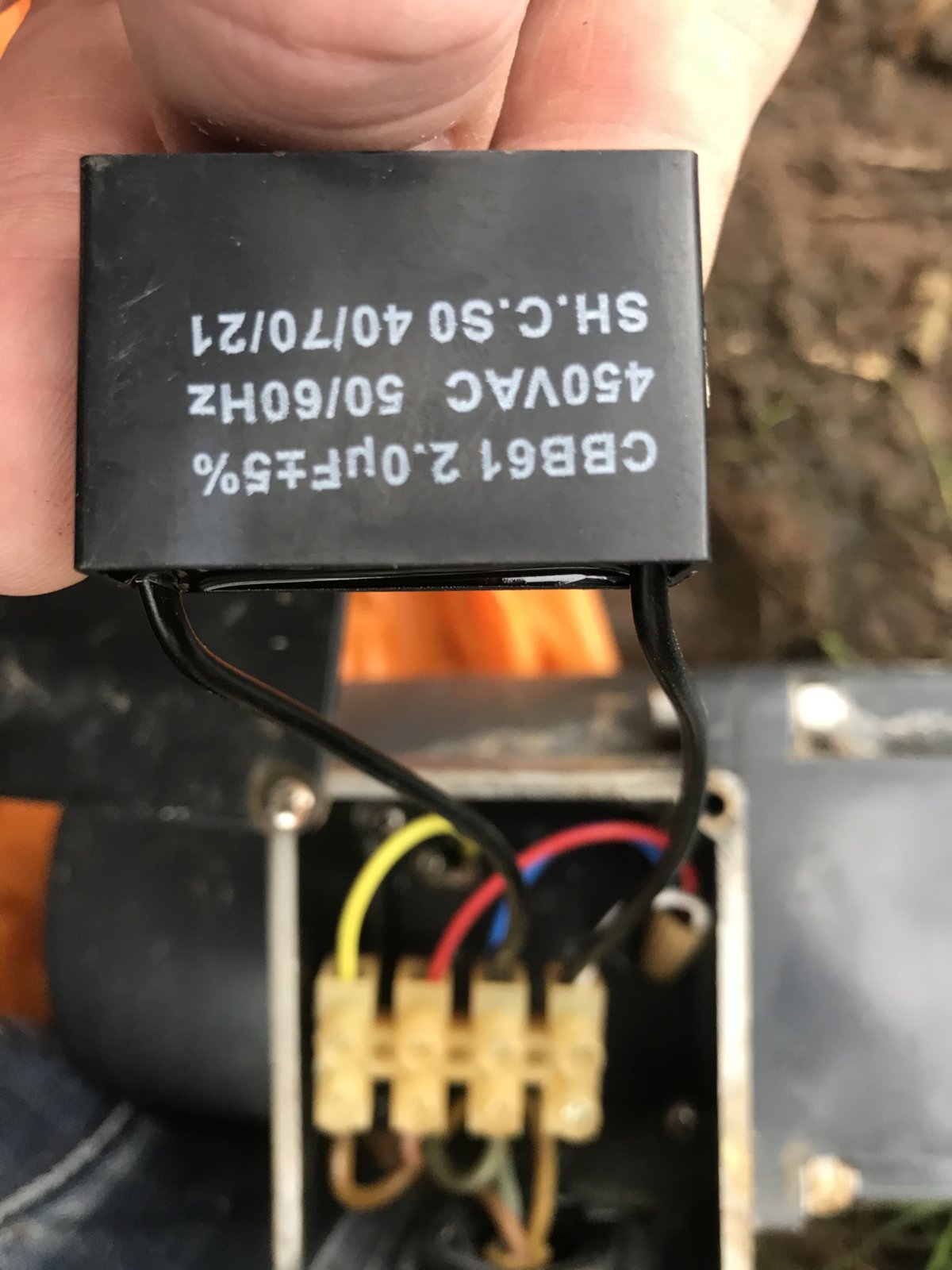

Hmm, not the result that I was hoping for :( I received the replacement Capacitor today and have fitted to the motor.
Powered up and reset the control unit (no visual reset response lights etc) checked the motor/discs and they are not turning.
Back to the control unit to check fuses and they are all in tack.
Anything further that I could test prior to getting stung with a big bill...
Many thanks as always ;)
I've just double checked that power is indeed getting to the motor and it is. I copied the wiring from the previous capacitor. Can I just check that this is correct and that there is only one way to wire prior to punting for a new motor..
Well boo indeed. I'm still a bit suspicious of the lack of activity from the panel, I'm also wondering what it is actually doing in your setup (there are a lot of empty connectors). Have you tried giving the motor or disc a turn (use a stick or something, don't think you'd want to get dragged in to that lot) while it is allegedly powered up
If the callout charge wasn't so extreme I'd be looking at getting the bloke in but as it is.....
Keep an eye on Fleabay and/or Gumtree and even Facebook Marketplace for a new panel
When you say you're getting volts to the motor- how many and at which terminals? (I'd be wanting 240-odd L-E, the same L-N and next to nothing N-E). Any discrepancies report back
Isolate the supply to the thing
Take some better photos of that terminal block at the motor end, mark the supply wires in some fashion to make sure you know which hole each cable goes into
Disconnect the supply wire (leave earth on, disconnect L & N) and disconnect 1 end of your new capacitor
With your meter on resistance settings (highest first so on yours it'd be 2Megohms), see if there is a circuit between the 2 terminals where the supply cable was. If there is a circuit, step the meter down the ohms range until you get some numbers on the display (rather than 0.00).
Another experiment worth a try- if that motor is definitely 240v AC then run power directly to it (bypass the controller in other words). Check all the info plates on the motor before you try this!
Consider (if you're confident the motor is FUBAR) taking it off and getting it fettled- there are places that will rewind and recondition electric motors

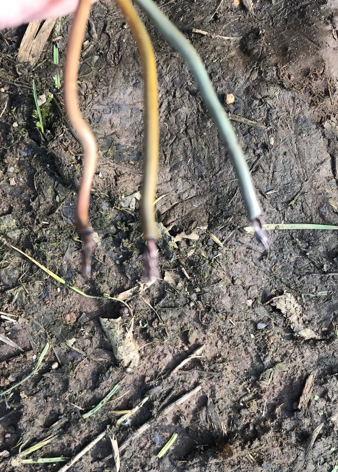

Hi guys, the local motor rewind place has long gone so I've purchased a new motor that I'm about to fit.. However the wire colouring has changed from the original and I just wanted to run it by you pros as I don't want to make any mistakes. If someone could point me in the right direction... As to what goes where and how to connect up the capacitor?
Old wires outside to motor.
New motor:
