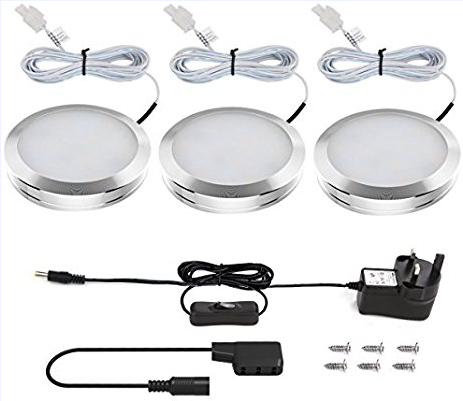

So it's a wall-wart.
Install a socket and plug it in.

Although you can get Click sockets designed for lighting, also the old British 5 amp there seems to be no real standard for lighting.
Also British law requires 13A plugs to be fitted to portable equipment, so to sell without a plug not easy.

However we never used those lights, only the ceiling lamp was ever used. Had the under cupboard lights been switched with the main light maybe they would have been used? The lights were supplied from a switched FCU so if the lights you show were used, then simple to swap a FCU for socket.
