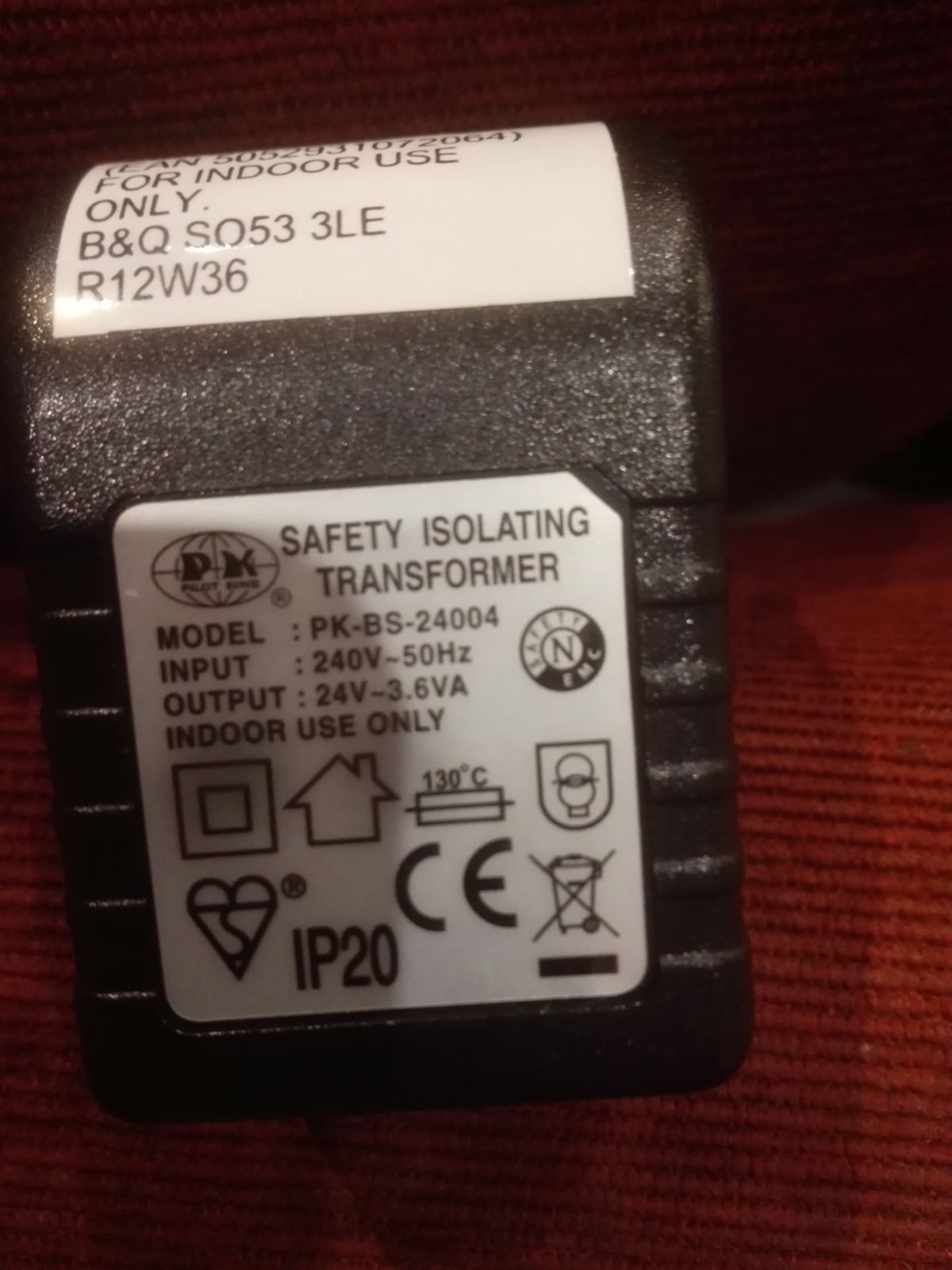

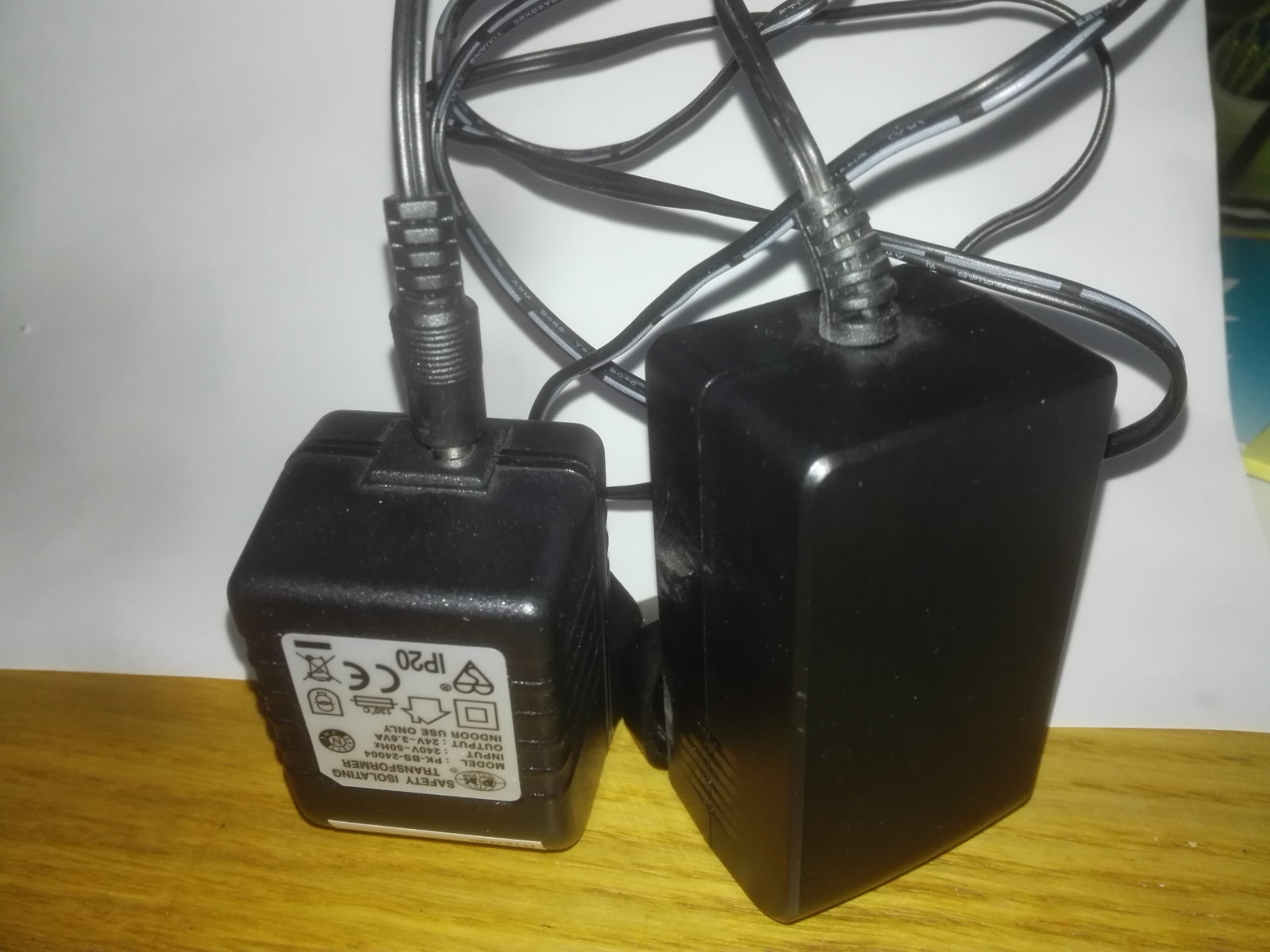

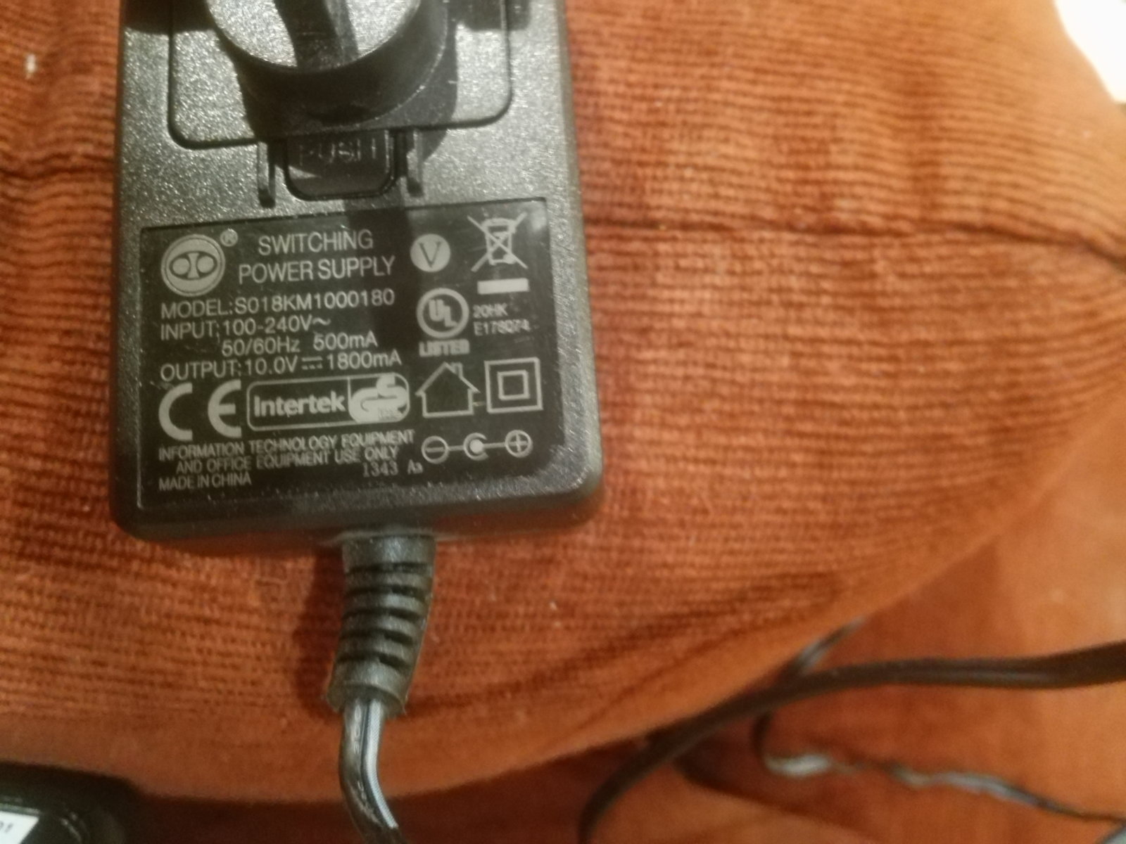

These two wall warts were plugged in side by side. The L/H one has an output socket for a string of LED's that you plug in. The R/H one has a fixed lead on the secondary and is for something else.
Mrs Secure unplugged the string of LED's last thing then plugged them in yesterday morning.
They didn't come on and she thought nothing of it.
In actual fact, the plug on the output lead of the right hand WW was identical to the lead on the LED string.
What she had done (I'm sure you have guessed) is connect the output of the RH WW into the output of the LH one, as shown.
When I investigated why the lights weren't on, I found two extremely hot wall warts and a strong distinctive stench of burning electronics.
They were so hot, I put them outside to cool off.
Neither are working this morning.
Nice...
If it was Mrs Sunray I'd be getting the blame...
Oh well Happy New Year (without lights:().

Or buy a larger wall wart where the design of the electronics of the power supply is not compromised by the need to fit into a very small space. This often means safety devices such as fuses and thermal shutdown are not included in the design.
Avoid warts with switch mode power supplies and instead opt for units with a wound transformer ( 230v to the required output voltage ) and bridge rectifier with smoothing capacitors.
