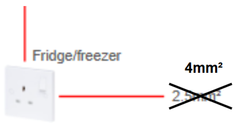

Kitchen wiring
Appreciate the responses.
Quick recap:
Very small kitchen, 2 double sockets is enough
Extractor hood on lighting circuit. Never seen that, good idea if allowed
Cooker isolator under worktop in adjacent cupboard, I read its allowed so long as its in the upper section above the cupboard's contents.
Hob and oven, share connector unit, got it
Fridge/freezer plug is off to the side. Appreciate the consideration.
I think that's it?
So no DW/WM/TD?
Until I read that I was going to suggest
