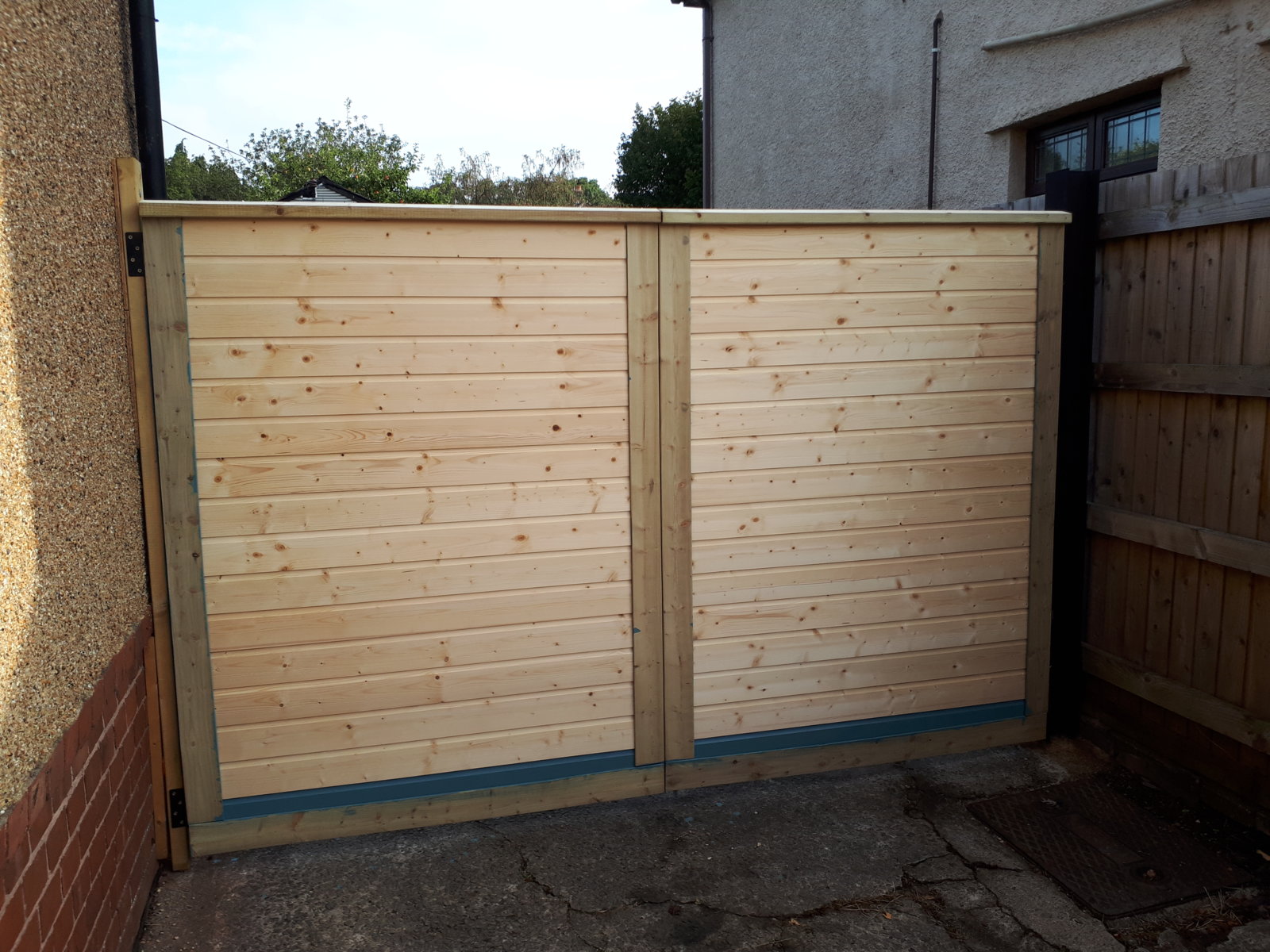

I've built a 6ft double gate for my drive, it's fully clad (pic below, still needs paint).
I need to find a suitable catch/latch/lock. ideally I want a self engaging catch/latch to hold the gate shut, with the option to lock/unlock from both the "outside" and "inside".
One issue is the gate opens outwards (it's midway up the drive) and thus a traditional ring or suffolk latch would be on the leaf that open second, meaning I'd need a second handle/ring on the first leaf and the latch arm would be a bit of a snag hazard.
I don't want the latch arm on the 'outside' for aesthetic and security reasons, however I do want to be able to open from the outside as well as the inside.
I'm considering a long throw gate lock for deadlocking purposes:
But I'd still like some form of 'hold closed' type latch that self engages and can be released by turning a handle/lever on either side.
I was considering fitting a regular tube latch and suitable knobs, but given the tolerances of the gate are a bit larger than that of an internal door, I'm thinking it may not engage properly, plus there's the consideration it'll be outside - how long before it rusts solid - do they do fully stainless/galv versions?
Does anyone have any suggestions?

Thanks, looking forward to getting it painted and finished properly now (just need some dry weather).
I'd prefer not to use a lever lock, as I've got a Euro cylinder on the front, and will have on the back (when I get around to it) so I reckon I can get a euro profile long through deadbolt, so I can be keyed alike for ultimate convenience.
my headache is the latch element rather than the lock. Most deadlocks seem to have a 15mm throw (from what little I can determine online). Whereas latches have a 10mm throw - this I feel is a little close to tolerance.
My gate frame is 4x2" so there's plenty of material for lock and keep, but I'd rather not have to scoop out a mortise now the gates are hung (I did the joints for the frame with a router, all my chisels are blunt as 20yr old abused chisels can be)

The lock in my original post is designed for outside use, so I'm not too worried about that, however the latch not sticking out far enough is my headache - I'd like a regular tube latch with 15-20mm travel for ultimate peace of mind, do such things exists?

20mm sounds reasonable - I work on a movement of up to 10% of the crossgrain distance, and given the timber had a thorough soaking over the past couple of weeks, and is now half-dry (at a guess), I've got a 10-15mm gap, so I reckon I'm about in the money - it's not sticking, but it will be interesting to see how big the gap gets after a long dry spell.
Nice idea, but I'd prefer something that cannot be opened from inside without a key, and ideally also with a catch-only option for back-and-forth days when I want to shut the gate, but not lock it (say if I'm working in the front garden).

Think I've almost found a solution, though it will involve having to chisel out a mortise:
I'll still need to find a handle and cylinder for it, but that shouldn't be too challenging.

Looks like a sliding door lock?
Will be very difficult to use where dimension aren’t stable .
On first look it does, I assume the hook element is to discourage prising the gate away from the frame. What I like is the long throw of the latch, which would help mitigate the effect of expansion/contraction of the frame.
