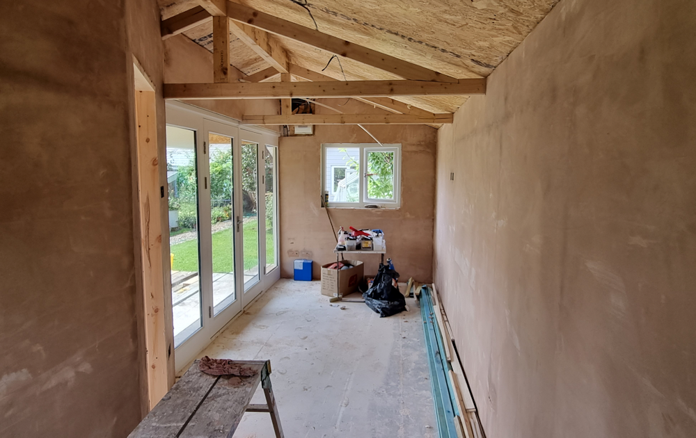

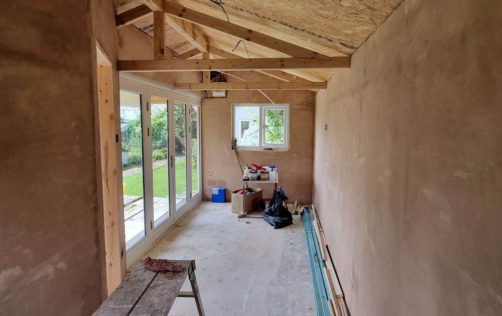

never tried that but I suspect it is a load more difficult than getting 2-3mm of skim on fresh plasterboard. I'd tried once and made a mess but then had another project where the finish wasn't critical so had another go and found I could make an acceptable finish (to me, anyway - a pro plasterer probably wouldn't agree). If you don't try you'll never learn. This is the biggest job I've done....
