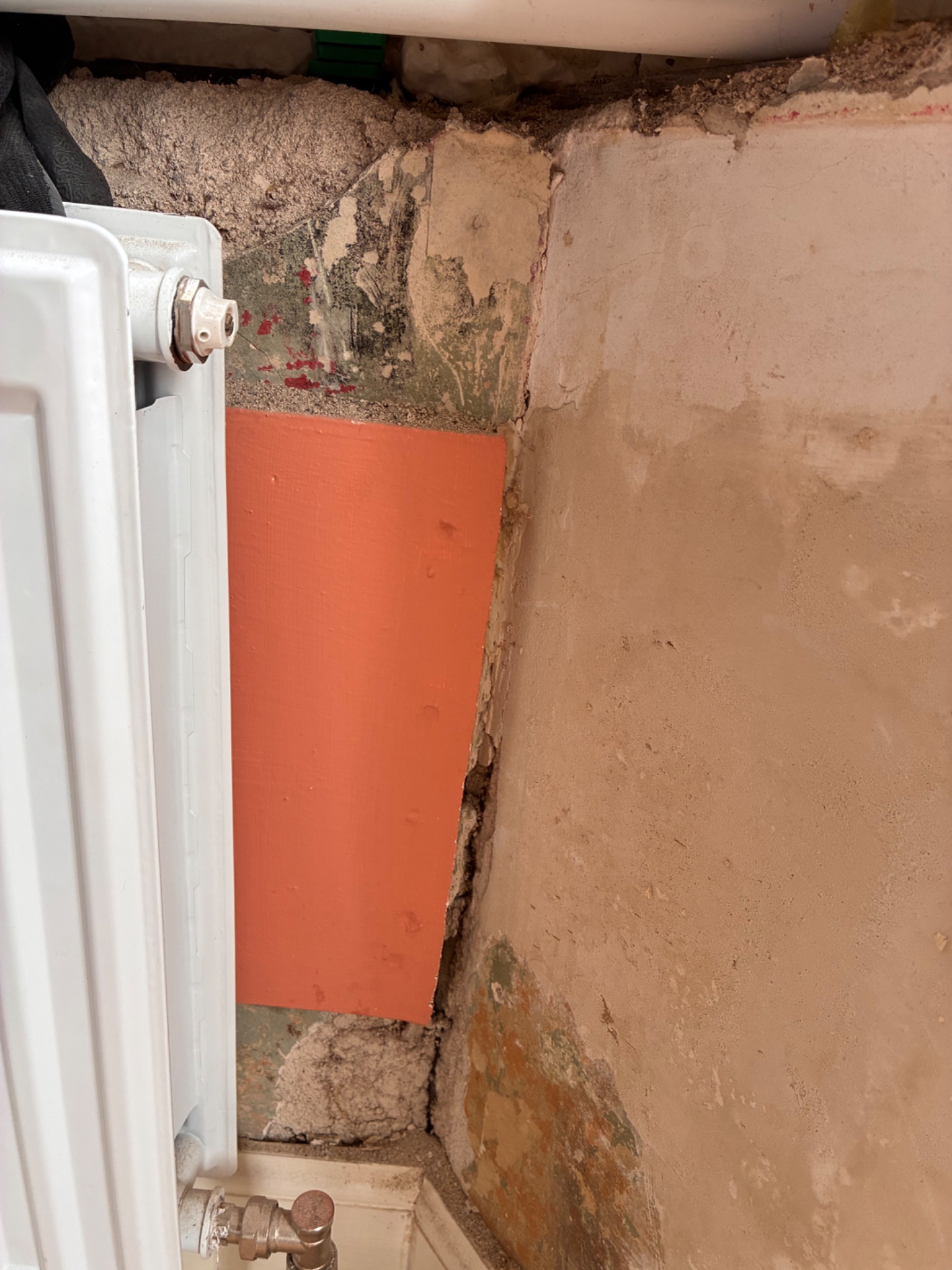

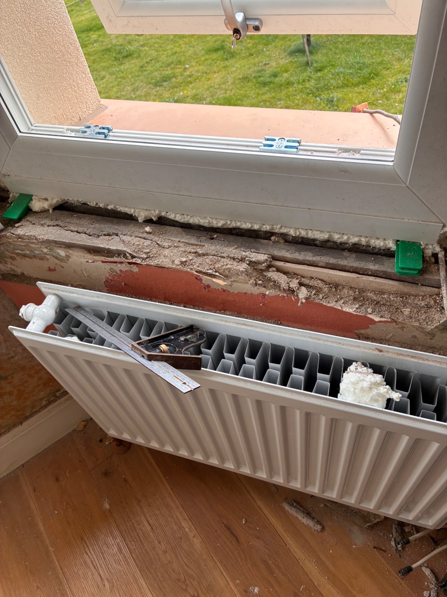

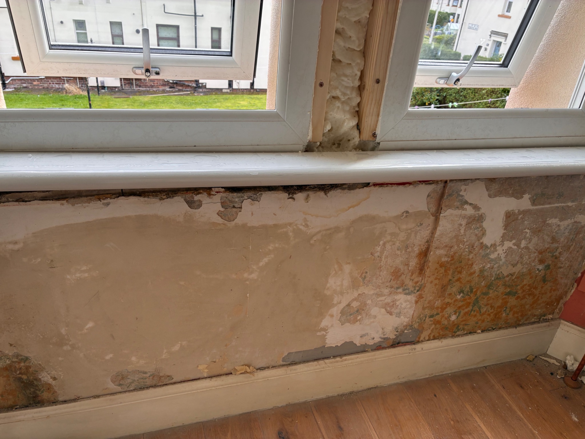

Be there when the new windows are installed - look carefully as the old frames are removed - look for damp or damage above cill level?
Definitely remove the plaster and laths, and after checking for rot then install insulation in the bays - insulation could also be fixed ON & across the studs, & then boarded over but it will pull your wall surface out a little. If possible dont touch the skirting or you could possibly introduce trouble.
Pull off the old and see where the water was coming in, and what the damage is. You may find rotting wood, which all needs to be removed.
The rigid foam slabs have twice the insulating value as the same thickness of mineral wool, and does not hold damp.
When rebuilding, you could use a breathable roofing membrane, and insulate thoroughly before refacing with plasterboard. While you have it open is a good time to add any electrical sockets you way want.

I got a couple of pics as they were putting the windows in. I don’t see anything obviously damp but until I get the lathe and plaster off, I wind know what’s under it

I can't see any reason not to take the skirting off.
You can strip the entire bay and have a clean sweep.
Good advice in here already. One thing I'd add from experience: once you've stripped it back, don't be in a rush to close it up again. Get a cheap moisture meter and check the timbers are properly dry before reboarding — plastering over damp lathes just traps it and the mould will come back. A week or so of decent ventilation makes a big difference.
