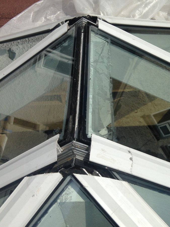

Hello,
I have installed a used timber lantern and need to put some lead on the ridge. It originally had a 0.7m length of very thin flashing moulded around the ridge where the timber apex and glass panels meet. I now need to replace the lead and am looking for a short length of suitable lead or an alternative. A thin easily moulded lead is needed or something similar. I'm worried about tapping lead around glass with a hammer, for obvious reasons. If it could be moulded and formed by hand would be better. Can anyone advise me on what to use and the best way to fit it? I had considered flashband, but would prefer a better and nicer looking solution.

Here's a picture of the ridge area I am trying to cover. I was thinking of filling all the gaps with glazing silicone. Then apply silver aluminium foil tape on the glass, so anything above it will not be seen from underneath. Then a strip of flashband over the area. That's the belt and I need some braces to finally cover the area, that will add some extra protection and look neat. I am currently considering code 4 lead at 180mm wide. I think this will be bonded to the area with a lead sealant. The tricky part will be moulding the lead around all the edges and straightening it out. Anyone have any ideas of whether it will be ok, or any improvements I could make
Mop stick with clips fixed on some how. The lead ridge could be made up on the ground and final dressing in situ.

I was hoping to do it myself! May not look as sweet as a pro, but so long as it is watertight and looks ok, than I won't mind. After all, except for an upstairs window overlooking it, no one will see it. I had thought the 3 layers - silicone all gaps, flashband to give more protection to silicone and then capping it with lead, or something similar would be ok. Any advice on the DIY method anyone?
Wakaflex lead free flashing .........Stretchable apparently.
Looks good, but a bit pricey compared with lead. Not wishing to sound tight, but £60 for 5m, but I only need 70cm length (the ridge is quite short.) Lead is under £10 per m. Would prefer an alternative, lead alternative. Preferably available in short lengths.
200mm wide and 560 cm long. I know I have to wrap it around each end and that will mean wider, but the centre timber ridge is thin and looks very good from underneath. I would like to trim it to about 3cm over each side of the timber.

200 mm wont be wide enough even doing it your way.. Use a mop stick (timber core roll) you will need 450mm wide minimum .
It was possible to buy a cement fibre ridge formed like a lead roll it came in lengths of about 1200 mm i think.. name escapes me for now
Yes I figure a layer of lead laid over would act as an extra layer of protection and look neater. I have tired finding a suitable ridge, but there are straight ridge pieces and I need 2 ends for the sloping front and back edges. I can't moptick it because there is no where to attach the mopstick to. The glass all butts up close to each other and cover the wooden ridge they rest on. I have put silicone into all the places the glass meet on the ridge, so the gaps are filled. I will now use some flashband cut to size and cover all these silicone area. This should leave the ridge water tight. Now I want something neater, preferable lead or similar that I can mould over the entire ridge area. I know it would just be sitting there as a cover, but I will bond it to the flashband with a lead sealant. Then seal all the edges. I hope to keep the ridge as narrow as possible, as the wider it is, there more visisble glass it will obscure. No point at looking up into the lantern only to see a fat band of lead. By putting flashband onto the glass first I will "darken " the ridge centre so you will not see the mess from underneath. I may put sliver tape down before the flashabnd, as it will be light reflective. Anyone any alternative suggestions or improvements?

Found it at Roofing superstore, just called a rolltop F/C ridge(y)
I would have glued a piece of timber between the glass and mop sticked it. I would have used black silicone to pacify the glass so it looks neat from the inside, but it seems you are already down the route you have described so crack on.
