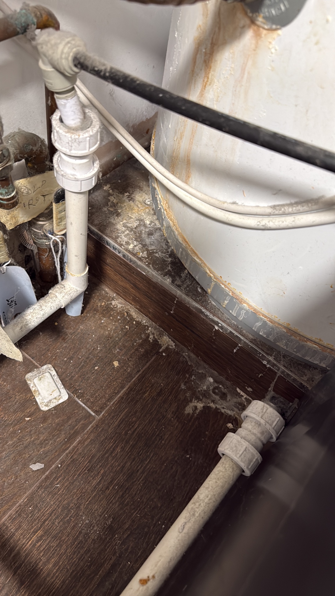

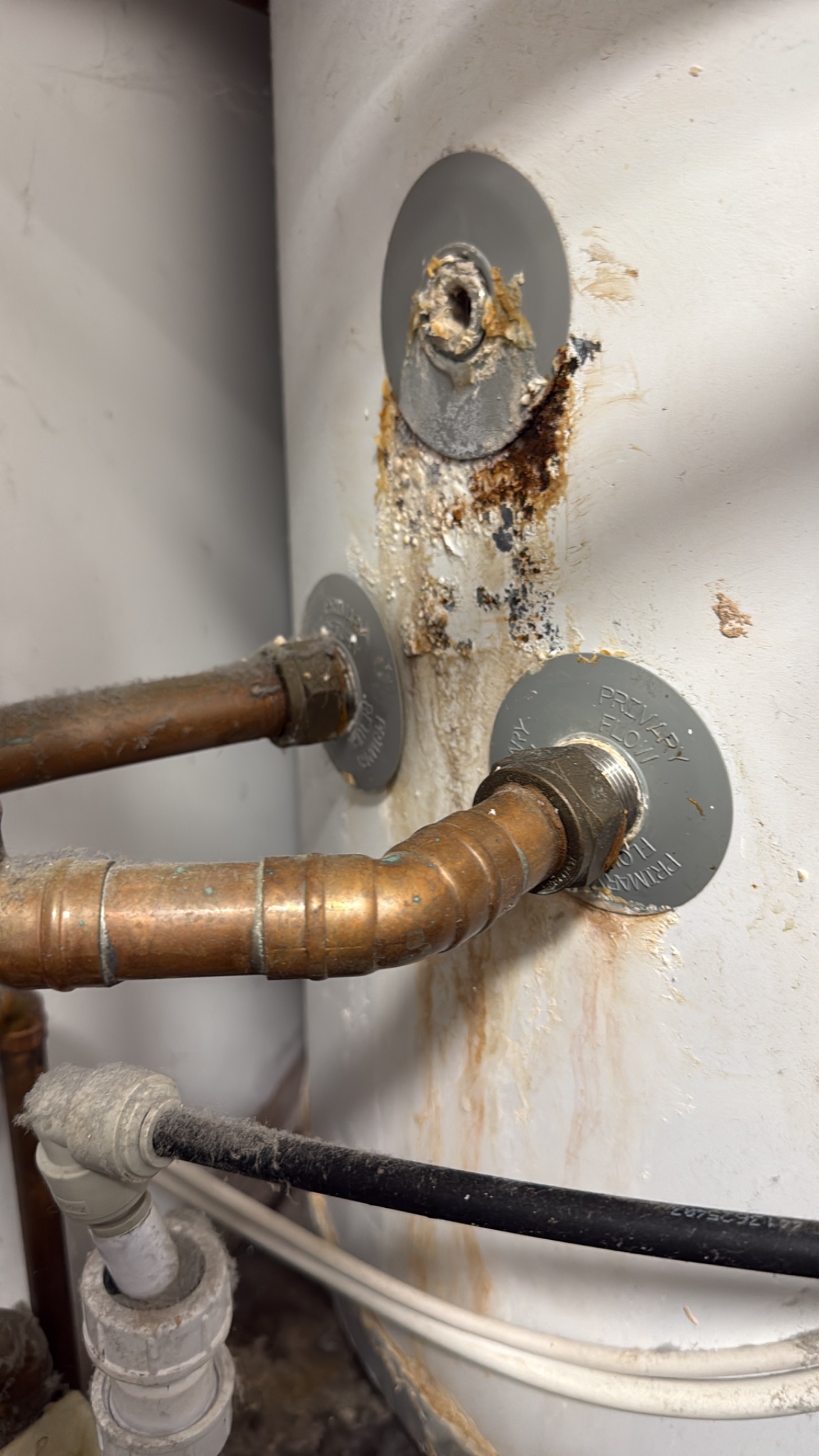

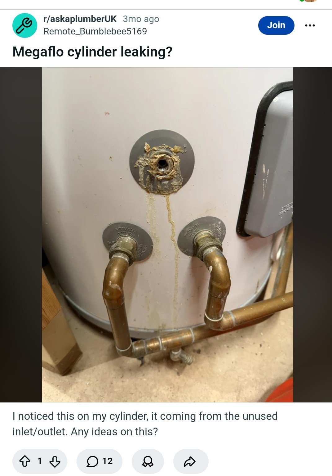

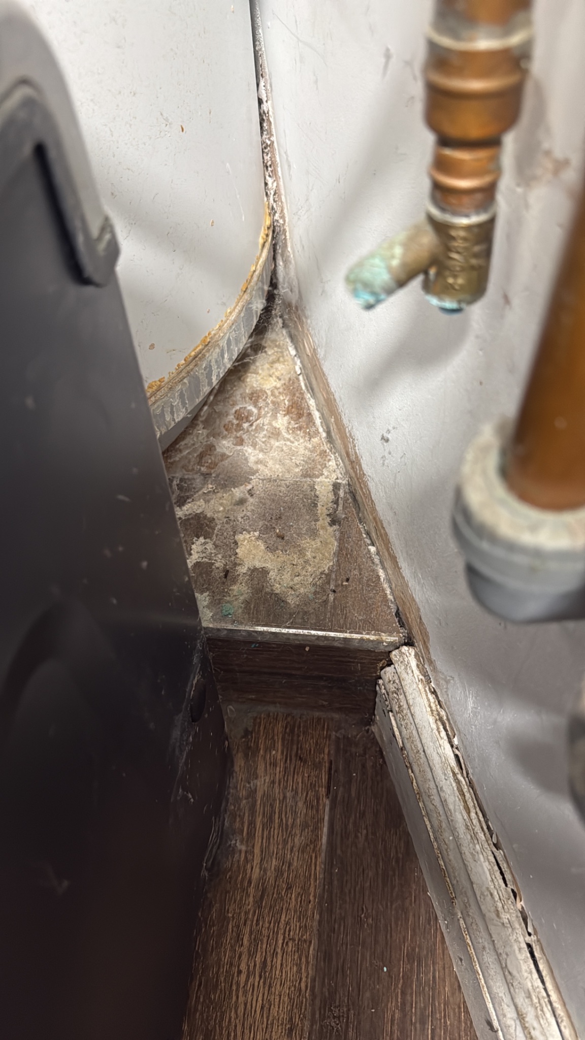

I'm facing a small issue with my megaflo—it has a minor leak near where the inlet pipe connects. I believe there's some mineral buildup, and I’m trying to figure out if it’s a quick fix or something more involved. I’d prefer not to go for a big job because it’s in a really tight spot, and removing the boiler would be a hassle I’d rather avoid.
Do you think there's a way I can do a temporary fix until I have the funds to get a more thorough repair?

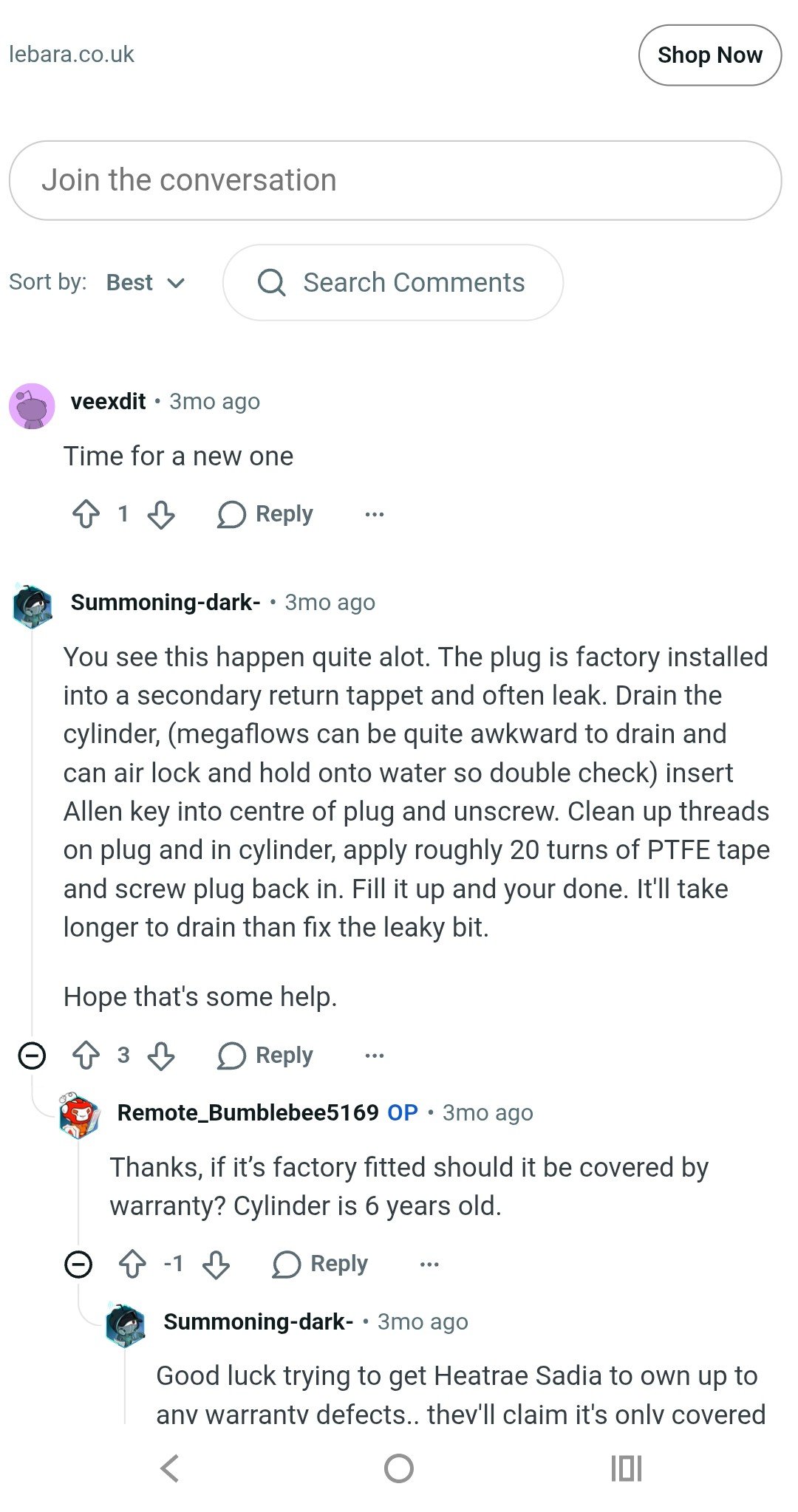

Clean it up.
Drain it down.
Remake the joint with whatever and try it... Nothing to lose really.
