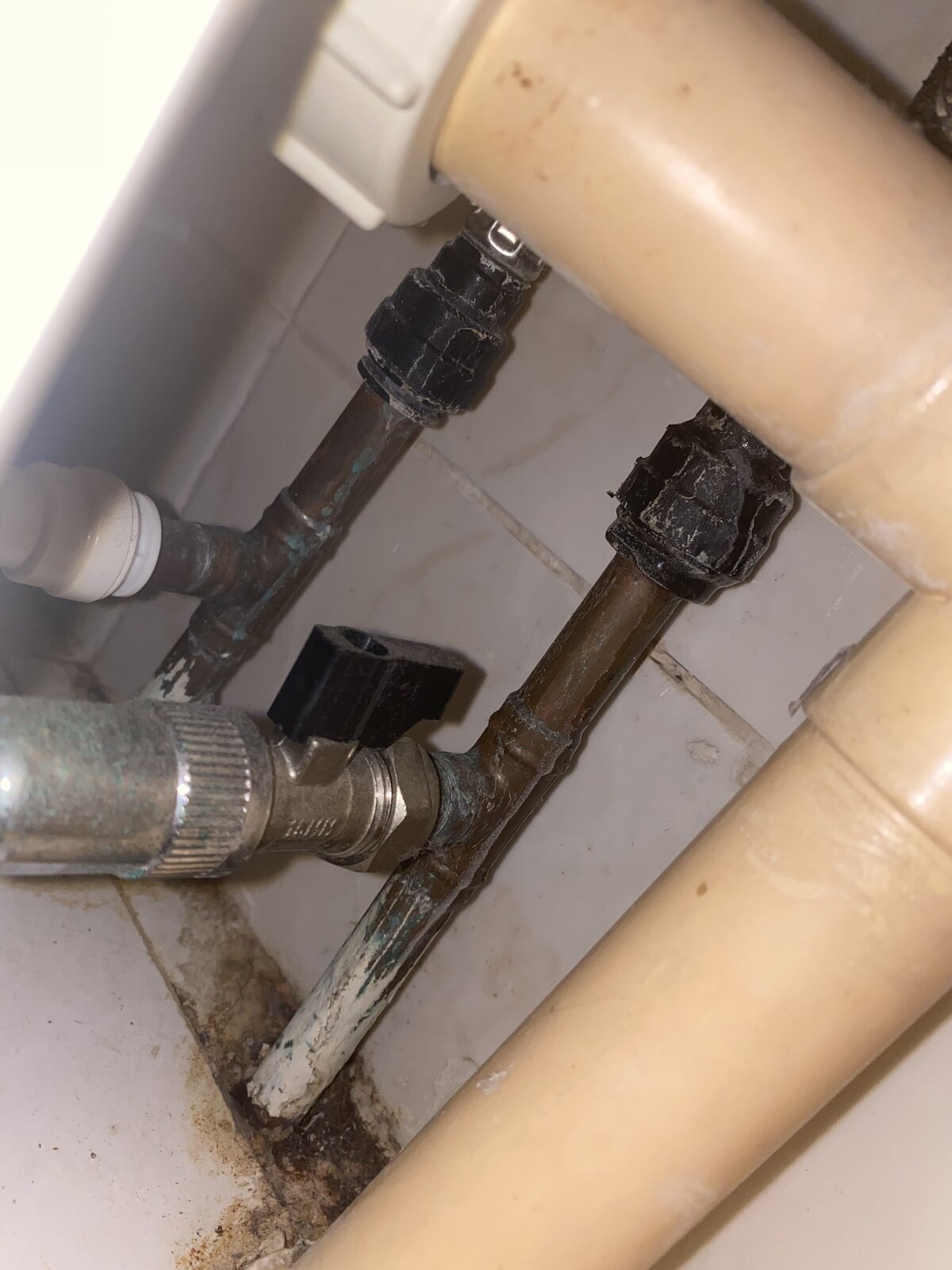

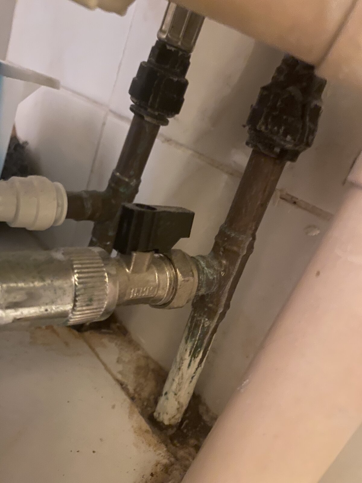

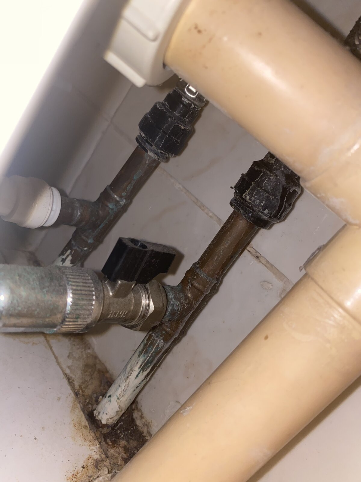

Leaking waste pipe
The water is tracking down the copper pipe from above , you need to follow the pipe upward to find the source.
Where does the copper pipe go when it goes up? Post a picture of above.
Andy
Thanks for the reply both. okay I think it’s the flexi tap connector…
Looks like the push fit fitting to the copper pipe ,unless it's wet higher up where we can't see.

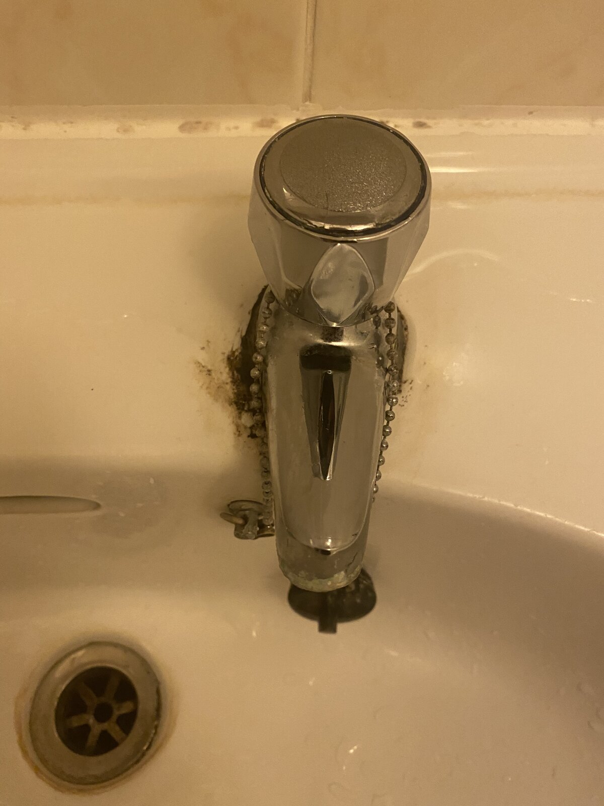

Or I think it’s the silicone around the tap
Is the connection at the tap connector wet or dry (where the threaded tap tail meets it)?
You tap has a drip and its running back under the tap and through the sink and down.
My advice is , new taps time.

thank you both
hi Terry it is wet.
Andy I think you are right. Do I need to silicone the new taps?
worth replacing the flexi connectors too?
Worth replacing flexi and tap if it's leaking. New taps come with rubber washer that sits under tap /top of sink and seals between the two.

Hi managed to replace (although I did keep the flex - It was too of a faff replacing them) the leak has seemed to stop!
Thank you for all the help and guidance :)
