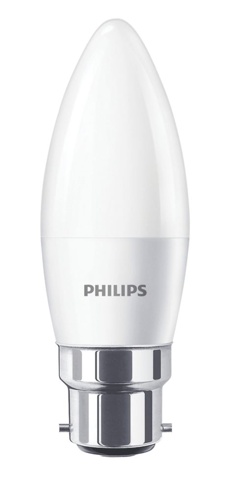

What with elec prices rising;
Can you get decent LED candle bulbs ?
Size 67mm high, 35mm dia.
All the ones I seam to find are 98mm+ high
Ideally would like frosted, warm white 40W replacement. BC

Had a quick look at belllighting.co.uk and their closest to your size requirements is a round ball, rather than a candle. That's 71mmx45mm
First advert I looked at was 105 x 37 mm and since that seems like a normal candle bulb and a standard globe bulb is around 75.5 x 45 mm it seems unlikely you will find a candle bulb of those dimensions. In the main LED bulbs are E14 there are some BA22d made, but not as easy to find.

this is the typical LED candle bulb, I selected BA22d as that's what you want, the first thing you will note is no light shines towards the base, same with E14 all the light is sidewards or up, with the base at the bottom they work well reflecting the light off the ceiling, turn the base to top and they do not do nearly as well.
You can get small wattage up to around 3 watt reasonable cheap jump to 6 watt and the cost goes up, so for me step one was change the three lamp fitting to a 5 lamp fitting, so I can use smaller wattage bulbs and still get the light output. Size does matter, the bigger the surface area of the bulb the more useful light it gives off.

Well I found my answer today. :)
After being dragged into B&M bargins I found some Energizer candles 5.6W 2700K
When put next to a 40W I can hardly tell the difference! I am amazed. In fact the LED looks brighter.
Will have to see what they look like at night.

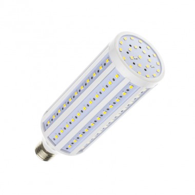

25W LED
2250 lumen are made, this one £17 which I think is expensive so what I did was fit a 5 lamp fitting, 3W at 180 lumen each OK in mothers house, at my house with larger room 5W at 400 lumen each so there is your 2000 lumen I think the problem is you need surface area to use LED's and a standard bulb is not physically big enough to radiate that amount of light hence 5 x 5W rather than one 25W is also means they are cheaper, got mine from Home Bargains the point is if one blows easy to get a replacement.
