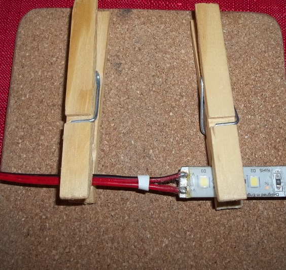

Glue two pegs to a piece of ply wood to make a jig
Before soldering scrape the copper pads to remove all the encapsulating material. Copper should be bight and shiny to ensure a good solder joint.

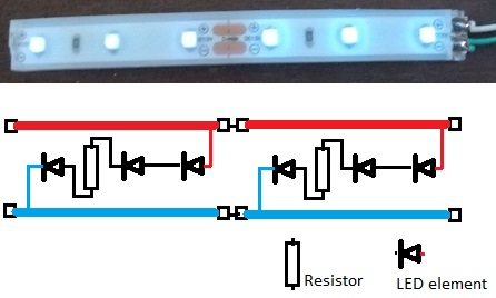

A LED is a current dependent device, some where you need to limit the current, as a pre-assembled unit they normally use resistors, but there is no single method, so much depends on the units you have.
Nice, might do this. It can be a bit of a struggle with only 2 hands. I generally use soldering flux. I find the solder takes to the job so much better.
I'lle get a picture later and show what the LED strips look like. The lengths I'm cutting vary massively depending on what sign I'm doing. Not 100% sure what the maximum length of led strip is that I can have coming from 1 X 12v power pack

The resistor controls the current through the three LED elements
Some of these strips are too bright for direct viewing when the supply is 12 volts. I have used 9 volts for some installations for this reason.
Cork table mat, It was quicker to mock up a copy than to try and find the real jig ( no pegs were harmed or glued )
Personally I'd be tempted to put some of these https://www.amazon.co.uk/dp/B07VNKZN1X in line as well and adjust downwards to what you find acceptable. A lot of the LED neon seems excessivly power hungry and bright, I repaired a christmas light that had rope light on it previously and I think I split it across 2 of those and I think I measured it at about 8 volts after tweaking it. Should last longer too
