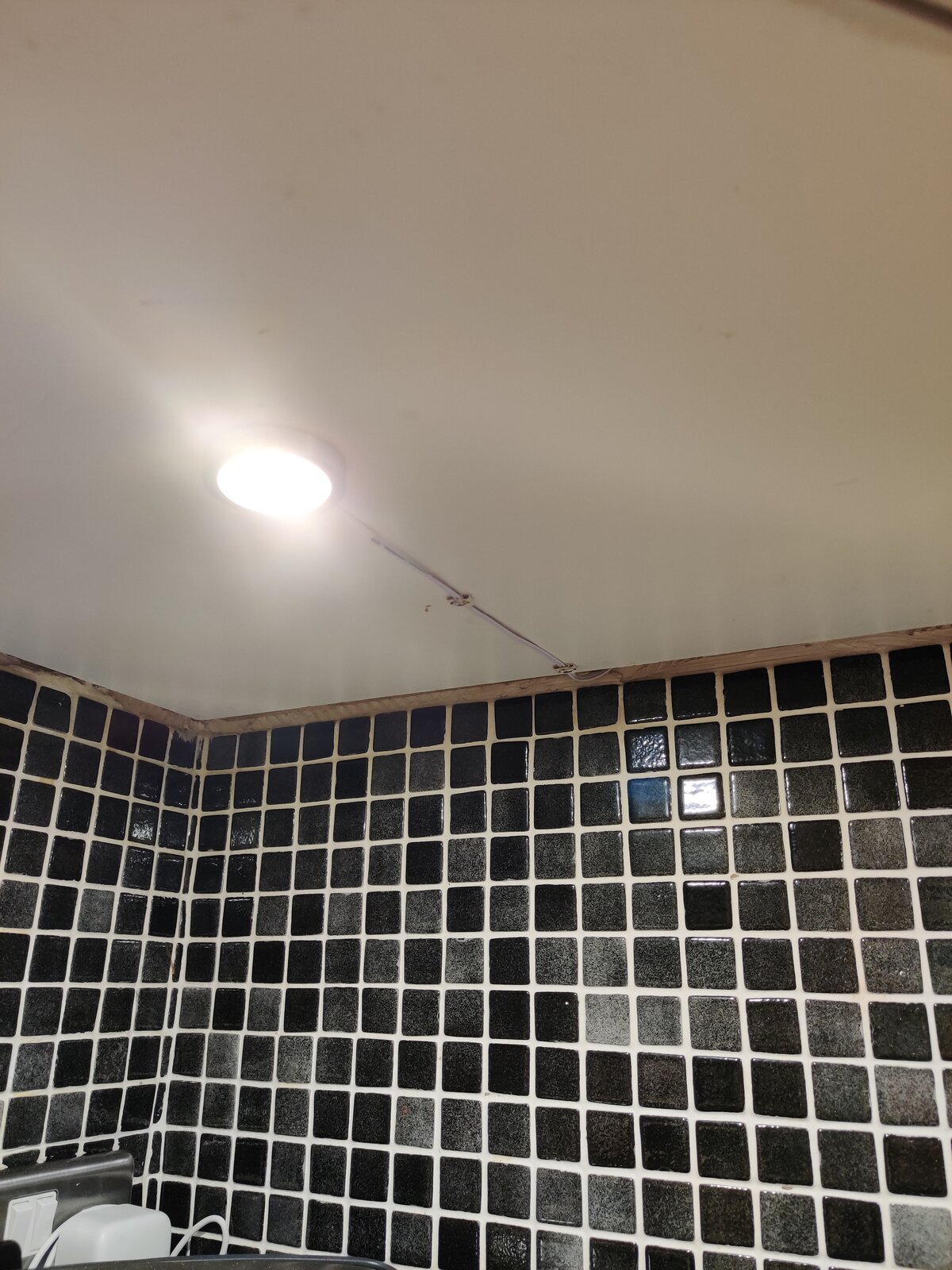

I used a box of pifco insulated staples that i had sat in the shed for the wiring.
Inherited from my FIL. Must be older than me.
Worked a treat.

Love the lights, like the 60+(?) Year old staples.
As per the poster above, routed up behind the cupboard.
