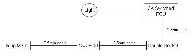

I have a light in my utility room that was working fine and has suddenly stopped working. It did not go off with a flash, the fuse board was not tripped and the bulbs are all ok. The wiring is as per the attached pic.
The double socket works ok so everythng in the series to this point must be fine. I have checked the following:
1. changed fuse on swicthed FCU - stil not work
2. checked connections in double socket, switched FCU and light fitting, all ok.
3. changed light fitting - nothing
4. changed cable from socket to FCU - still not work.
What else could it be? All I can think of is (a) problem with 1mm cable from switched FCU to light - this cable is visible (I removed it from conduit) and looks ok, or (b) problem with swicthed FCU itself?
Anyone think of anything else I can check?
You really need a multimeter to test for continuity of the cables. Make sure that you switch the mains OFF first!
If you do not have a multi-meter then a "lamp and battery" will do. Check each individual conductor in turn.
From what you say the cable between the FCU and light is suspect. If you do not have a multi-meter or lamp and battery, you could try to put a temporary cable in place, connected between the FCU and the light.

I put a temp cable between the switched FCU and the light in last night and still nothing.
It must be the FCU - quite possibly the fuse as metioned - I took out the 3A fuse that was in there and put in a 5A (all I had liynig around) just to test it. I guess I should get another 3A and try that before I get a new FCU.

It's no good fitting new fuses and thinking that you then have a good fuse fitted (as Coljack said). You may have a nice collection of duff fuses or the new fuse that you fit may instantly blow. You need a multimeter, a lamp and battery or even a known serviceable table lamp to use as a fuse tester.
I suspect that the later will suit better if you are not going to buy a cheap multimeter. Just test each of your spare fuses by fitting them into the table lamp 13 amp plug one at a time. As you are only "testing" it is Ok to test 3 amp, 5 amp and 13amp fuses this way.
Now, make sure that the fuse in the utility room circuit is OK using this method, then check all of your spare fuses and throw away any that fail the test.
If your circuit is blowing fuses then you still have a short-circuit.
If the lamp is a bayonet lamp ( not a screw in one ) then, with the power turned OFF check that the two spring loaded contacts that make contact with the lamp are still free to move in and out and still have spring pressure pushing them out.
Utility rooms often have high levels of humidity and condensation forms. The small springs in the contacts may have rusted away.
