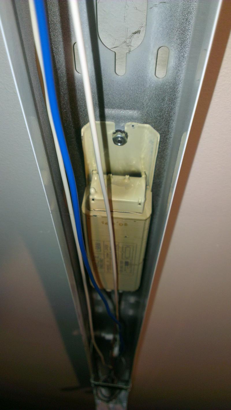

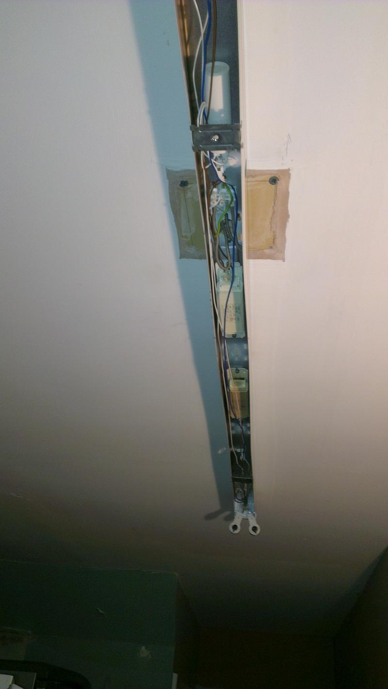

thanks for the reply lads. I've taken the cover off the light fitting and taken some pics. You can see one part, im guessing the transformer, looks slightly burnt, as the other similar part looks fine. I this simply a case of a new fitting?

here you can see this part is slightly yellowish, and it you look around the top of it, you can see burn marks

this pic is further out, and shows the difference in colour in the transformer to the other transformer.
They are chokes, not transformers. The yellow one almost certain has serioulsy overheated and is no longer servicable.
A choke determines the amount of current that can flow through the tube.
Most common cause of over heating is an internal short circuit in the choke creating a shorted turn which gets very hot.
If you are proficient, disconnect the "faulty" choke and see if the tripping ceases.
At least then you can have one tube until you can change the fitting or choke.

thanks for the replies lads.
I've disconnected the faulty choke and simply capped off the two cables that were coming out of it, using insulating tape. When i try the light switches, it no longer cuts of the power so thats one thing sorted!

When a choke overheats it is due to excessive current passing through it after it became faulty and unable to control that current.
This excessive current flows through the heaters at each end of the tube until the starter operates. It is possible that the heaters of the tube conneced to the faulty choke have been burnt out by the excessive current.
It's possible that both chokes have failed but one has failed more dramatically than the other. It's also possible there is a fault with some other component or maybe there is some sort of protective device hidden somewhere in the fitting. I've also seen flourescent fittings with the two tubes in series but I think your fitting is a bit big to be one of those.
Pretty much all the components in a flouresent fitting can be replaced but it would likely only be worth doing so for a fancy fitting or for a setup where you have a number of fittings which you want to match.
