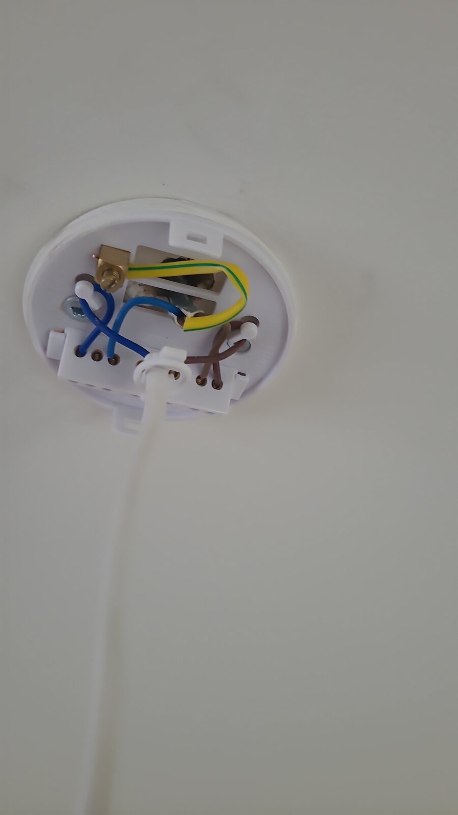

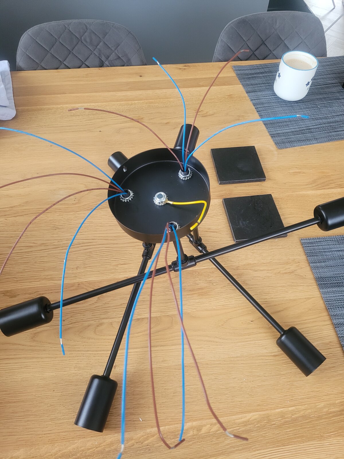

Hi all im after a bit of advice please and if you can save me calling a sparky out I'll buy you a drink iv fitted a few lights in my time as they normally come with the blocks already connected but iv never seen nothing like this one and the instructions are shocking it has 4 wires coming off each light 2 live 2 neutral how would I go about wiring this up? I'm swapping it out for a normal light pendant.. any help appreciated

Like colours together and also keep the green/yellow connected to the metalwork.
You'll need a 3-way chocbloc.
It could be a bit of a struggle, getting 6 separate wires reliably into one terminal. I would go for a 7-way, to make life easier - linking them as LNE, LN, LN along one side, then you only need two wires of each colour, into the other side.

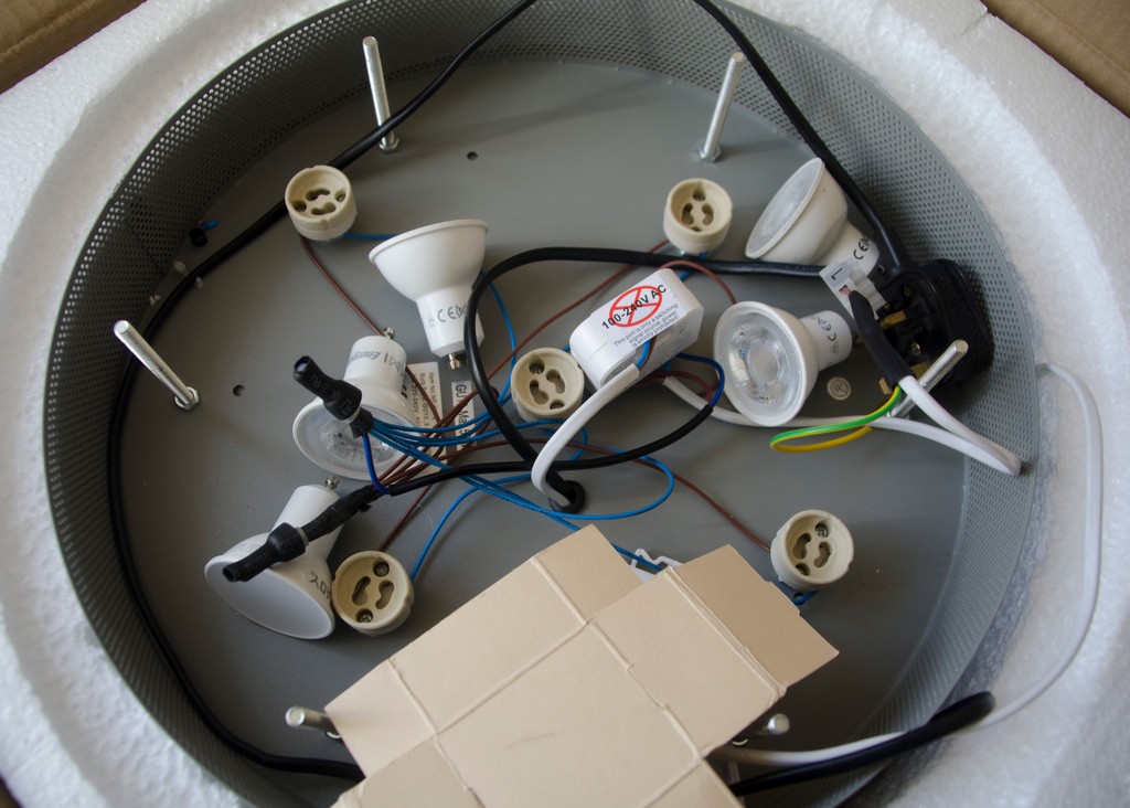

The light I got the lines and neutrals were already together using a tube nut type connector, although crimped. It allows you to wire each lamp independently if you want. I fitted a relay DSC_6062_1.jpg seen here testing before I put it up, so I can select one lamp, four lamps or five lamps. Today I would not do it again, I would simple use smart bulbs.
But it gives you the option should you want to.
In the main we keep to 3 wires in any connector, so as @Harry Bloomfield says, two blocks per colour may be the way to go. Not sure how much room you have, may be better to use crimps as they take up less space.
these take up less space and are normally fitted by the manufacturer before you get the lamp.
