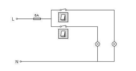

hi I want to take a feed from my consumer unit in the shed to a double light switch then to two lights. one switch for the first light and the second switch for the other light. I just cant seem to find the wiring diagram for this.

You dont really need a digram for one light.
For two lights - do it twice.
From Chivers' link:
thank you for the replies and there is no lighting at all at the moment.
So WOE is the CU for? How many ways in it? What are they used for?
And FYI - if you live in England or Wales and you need to create a new circuit for these lights you are supposed to apply for Building Regulations approval before you start work, or have it done by a registered electrician.
