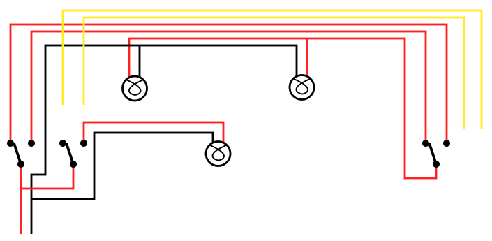

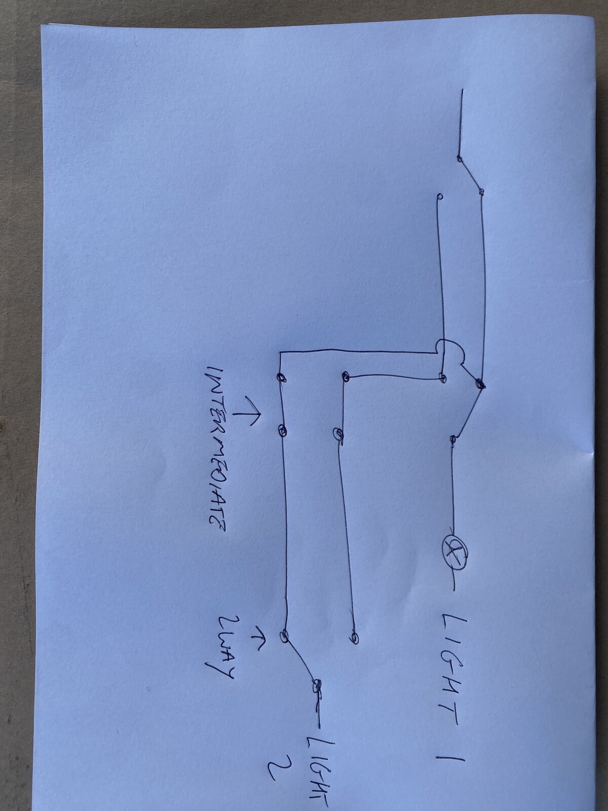

Dear All,
Please treat this as a logic puzzle for your enjoyment, not a call for assistance!

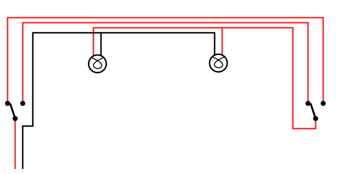

Currently my living room lights are controlled by two switches in a conventional way as shown:
The wires are singles in conduit.
I'd like to add an additional light, separately switched. Clearly it's not difficult to have it controlled from a switch at the left side of the room:
Question: How can I also control it from the right end of the room? As shown above, there is currently a pair of unused yellow strappers running from one switch box to the other. Can I achieve two-way switching for the new light using these yellow wires?
Note I'm not interested in solutions involving smart switches, relays, or additional wires. The cable to the new light needs to come from the left switch box as shown. All that's allowed is changes in the two switch boxes.
I'll post my own thoughts tomorrow!

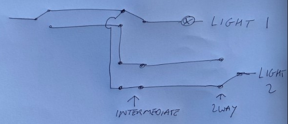

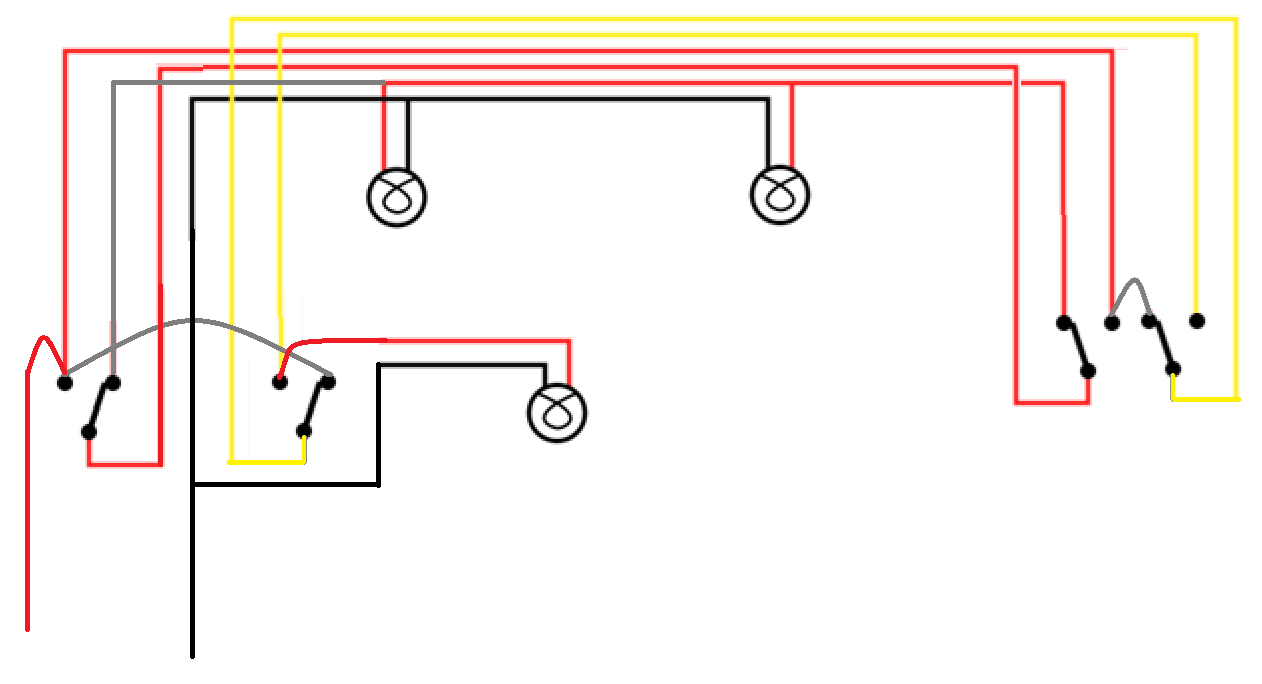

My initial thought is additional wiring is required but the least I think I see is this with extras shown grey
Happy to see your thoughts

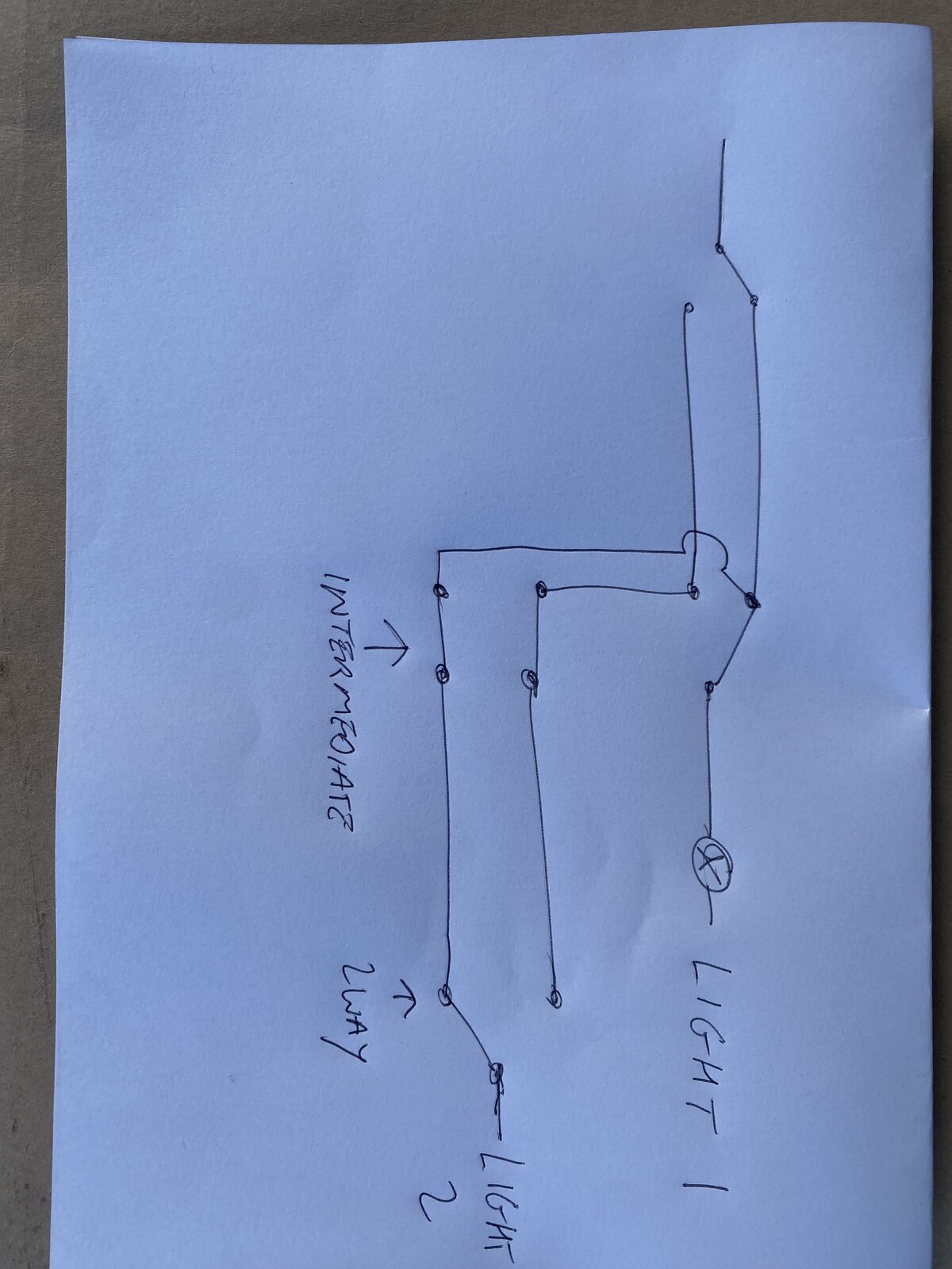

hmm second thoughts rethinking it
Intermediate and 2-way to control new light
2 red strappers looped into intermediate on right from existing 2 way switch , 2 yellows out
Standard 2 way switch on left
I think that works

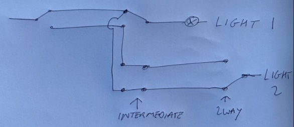

My thought was the same as sunray. But I don’t know if we were allowed to add the additional wire between the light and left sw
I'm reasonably confident my idea works
Intermediate fed from 2 existing strappers on right , standard 2-way on left
No feed or additional wiring needed
One of the intermediate feeds is always live
I think that works , it'd be the same as 2way > int >2way and there's no crossover, i think
Apart from that, are you forgetting that light 2 can only be wired from the left hand side?
It doesn't really matter as per the diagram which side the light's on. 2 cores between intermediate and light 1 switch 2, 2 cores between light 1 switch 2 and switch 1. What's more problematic, is the first switch in the line will swap states on both lights
