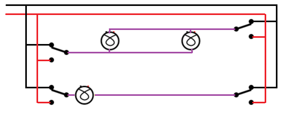

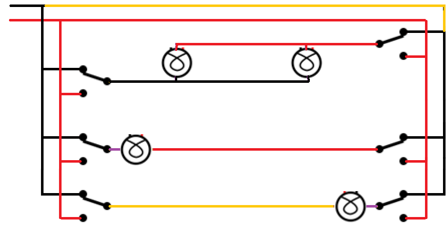

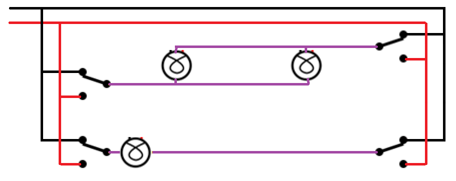

@endecotp Thanks for the exercise, kept us entertained at least. A few comments on your diagrams.
1) I'm not sure what you've got in the right switch box there, but whatever it is seems a bit cheeky
2) Yep
3) Yep, that would work
4) That's genuinely very clever

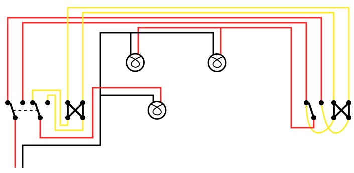

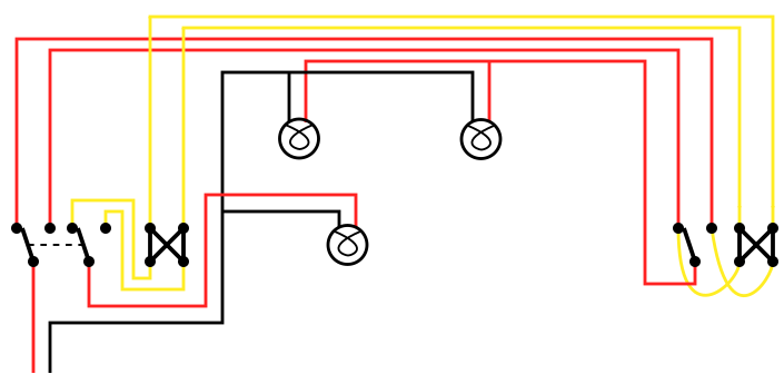

My other ideas all involve an intermediate (crossover) switch in the right box, as suggested by mikehammer69 in post #7 and drawn up by EFLImpudence in post #20. Here's my version of that circuit:
Of course as you've noticed that doesn't quite work; you can control both lights from both ends of the room, but the switch for the original lights at the left side now also toggles the new light.

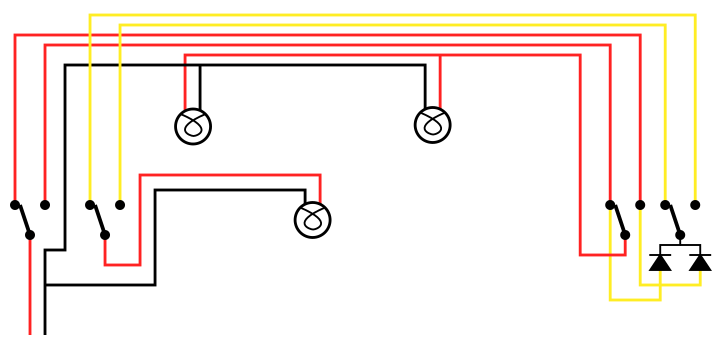

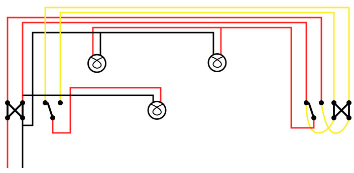

I have a couple of thoughts about how to fix that. Firstly, you could use a DPDT switch to "undo" the unwanted toggle from that switch:
The problem with that, of course, is that you can't buy DPDT switches to use in regular wall switch boxes; some nasty bodge would be required with an un-matching switch.

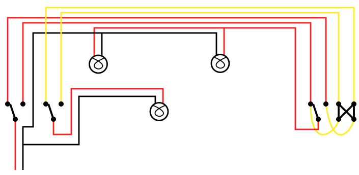

On the subject of nasty bodges... that leads to my final offering:
That works in the sense that all the switches do what you want, and it only uses readily available components. The problem is... well, I hope you can spot it!
I'm just wondering how that would be EICR coded
At least one manufafturer makes a DP2W euromodule, I think Legrand
Looking at number 4 is giving me a headache :oops:
Well if you are proposing switching live and neutral you have made it far too complicated, it seems you have too many wires in your system :ROFLMAO:

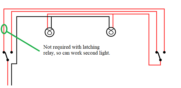

I am sure one can fit a relay at the lights, and use momentary switches, to change the state of the relay.
However, the relay I used to do this was a smart relay, so not permitted. It did not need momentary switched, change of state changed if on or off. And after fitting, I wished I had simply used smart bulbs.
I can't see the point of not using electronics. I remember the control panels of yesteryear, things of beauty, but today a little PLC does it all, easier to install, easier to program, easier to repair, one has to move with the times. How many people remember the hand signals when driving a car, we have moved on.

A latching relay at the lights, would allow use of momentary switches, to change state of the relay. 1761222663510.pngSo you have a spare wire which can control the other light. But a latching relay today costs more than a smart relay, so what is the point?
