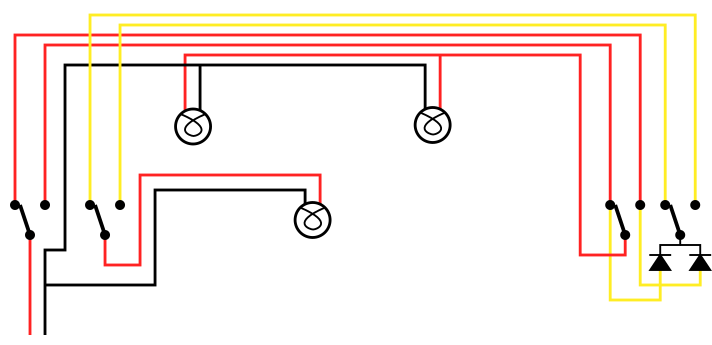

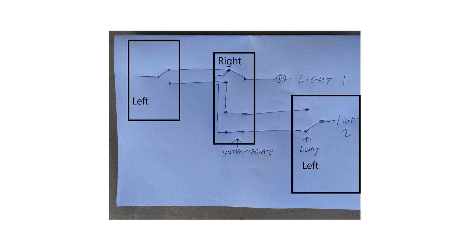

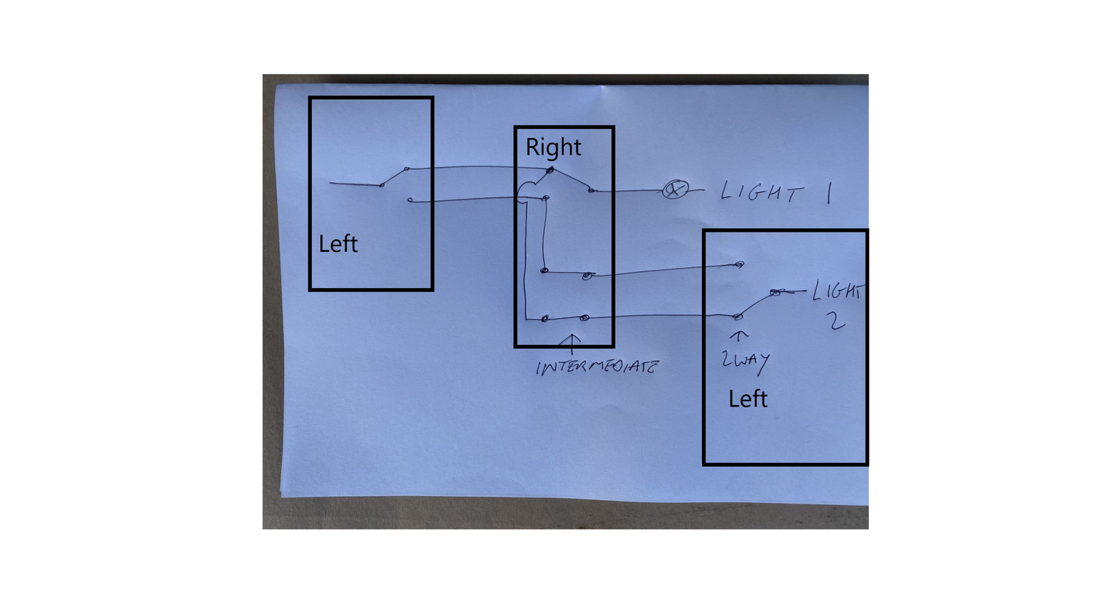

It doesn't really matter as per the diagram which side the light's on. 2 cores between intermediate and light 1 switch 2, 2 cores between light 1 switch 2 and switch 1. What's more problematic, is the first switch in the line will swap states on both lights
Never mind I read it wrong, I think he's got it. Edit : No, it does swap both.
Even if he does have it, I still don't think it is possible to do under the conditions of the puzzle.
It'd be in the conditions I reckon, doesn't say anything about not making links in the switch boxes. It definitely doesn't work as drawn though

As I understand it, we can alter things in the switch boxes, but we CANNOT run additional wires anywhere (even though it is in conduit).
I would say links in the switch boxes would be more than acceptable.
You use the existing yellow strappers twice
They also feed the intermediate for light 2
How on earth do you expect that to work correctly? Not the sort of solution I'd expect from a longtime spark.

Thanks for all your posts - I hope you enjoyed the mental exercise! Here are my (partial?) solutions:
Firstly, of course it would be easy if there were a permanent live a the right switch. There isn't, but one or other of the red strappers will always be live. So if we had a DC supply, we could do this:
I spent a while trying to invent an AC version of that, and failed. Even with a few transistors I needed a neutral at the right box to make it work. So that was a dead end.

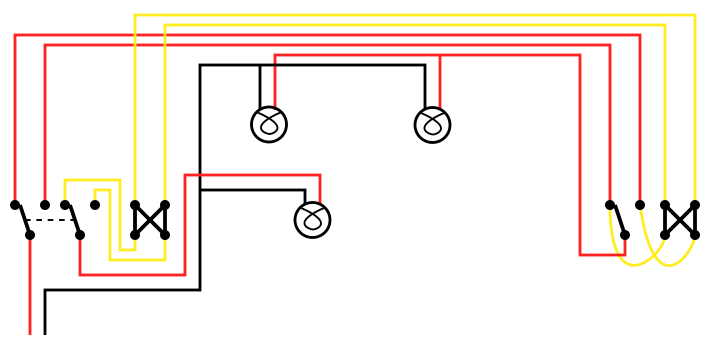

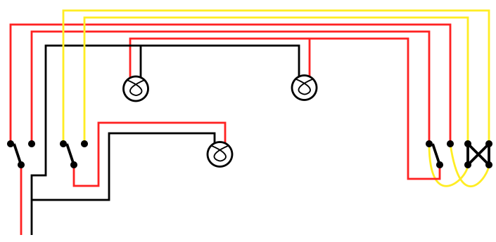

My other ideas all involve an intermediate (crossover) switch in the right box, as suggested by mikehammer69 in post #7 and drawn up by EFLImpudence in post #20. Here's my version of that circuit:
Of course as you've noticed that doesn't quite work; you can control both lights from both ends of the room, but the switch for the original lights at the left side now also toggles the new light.

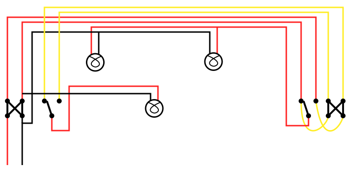

I have a couple of thoughts about how to fix that. Firstly, you could use a DPDT switch to "undo" the unwanted toggle from that switch:
The problem with that, of course, is that you can't buy DPDT switches to use in regular wall switch boxes; some nasty bodge would be required with an un-matching switch.

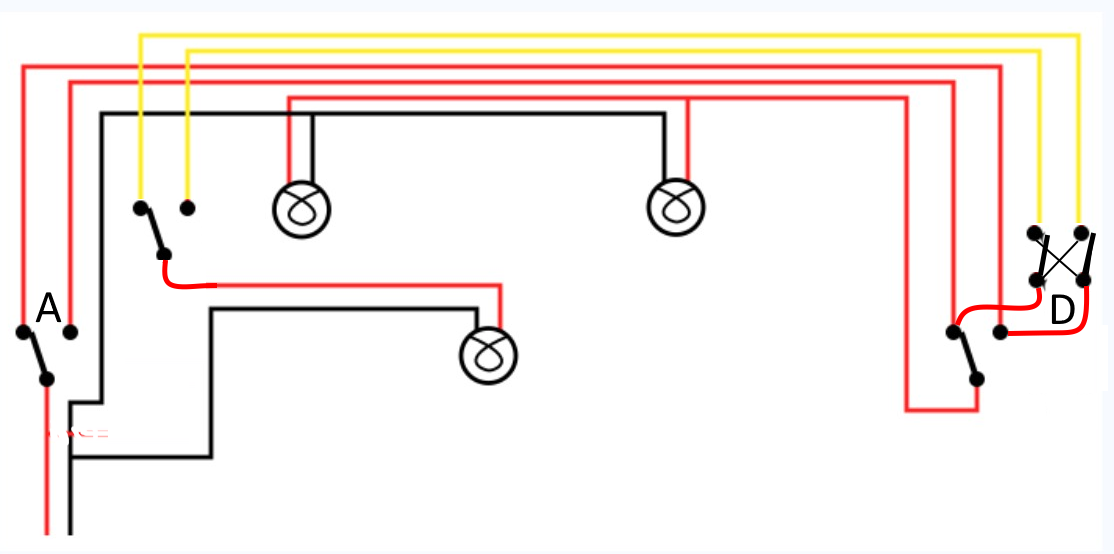

On the subject of nasty bodges... that leads to my final offering:
That works in the sense that all the switches do what you want, and it only uses readily available components. The problem is... well, I hope you can spot it!
