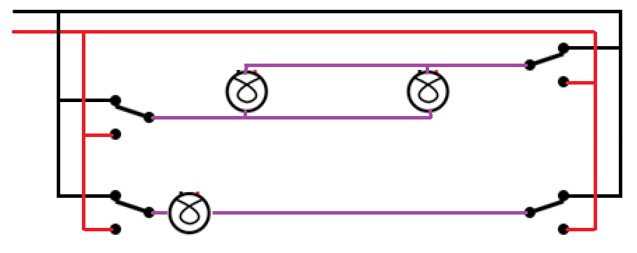

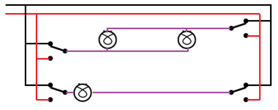

Right I managed to print out, checked it and hey presto , like I thought can`t be done without adding wire from LH SW l to Extreme LH switch.
If that was already in place it would be a doddle.
Terminals wired differently and linkwires placed in where required I think are allowed under the OP.
And no Wifi/Bluetooth or relays/Smart switches .
So my answer is NO,
sorry.

The example shown by Sunray where the L & N change places and allow for the lampholder to terminals to change polarity could possibly be utilised but to make things a bit "safer" at the lampholder itself it could be fed by a bridge rectifier (or simply 4 diodes) placed in such as a rose or a junction box (Well a ceiling rose is merely a junction box of sorts but just prettier than a standard junction box).
I am not sure if it is deemed allowed by the OP though from his first post? (and any objections by others) and it will mean ignoring an additional volt drop of around 1.4V.
