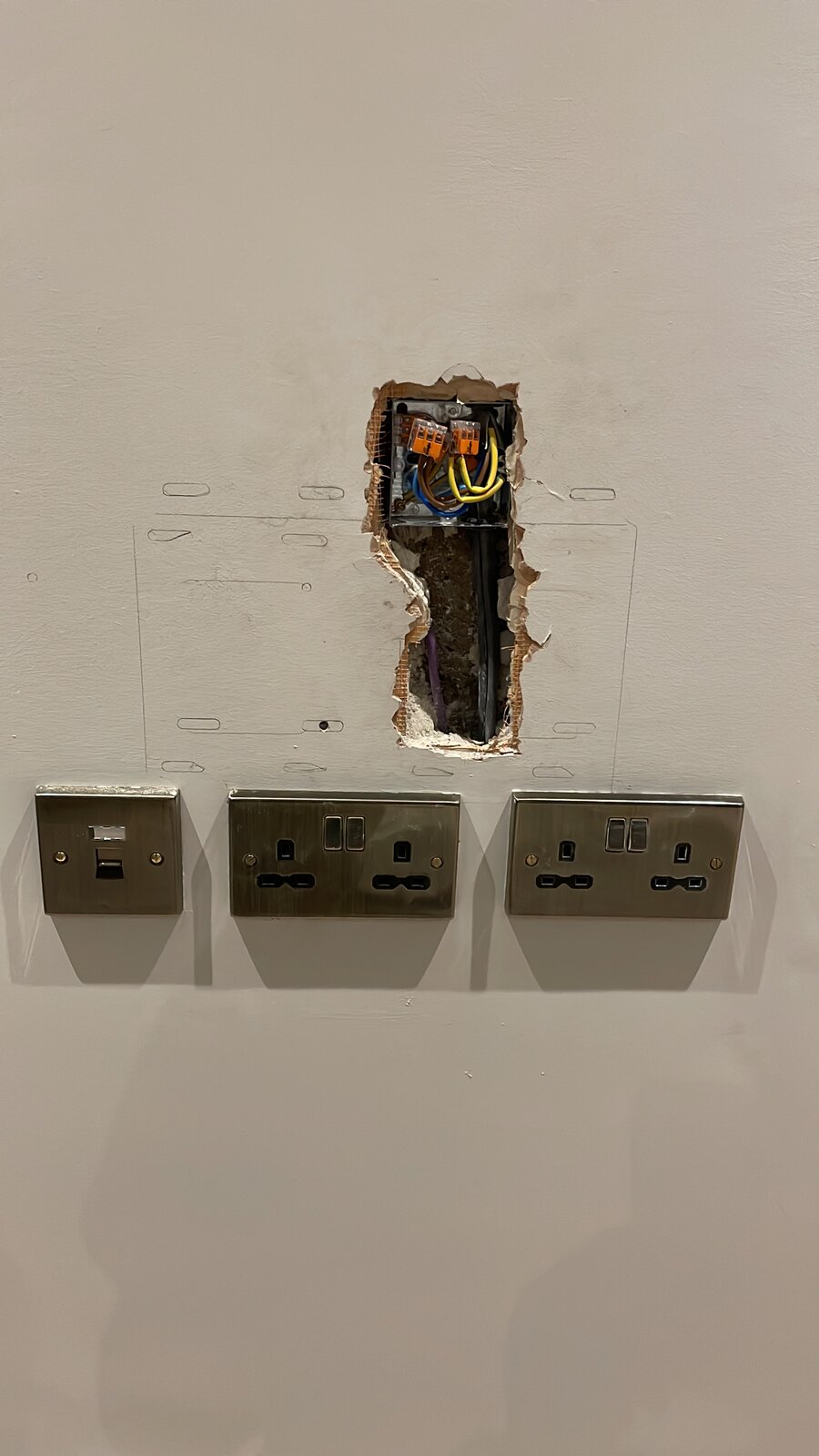

My sister called me yesterday to say she'd tripped power in her new extension after trying to install a TV bracket she'd drilled through a cable. Oooopsie. They had a full re-wire and consumer unit done 3-6 months ago when they had a side return and loft conversion done. Easy repair I thought.
Anyway went over and they'd hit the ring in two places up the wall. They'd drilled above sockets so I explained safe zones albeit in her defence the cable is run in the gap between the sockets, also directly alongside the Cat 6 cable, no capping, not brilliant but OK I said. Sunk in a 25mm single back box, 5 wagos and the back box lug for one side of the earth ring, new 2.5mm down to sockets, all fine. Safe zone issue solved with the blank plate, fine.

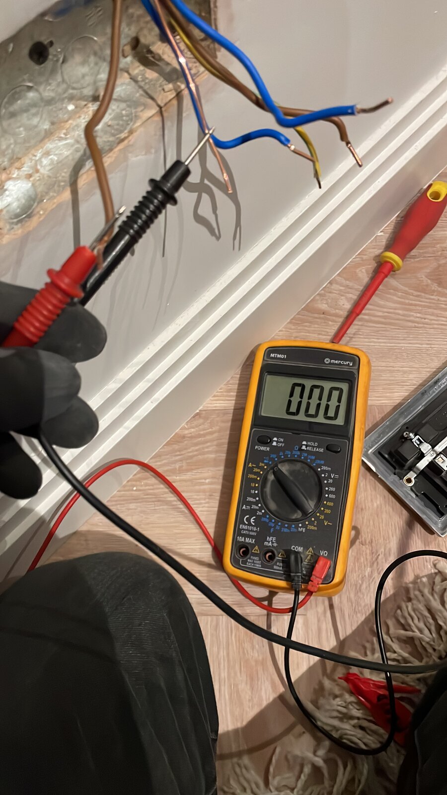

Tested continuity when I was done, live and neutral fine, earth no continuity.

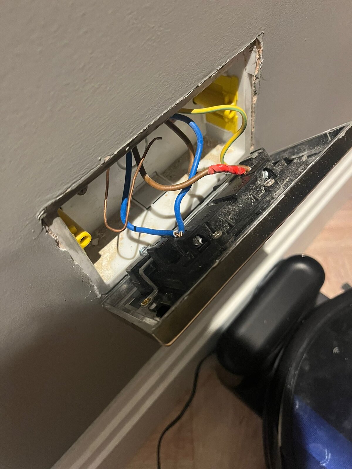

Started taking off other sockets on the ring, first one I looked in found only one earth connected, bit s**t I thought, whole socket looks shoddy but maybe a builder did this one.
Tested earth again, no contunity, started taking off more sockets.

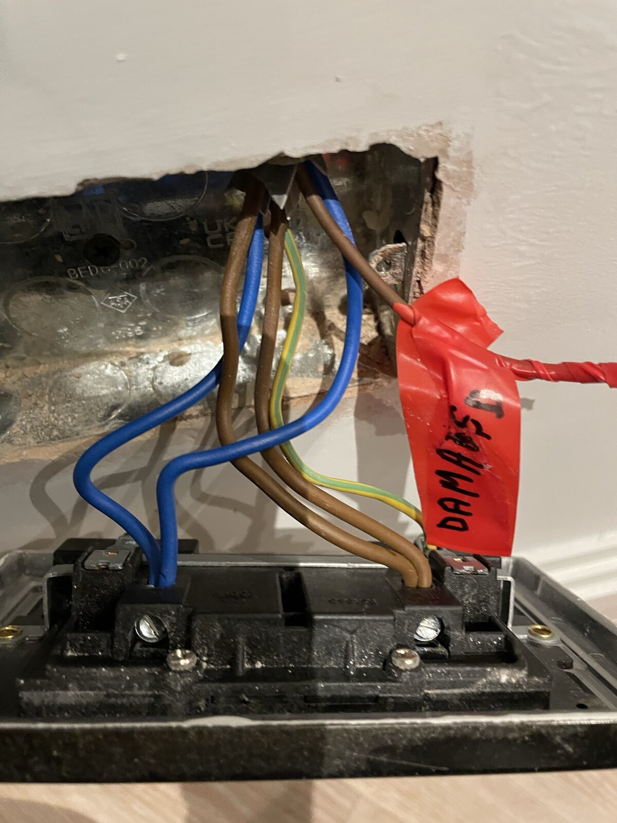

Could not believe what I found. Behind one, earth had been sleeved in brown, taped up, marked 'damaged'. Test it and directly connected to live. WTF. So we had a ring with no earth at all in places and one burried length of 2.5mm T&E with a live CPC.
I can only presume done to avoid ripping the cable back out of new plaster. I couldn't find the next leg on the ring also with a live or disconnected CPC so I've left the circuit off and said you need a sparky in to fault find and re-do at the main contractors expense (some funds haven't been settled yet due to snagging).

Just to wrap this up, a new electrical contractor came today. He split the ring into 2x 20 amp radials, disconnecting the damaged section of the ring.
We found out that the cable was hit by the plumber who was fitting a vertical rad. In his defence there had been a socket put where the rad was to go and then covered and plastered over without removing the cable drop or leaving a blank plate. Can't find out who thought that disconnecting and brown sleaving a live cpc and leaving it on a 32amp breaker was ok. They've found other issues from the previous electrican's labourer's work also being dealt with now before a full EICR. To be clear we didn't know a labourer was being entrusted to do the electrican's work (by the electrican).
