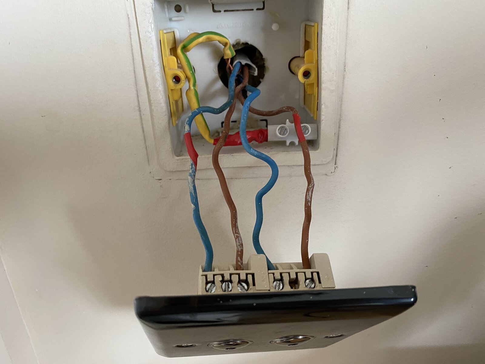

Ok I wired my old switch back up the right way and it’s all working.
this is how I have wired it:
Browns in X.
Blues in Live.
so it’s all working.
Now, the new switch has only one L terminal. What do I do?
You need to work out which is the live wire in each circuit and which is the load. Use your multi meter set on ac voltage , range 300V and touch the copper of each cable in turn (still in the switch with the lights turned off) with one probe and the earth with the other. Two of the cables should give a reading, the other two shouldn't. The two that do are the lives. The other two cables are the loads, make sure you keep them in the pairs they are wired in at present. You may find that the lives are different colours in each pair.

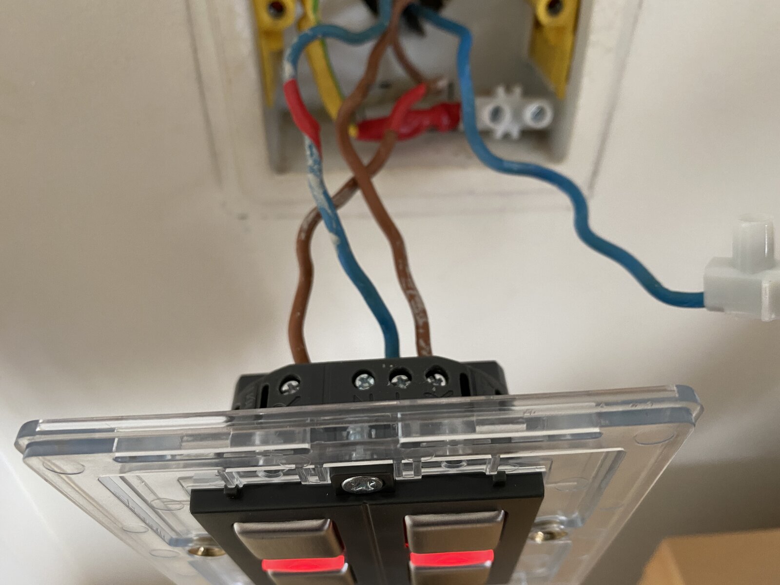

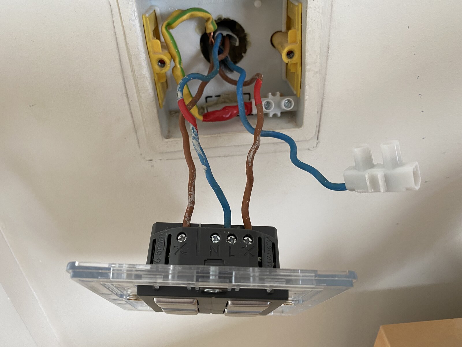

Now, I blocked one of the live blue wires and I plugged the other into the live terminal.
Then I put each of the brown wires into their X terminals.
That just put one set of lights on permanently and didn’t allow me to switch anything off.
so then, I swapped the brown wires around and now, although the display lights on the switch itself come on, only one set of lights works (right side).
what am I doing wrong?

One is first attempt and the other works but only one gang.

I have a new Lightwave smart switch and they all use a single L terminal, even for 3 gang.

Read my last post. You only need 1 live in the L terminal, doesn't matter which. Make the spare one safe (bit of terminal block)
