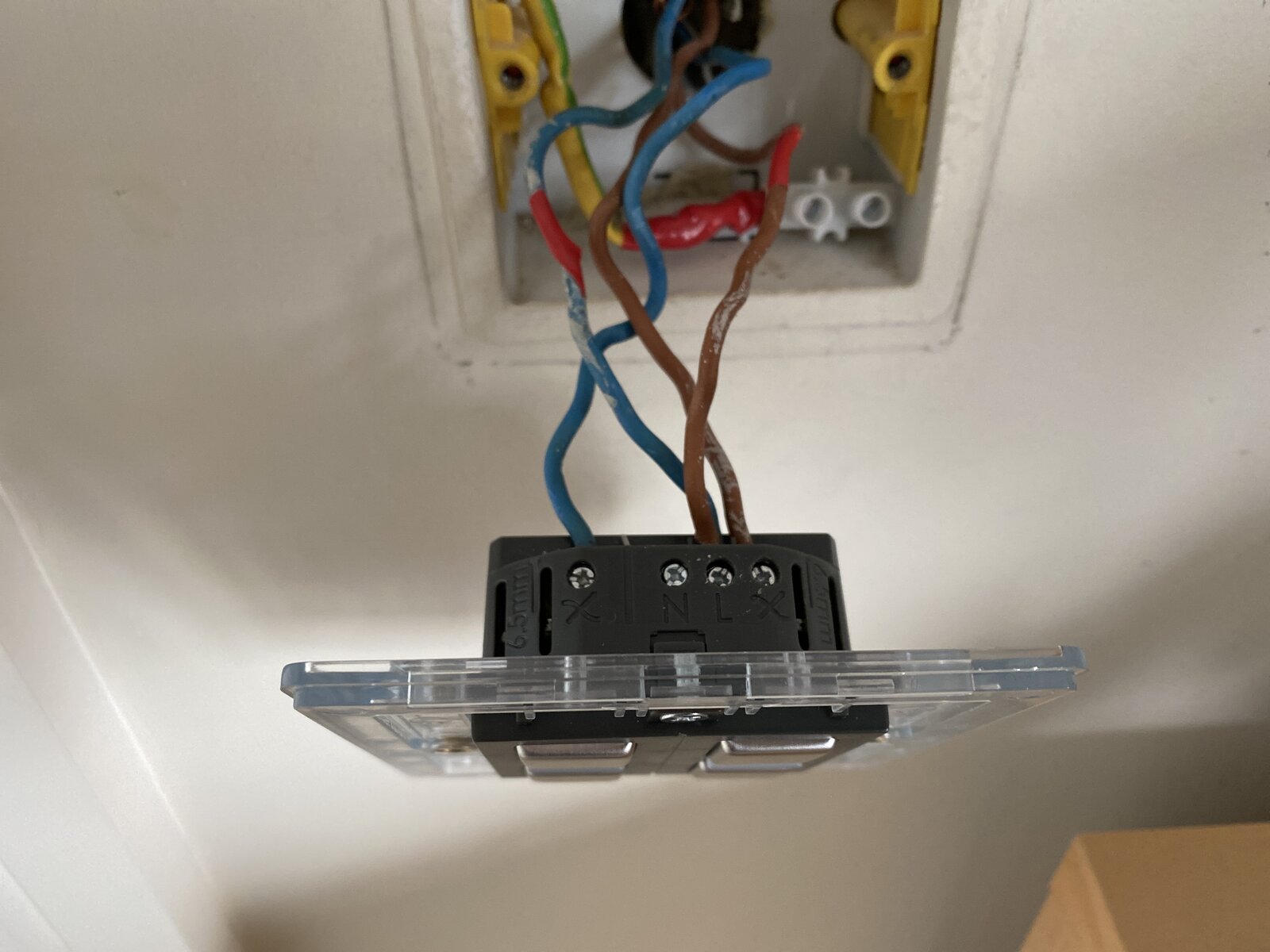

Disconnect that brown core (with the red tape on marking it as live) from the switch. Connect the blue core (currently in the terminal block) into the terminal on the switch where the taped brown was. Make the taped brown core safe
I did what you said and now, the side that wasn’t working is permanently on.
I can’t switch that off. The other side works normally.

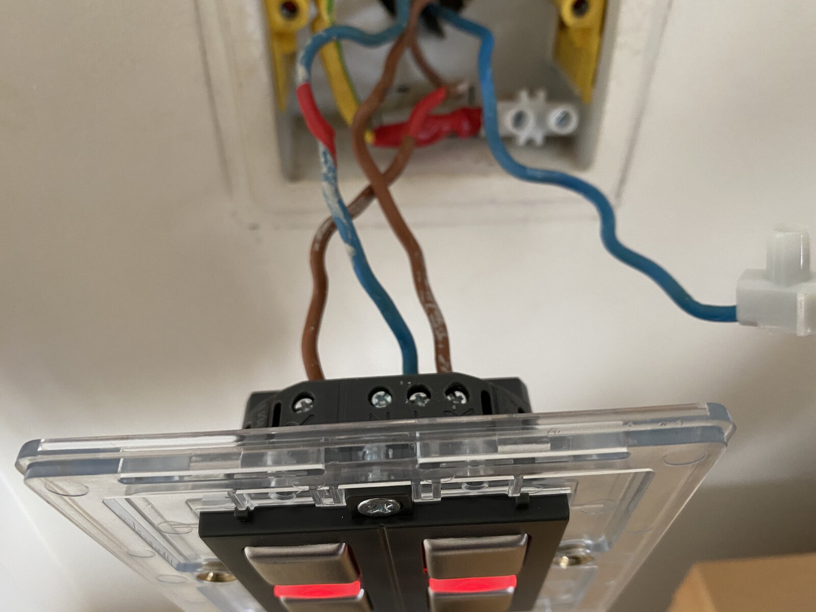

You haven't followed the advice . It's simple. You have two permanent lives with red tape. They only go to the L terminal and the ones with no tape ,go one to each output terminal
That blue core with red on it is into L isn't it? If so then swap the non-taped cores over, see if the fault moves (won't be a big surprise if you've trashed half the switch with your random cable swappings)
OK
Try again. Unless someone has mixed up yopur wiring in a BIG way, the browns should be the permanent live,m not the blues.
That is probably where you are leading yourself down a rabbit hole.
You can first prove this. Use your mains tester aand check between the earth connection block and each of the browns. They should both show 230V.
If so, those are the lives. They go in the L terminal, not the blues.
The blues are - should be - your switched lives. They go in the two output terminals.

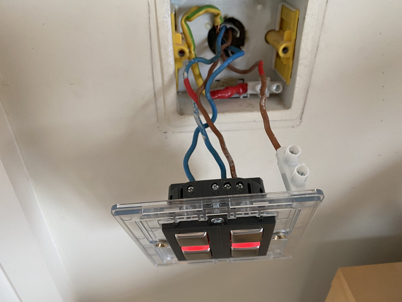

You want me to put the live blue and live brown both in one terminal?
You need to be certain which of the 4 conductors are the two permanent lives ,as Taylor said above. Once you have that established put both permanent lives into " L". You can use only one ,and have the other in a seperate loose terminal block ,but that's a bit pointless when you have a terminal on the switch !
You are sure that both are on the same circuit ?
Now I have put both live wires in the L terminal and it’s still only working one side, which is permanently on.
See image.

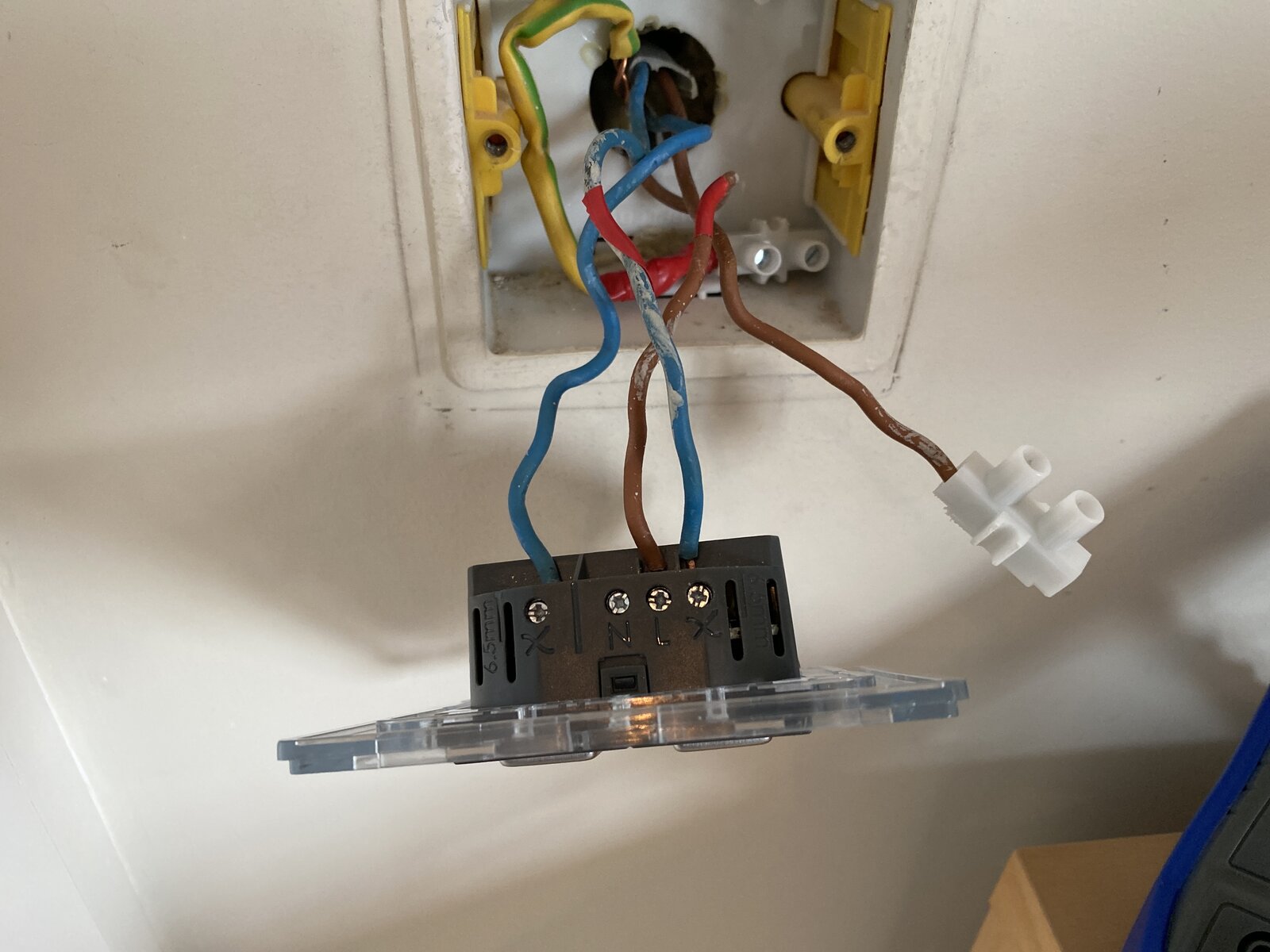

inhave now swapped the blue with the browns and still one side remains on.
See image.
Ok, my best advice at this stage is for you to put the old switch back on and working then get either an electrician or someone who can follow basic instructions to fit the thing. I'm out.
