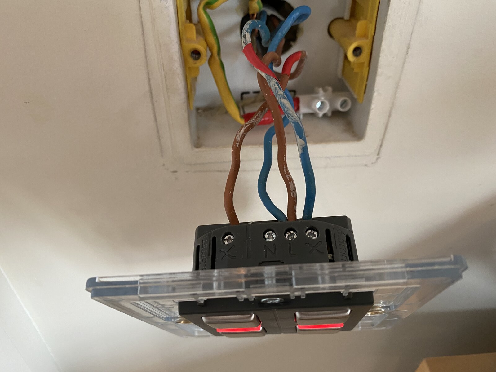

My last thought is that, this particular switch may need a neutral, although you have others working without it.
I too am out from further comment. But will watch with interest.
Ok this wiring with both lives in the X terminal and the non lives in the Live terminals has put all the lights on, but when I switch them off, they just dim down and don’t shut off.
Seems like dim is the new off for the tests I’ve been doing.

You either have a faulty switch ( possibly damaged by yourself), or it requires a neutral, or you have not established which are the permanent lives correctly when you measured voltages present. When you measured voltages ,were the conductors connected to the switch ?
I’ve put the old switch back on for now and will start working on another 2-way switch.

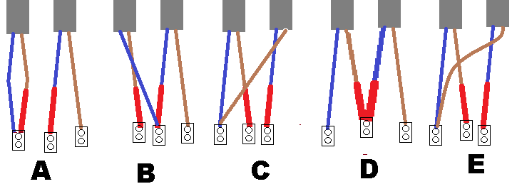

As I understand it you have these cables [ignoring earth] and have confirmed, by testing, that both lights are on the same MCB or fuse:
So what I'd like you to do is turn the power off, remove the switch and make the wires safe, ideally in a 4 way choc bloc in a way that the wires do not get confused or mixed up and cannot short to anything.
After finding a sensible way to identify the lights such as 1&2 or bed & bath etc, I have 5 tests for you to do by linking wires together ONE AT A TIME! in a safe way and do not confuse us with any other combinations not listed.
and fill in which lights come on in these blue boxes:
A=[ ] B=[ ] C=[ ] D=[ ] E=[ ]
Simplest way is to click on quote and fill the boxes and send, no other comments required at this time
I am expecting to see 2 or 3 boxes filled in.
For example:
A=[ 2 ] B=[ 1 ] C=[ ] D=[ ] E=[ ] or
A=[ bed ] B=[ ] C=[ bed ] D=[ bath ] E=[ ]
Please make sure you turn the power off before making changes.
If the test results are different to my prediction [not made public] then I will also be out like the others.

All I need you to do is make the wires safe so they can't touch anything and you don't have any confusion which is which and then to link them together in the sequence shown in my sketch.
Then to fill in the blue boxes in my list so I know positively which of the 2 lights comes on in the various combinations of A to E, where are the 2 lights & do they have an obvious title? I just want to know what comes on and when.
All I'm trying to do is identify wires as so far your posts have confused me and the others.

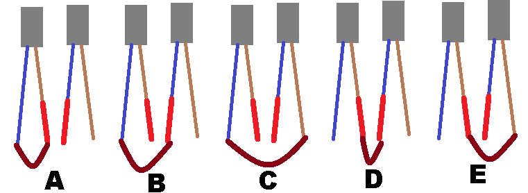

There you go, how to do the tests with 3 single connectors
After I connect them like this, I should simply check which ones show a reading on the multimeter?

this bit was just an example and you will not need your meter to see which light comes on
If i connect them all into connector blocks, how can any light be connected? How can any light come on?
