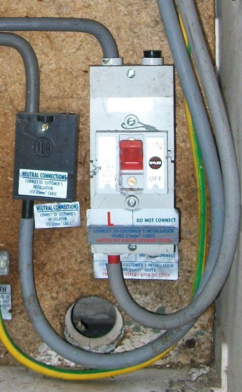

Second, for this service switch. The toggle is about 16-17mm wide and does have a hole in it.

Interesting wiring of that isolator switch. Obviously been sealed by the DNO (upper cover) but why provide a double pole switch & then only use one pole of it, providing a solid joint for the neutral.

Perhaps one of the experts can answer that one - it's the same for the flats next door as well, except that they also have a switch-fuse (DP switch) as well as (CU more than 2m from meter). Am I missing something when I think that having two switches at the meter is a bit overkill ?
Just for good measure, I always though water and electrics don't mix very well - and the idea of sticking electrical stuff outside in the weather for no good reason is a bit questionable. The box clearly isn't weatherproof :shock:

They don't appear to want you to isolate the Neutral
Which would make sense if the tails didn't go straight into a DP switch in the CU (or for the flats next door, into a DP switch feeding the submain to the CU) :?
The isolator at the meter was introduced to remove the need for electricians to break mater and cutout seals to work on the tails to and in the CU.
When they were in use it was common to install a new supply in a viewing cabinet before the wiring was complete, with the electrician connecting to the isolator when the wiring was complete.
Trouble was they are only a single screw terminal so often would come loose or not be tightened in the first place.
This led to a number of cases where the neutral was lost on a PME supply!
