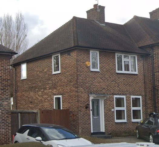

Hi,
We got a company to do a hip-to-gable loft conversion on our end of terrace house.
We have an option of 3 types of gable wall finish/construction
1. timber construction with render - not sure how this works typically. Is it a board that is attached to timber structure that the render is applied to? I will double check with the company but was wondering what is typical
2. timber construction with wall hung tiles (+£1600 + VAT)
3. brick construction I assume it's brick wall construction and finish (+£2800 + VAT)
My question is what are the pros and cons of each option and what do people think about it.
I attached the photo of the house.

I imagine the pros and cons beyond the cost are mostly visually, yes maybe one option suits insulation better or worse, or one option gives slightly more or less space, or slightly faster or slower, what do you actually want it to look like - what would you be happy with? maybe google or take a walk around and decide
For it to be permitted development, it must be brickwork.
Likewise for it to be no maintenence, and more attractive for the neighbours and future buyers.
Thanks for the answer.
I am happy with option 1 from visual point of view but wanted to know if there are any other considerations other than cost and visuals,
kike insulation, noise and how long each of these will last before any maintenance is needed.
That is interesting.
I can see neighbours have hung tiles on gable wall and received Certificate of Lawfulness from planning department of local council.
May I know which part of https://www.gov.uk/government/publi...nt-rights-for-householders-technical-guidance you refer to? I can only find this paragraph:
"A.3 (a) the materials used in any exterior work (other than materials used in the construction of a conservatory) shall be of a similar appearance to those used in the construction of the exterior of the existing dwellinghouse"
Yes that's it, the walls are brick so the new wall has to "be of similar appearance".
Your house isn't rendered, so it would look pretty weird to have a rendered gable end...
Hung tile on timber frame or brick (unrendered) would be allowed under the permitted development rules from my understanding.

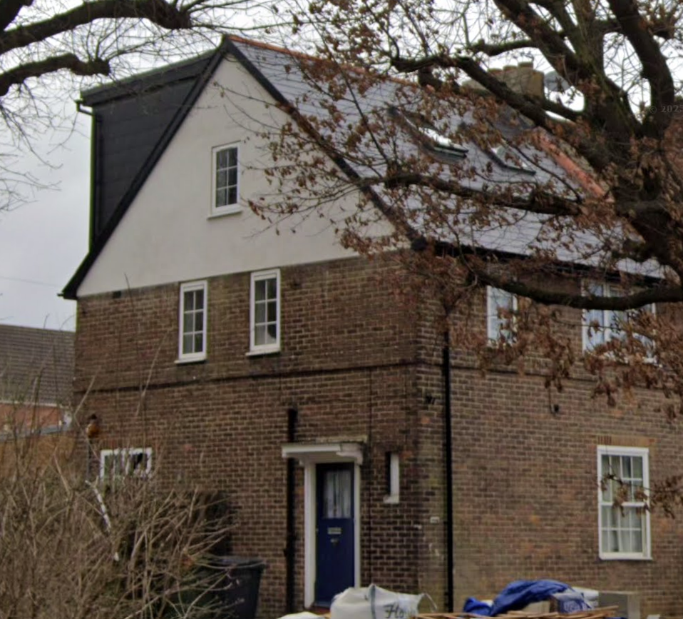

I found a brick house which had a render gable wall. This is how it would look like I guess.

Personally I'd go for the brick. One and done. No maintenance.
