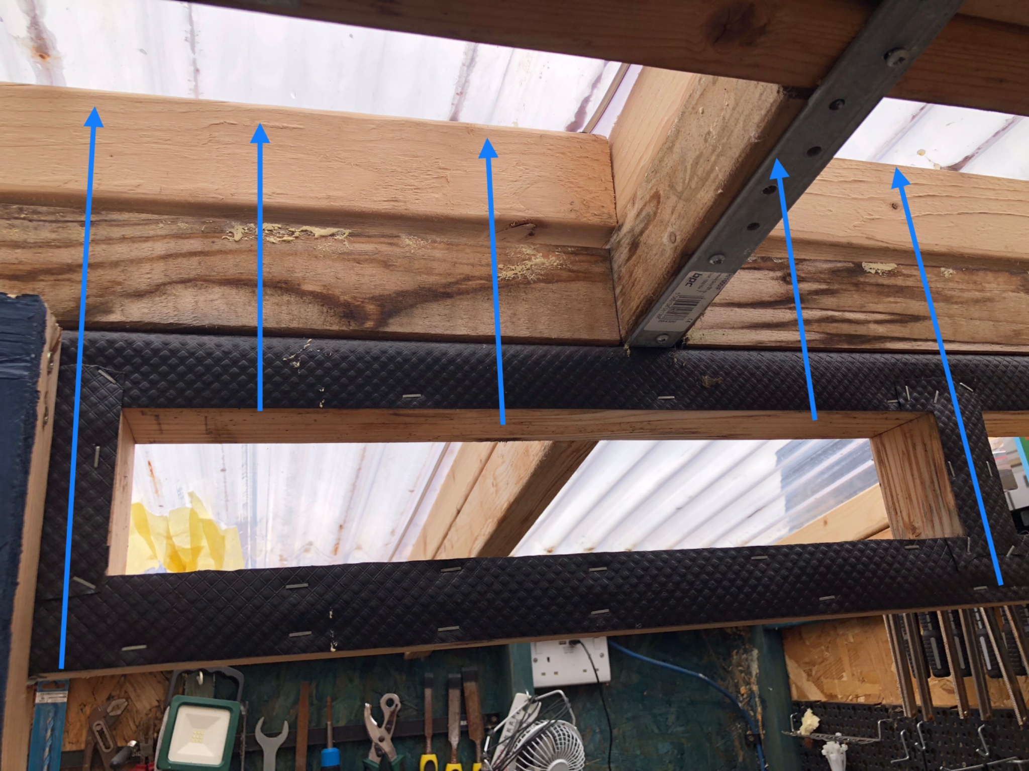

Lol… I am such a fool… not sure what my brain is doing most of the time, maybe pain/morphine maybe autism maybe a complete miss reading of the measurements… I need 350mm minimum length, maybe some sort of pocket hole job…

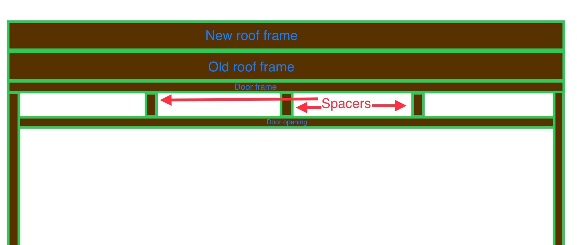

You see my tiny workshop started to leak, but that leak got worse and worse, as the water was getting in via the overlapping corrugated clear sheets, going upwards, I thought this would be fine. It means that I had to rebuild a new roof for the area, using the old sheets, I built a frame On the ground, then took the first row of sheets then the next row, adding rubber seals, rubber waterproofing tape, silicone and water resistant spray foam. With better guttering we put the new roof on top of the old roof frame, so now we have 2 3x2’s layered with the 3” side facing upwards, with the door opening added which is 2” and then added 5 inch blocks with another 3x2 underneath that.
With all of this, I have the new roof frame, old roof frame, the door frame a spacer and another frame.
New roof frame 3”
Old roof frame 3”
Door frame 2”
“Door spacer” 5”
Door opening frame “2
Total being 15” of wood to be needed to be screwed down. As I can’t screw through the roofing sheets.
I am getting pictures in a few minutes, with a sketch showing what I mean, and why I designed it this way.

I can't really picture it, but can't you just screw some ply or similar to the side of the "stack" of timbers, connecting them together, then you just need to fix the bottom one to the wall?

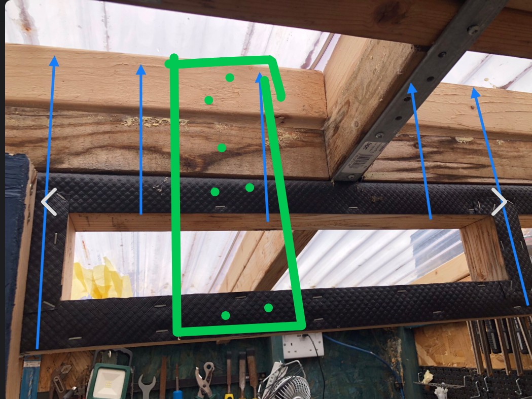

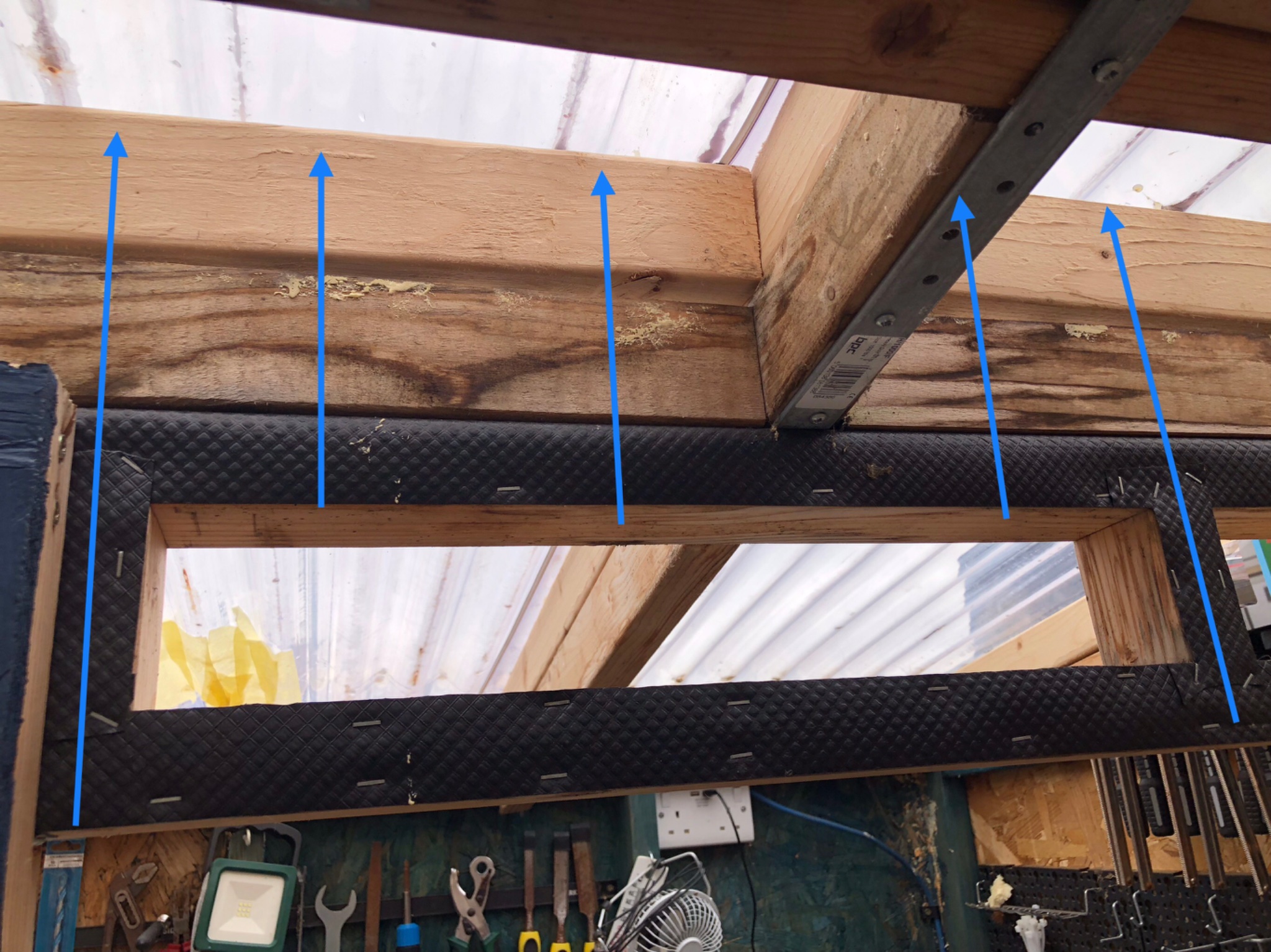

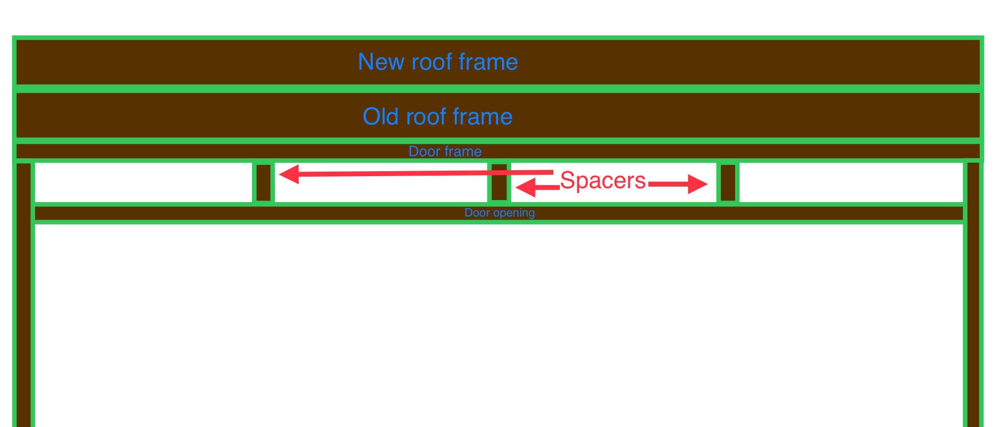

Picture of the work area and a quick drawing explaining it, I hope this makes sense.
Pictures look from outside in, the blue arrows are where I want screws, not sure how to get the screws in the between the spacers into the roof, unless I drill a hole threw the door opening.
Why not use some perforated strip steel, like the piece shown in your photo, to strap the timbers together?
As I thought, screw some strips of wood to join it all together.
