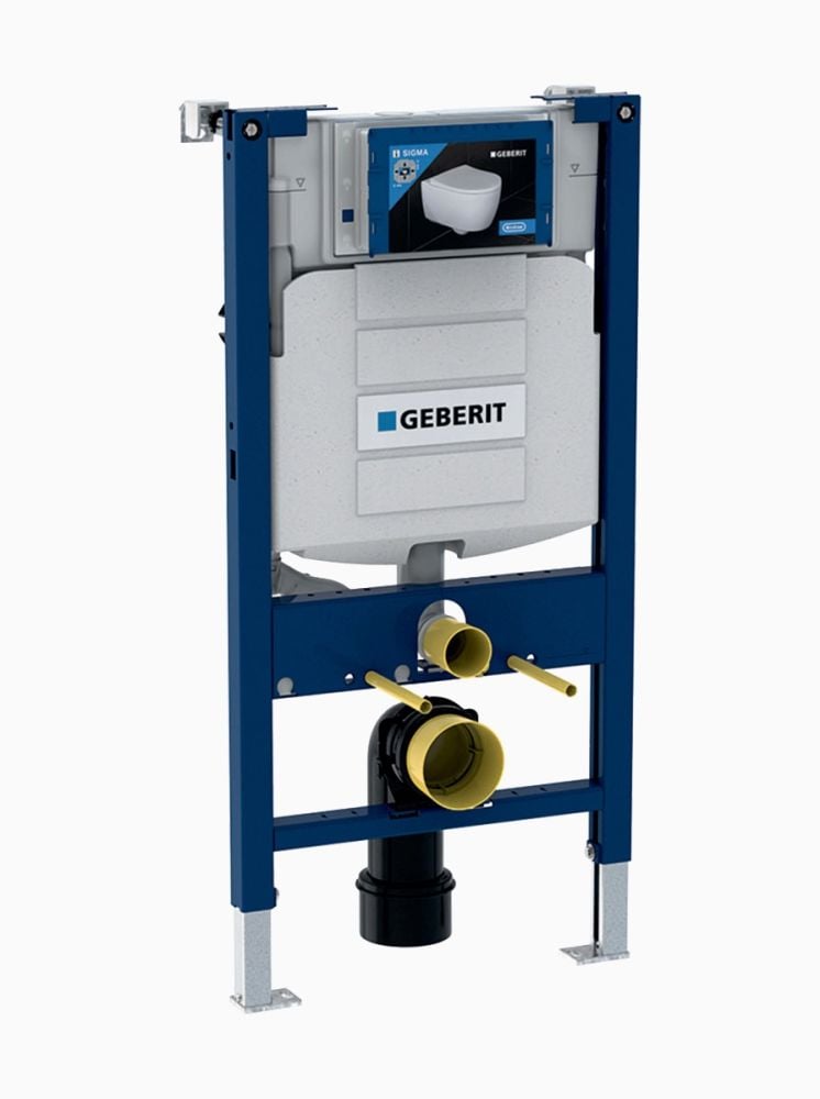

I’m installing a wall-hung toilet frame and need to build a boxed-out stud wall for it. The toilet will sit under a bathroom window, so the new stud wall will only be about 125 cm high and will stick out from the existing wall around 20–25 cm.
Because of the window, the studs can’t run all the way up to the ceiling. The base of the frame will be solid because it can be fixed directly into the floor joists, but I’m unsure about how to secure the top of the stud wall so it has no movement.
Right now the studs would come up from the floor but have nothing to tie into at the top. I was thinking of fixing a horizontal timber to the wall just under the window so the tops of the studs can screw up into it but I’m not sure how best to secure that timber to the wall or how to stop the whole thing from moving side-to-side.
What’s the best way to stabilise the top of a half-height stud wall like this? and what sort of size and type timber should I use for this please?

I think maybe there’s been some confusion and maybe I have explained properly apologies for that. I am not having the toilet to the stud wall. I have a gerberit sigma steel metal frame as pictured.
I’ve had these style system in my office for nearly 10 years and seems very robust. The serviceability through the flush plate has been quite good and hence the reason for installing at home.
to accommodate my soil pipe I basically need to space the frame from the wall hence needing to build a stud frame to the place the metal frame inside. So I need that’s what I was asking for advice on. Similar to this video:

It's wall-hung. Yes, the base of the frame is on the floor, but the seat cantilevers out from it. When a 100kg+ lump of human being sits on that thing, their entire weight, plus the ceramic unit, plus water etc will be pulling down, so trying to pull the top of the frame outwards from the wall.
Absolutely fine on a concrete block wall. Also, according to the video, on a floor-to-ceiling timber frame.
You'll need some really good joints between the timbers where the timbers meet to span under the window. Definitely not the usual couple of nails banged in, it needs structural metal brackets.
What's the original wall made from? You should add lots of brackets to brace the stud wall to the original. Overdo it, brace the heck out of it - you don't want any movement, especially not if you're tiling over the joint in the window reveal between the new and old walls - you'll get cracks if there's any flex when a human sits on it.

Build the wall. Anchor it back to the main wall with galv' straps or solid fixing/noggin arrangement. Sheath it with 18mm ply.

I will try and draw something up and post later on. The original wall that it is attaching to is in this order Dot & Dab > Block > Gap > Bricks
I'd suggest taking the original plasterboard off, chiselling off the dabs then bolting the framework directly to the block. Make up with plastic packers where necessary to ensure it's perfectly vertical and utterly solid. Only fix to the edges under the window, not in the middle where it will be prone to lifting/breaking away.
