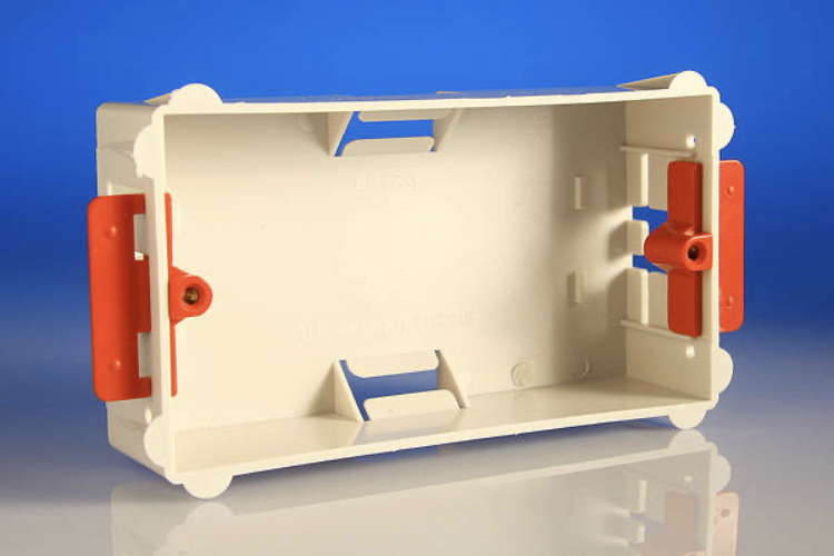

Get a dry liner box like this
the clip on the right will hold that side. The left hand side can be screwed through the box onto the wooden stud. You may need to trim the plastic wing on the left and a bit of the stud

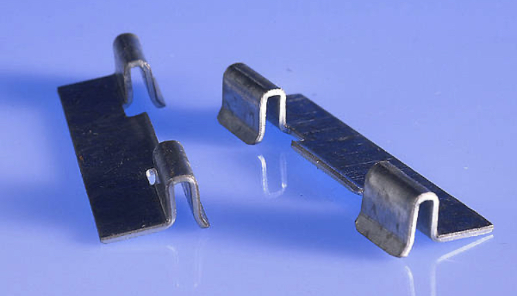

If you have a metal box, buy a PLASTERBOARD FLANGE to fix the right hand side (they are made to solve this problem!)
Get them in lots of places, like this
https://www.tlc-direct.co.uk/Products/AP603.html
View attachment 199027 PLASTERBOARD FLANGE to fix the right hand side (they are made to solve this problem!)
The flanges look good but there hard to source only found them on 2 sites
Try a local electrical wholesaler, but I see you are in Leicester, so maybe not so easy …?
