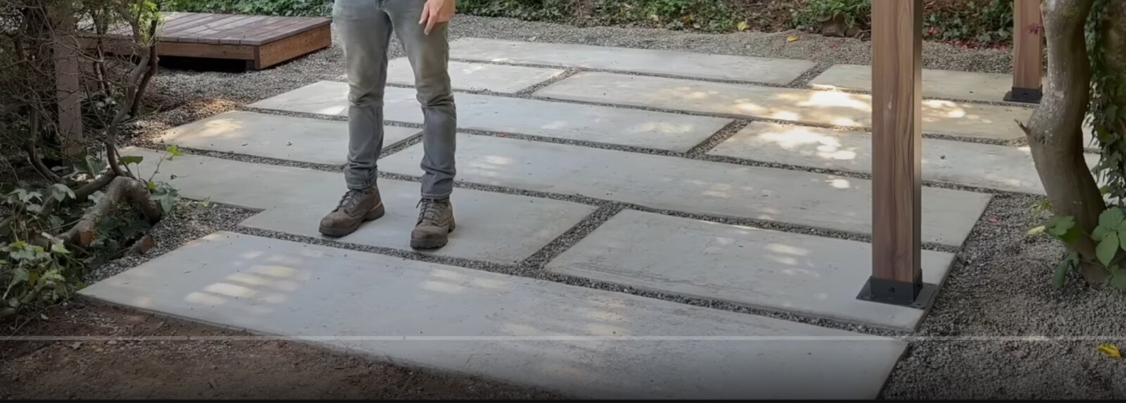

Thanks, another thought was to carve out slots to make the base look like individual concrete slabs and fill in the slots and around the thing with gravel like in the picture. Looks like it will take a hell of a lot of angle grinder discs to do it though!
