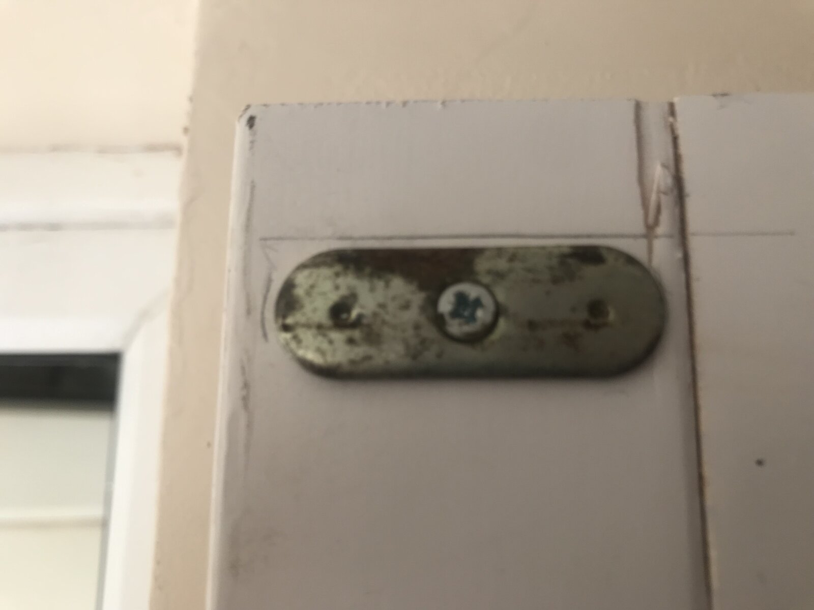

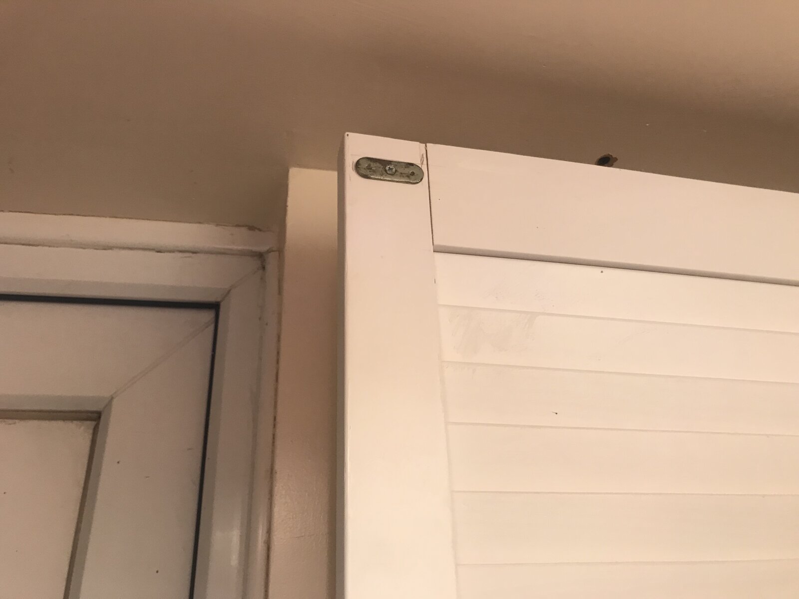

Hi
Was painting architrave around our cupboard doors, and noticed one of the two doors wasn’t connecting to the magnets in the frame above. (This was before I painted)
Do you know where I might replacements for the metal plate and magnets?

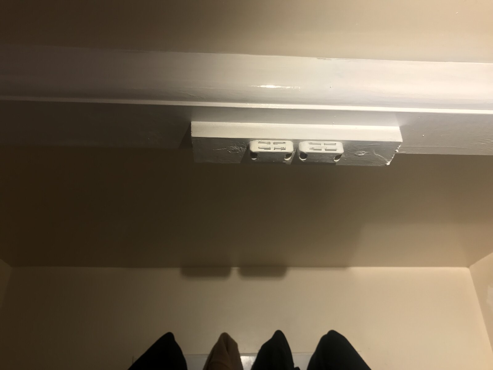

the magnets have a slot and may have been bashed backwards out off reach
if the door is twisted and not sitting dead square they dont work
modern magnetic catches dont seem to have the 2 or 3mm rock needed to work properly
do the two metal plates rock at all around a vertical axis ??

Both doors appear to be aligned properly, handles in line, same size gap between doors and frame. The left door also closes after being persuaded a few times.
Doesn’t look like plate rocks at all.
(Magnets still in slot)

Longshanks, have you actually determined if the doors are closing properly or not and allowing the magnet/plate to connect and if so is the plate still sticking to the magnet? If you unscrew a plate does it snap onto the magnet or not?
Is it that the doors are no longer closing properly and the magnets no longer have enough power to hold the doors shut?
If the magnets have merely lost their magnetism then simply replacing would seem the way to go.
its the magnetic catch that rocks
thr screw in the plate also has to be below the surface

Magnets improve with age, simply out of alignment or binding hinge causing tension.Should be at least two on each door.
