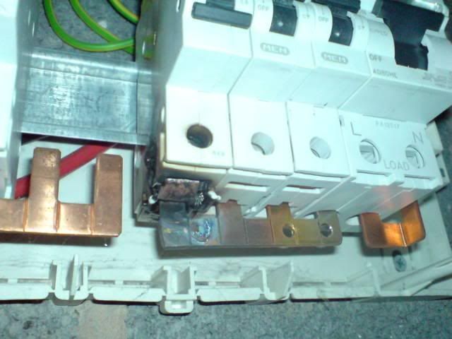

attach the MCB securely to the busbar...
had he forgotten to wind the screw to the "fullly open" positon before putting it onto the busbar?
Busbar is also back-to-front.
The end with the holes is intended to be at the 'low load' end.
I would hazard that the busbar was the wrong side of the 'vice type' terminal.
Shower is on the RCD side.
Good old MEM Memshield 2000.
I have seen busbars mounted on plastic pillars in some makes of CU - GE spring to mind.
