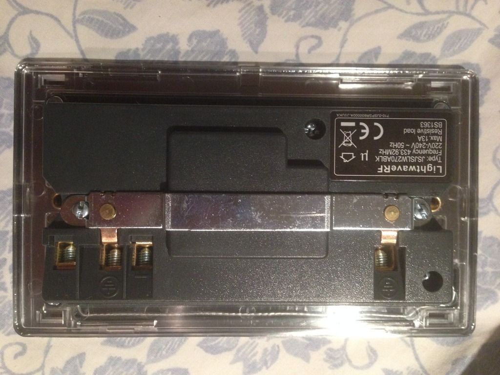

Look out for "the Internet of Things". It's coming...If you are controlling a 3 kW appliance from a remote location from where you cannot see the appliance how can you be sure it is safe to turn on the appliance ?
You seem to be saying much the same as winston - or are you implying that there are "expensive ones" which are rated for 26A total??The cheap ones often are only rated for 20 A total.A double socket is generally rated at 20 amps split across both sockets which equates to 4800 watts.
Indeed - but, as I wrote, high-powered appliances coming on when no-one can see the appliance has been with us for some time. For example, many/most tumble dryers (probably one of the most fire-prone of domestic appliances, as well as the most energy-hungry) come with a built-in facility specifically there to enable the machine to switch itself on when no-one (or no-one awake) is available to 'supervise' the appliance!Look out for "the Internet of Things". It's coming...If you are controlling a 3 kW appliance from a remote location from where you cannot see the appliance how can you be sure it is safe to turn on the appliance ?
537.5.4.1 Motor control circuits shall be designed so as to prevent any motor from restarting automatically after a stoppage due to a fall in or loss of voltage, if such starting is liable to cause danger.
I know I have fitted active RCD's to items like bench grinders so loss of power will auto switch off motor,
If he's already able to hack [your remove-controlled socket] then your primary network has been compromised
