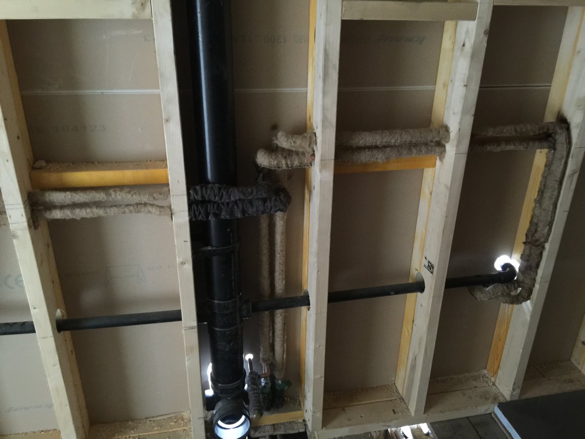

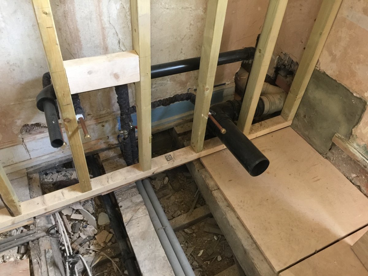

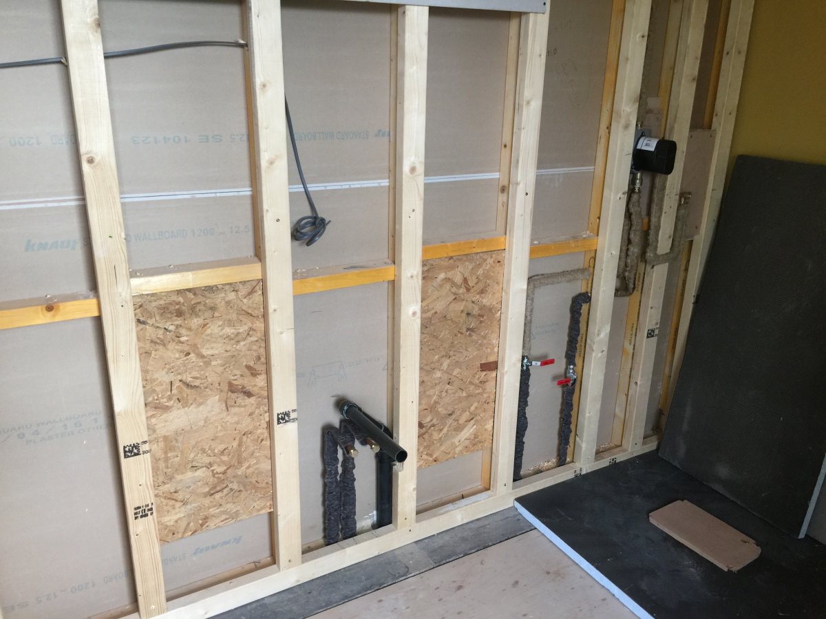

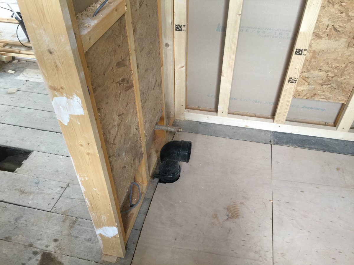

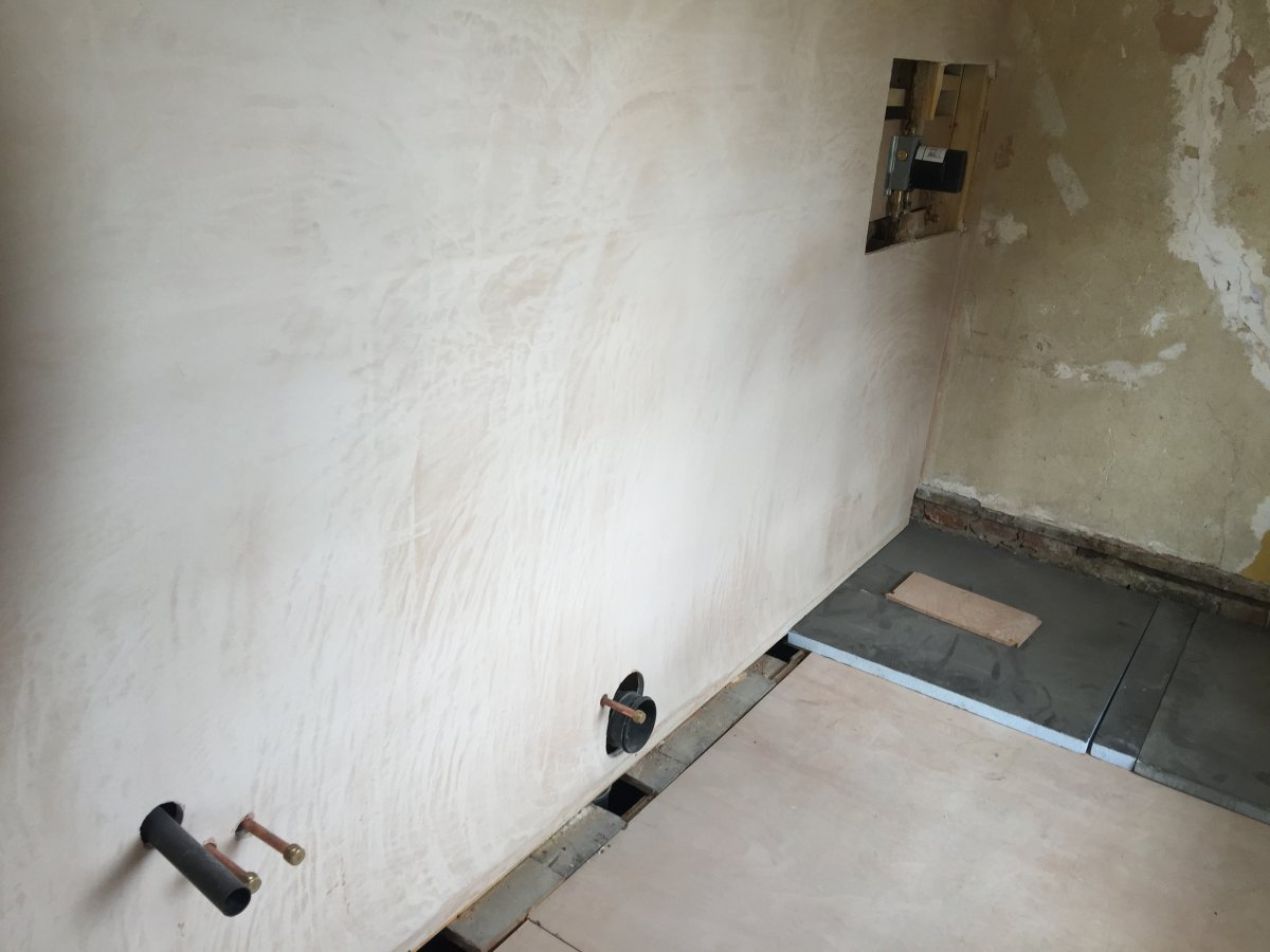

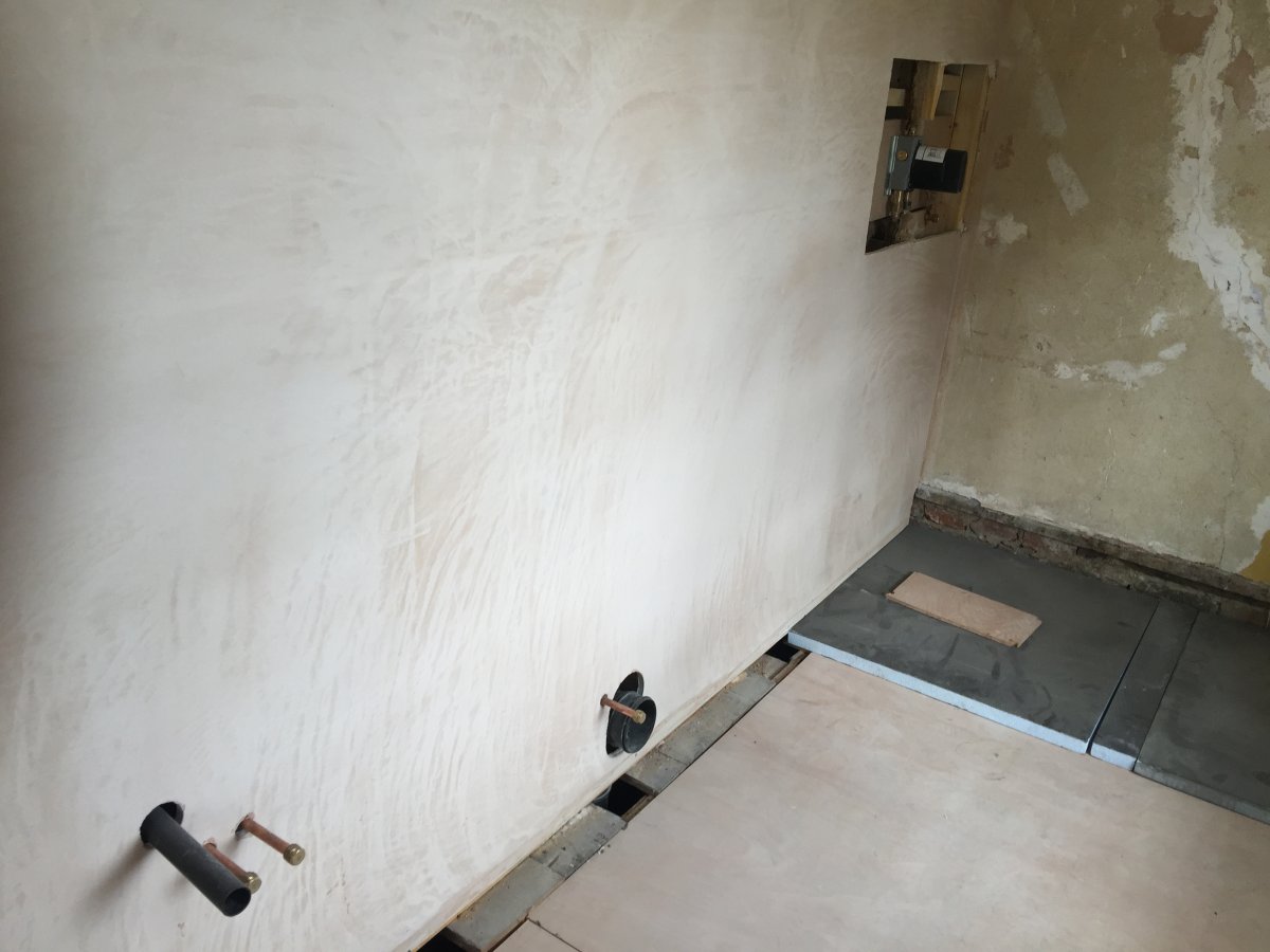

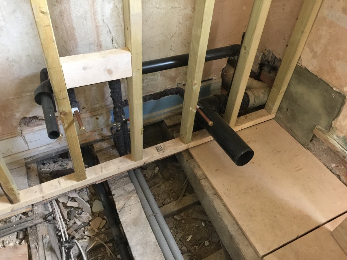

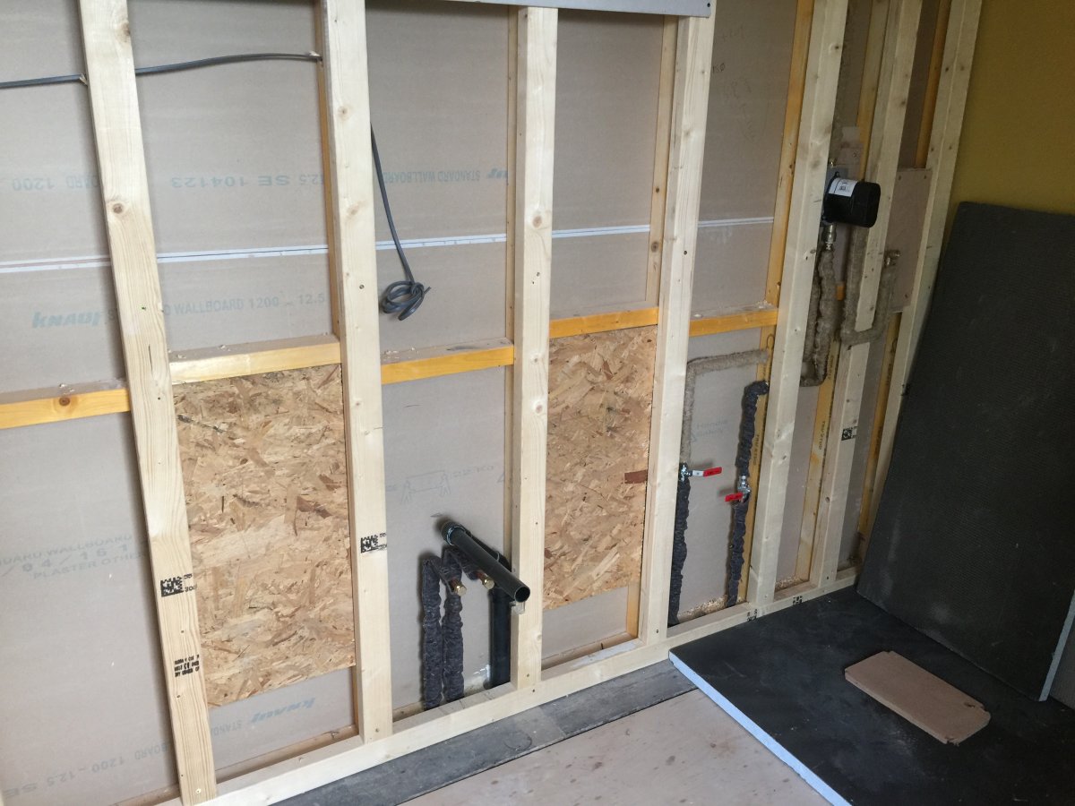

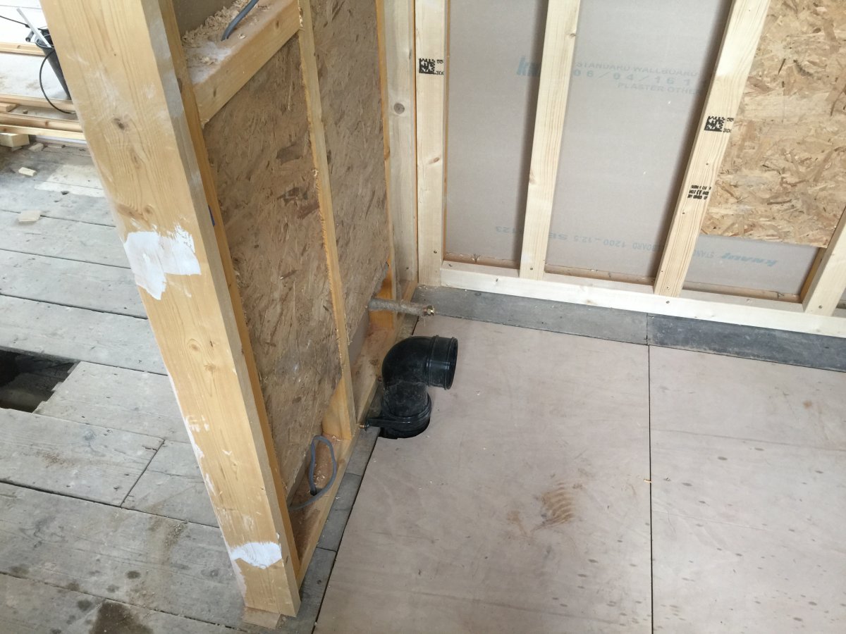

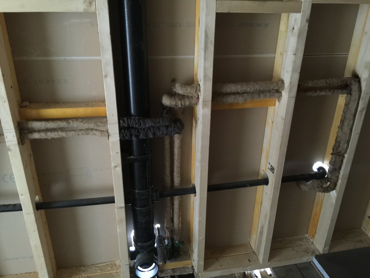

image.jpeg image.jpeg image.jpeg image.jpeg Fitting a shed load of back to wall pans at the moment .....not one of em uses a flexi....easy when you know how..:)

lol...of course, never use a flexi where you have a nice sturdy, clean, new and perfectly positioned soil pipe to push the pan with a rigid connector back onto (y)
