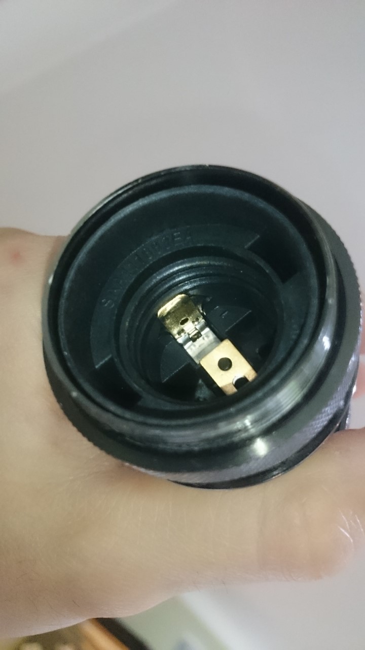

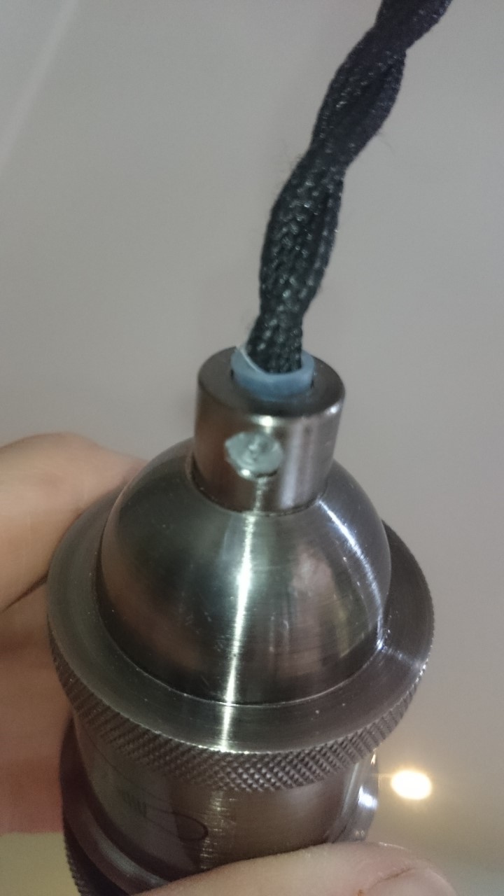

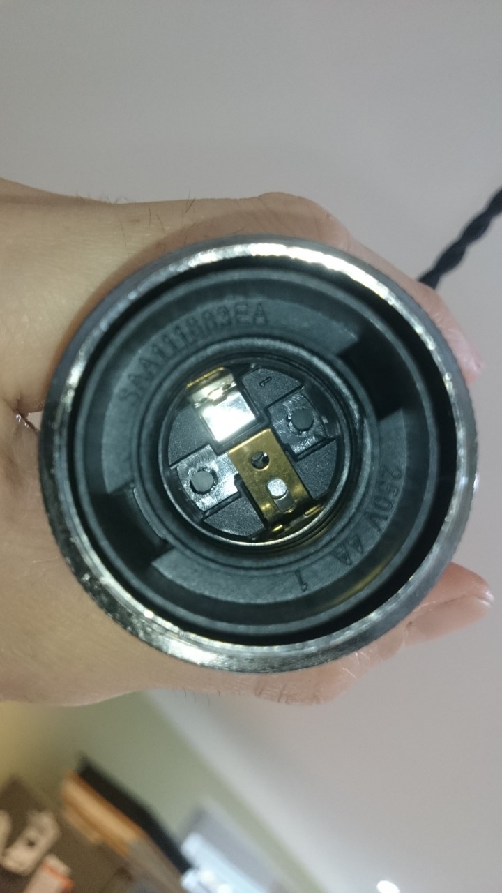

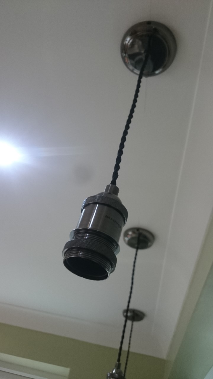

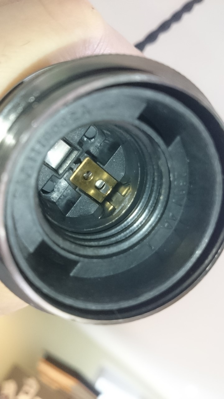

So, pendants from big UK DIY chain - they seem to sell a few of them and have done for at least a year or so (have had my eye on them).
Finally bought, fitted, tested earth continuity and…****…the metal lamp holders aren’t earthed. Obvious now I look again – I didn’t think to even look for earth continuity in the shop (or at any point while screwing them in…). The ceiling rose is earthed fine, but it’s just 2 cores in 2 black nylon overbraids from there to the lamp holder. It’s stated clearly as Class 1 on the box.
The construction of the lamp holder does seem robustly insulated and the L and N contacts sit in a neat moulded plastic insert that could quite conceivably be Class 2 should it be a standalone thing. I haven’t managed to easily take them apart to get a look internally, though.
So this seems weird, right? What would you more knowledgeable folk do when testing up a fitting that’s supposed to be from a reputable source but fails the tests it must pass according to the approvals it is sold with? Judgment of the installer?
i.e. can stores sell any old electrical crap and its down to the installer to ensure it is fit for purpose? (in this case, the logical conclusion is to take it apart and run an earth wire. Or more practically REFUND)
My most optimistic take is that the store do hold some liability risk should something go wrong with anything they sell, and are happy that a failure in the lamp holder is so vanishingly unlikely that it is fine to sell in its current state as a Class 1 device, which if it’s good enough for them and their lawyers, it’s good enough for me.
They could then also be assuming that 99% of their customers are DIY’ing it and not aware of the tests/regs anyway, so the 1% return rate they do get, from those that do the tests, is easily offset in the cost reduction of the design...
Any thoughts?
To be clear – this is DIY :)
Cheers

Are there any DI (box in a box) symbols on the unit/ label/ packaging/ instructions?

Looks like a standard Class II lampholder with some metal around it. I don't see any issue here.
The issue is there are only class 1 markings, so AFAIK all exposed metal parts have to be earthed - explicitly, which they are not.
Could it be that the 'rose' is class 1, and the lampholder class 2?
I think this is the most likely by the sounds of it, which would be perfectly safe of course, but no way of knowing

but can one really rely on the chain to take the earth to the lamp holder? I would say no, it needs a three core cable, but the cable goes into the bulb holder which is class II there is no provision to connect an earth with plastic bulb holders. With a brass bulb holder
yes there is a place for the earth so it can be class I but not seen any plastic bulb holders where you can fit an earth. From picture can't work out if that bulb holder is metal or plastic, but it is clearly for a screw in bulb, so I looked at web sites selling brass bulb holders for ES bulbs
Clearly no connection for an earth, picked this picture because one can see the parts, or so I thought, but on the advert is states "As this is a metal lampholder, ensure you use a 3 core mains flex to provide an earth connection to this lampholder." so that bit of metal at bottom of base must make connection to the shell. I note with the metal ceiling rose there is a plastic insert to use when not using hook so the outer of the flex when the flex takes the weight is not in contact with metal, if the lamp in question was class II I would expect to see a similar bit of plastic so flex can't touch the metal, but that does not seem to be there. And what seems like a plastic screw is forcing the flex against side of hole so it could with rubber in material insulated flex damage the flex at that point causing contact with live parts. Although we tend to not touch lamps, with plug in lamps they can be handled much more, the ceiling lamp over my dinning table is far too low if table removed so if we put table away we also plug in a shorter lamp, so it is likely handled more than the water boiler.

As most of us have said, it does seem that the most likely explanation is that the lampholder is Class II, whereas the rose is Class I.
This begs two questions - firstly, in such a 'mixed' (Class I + Class II) situation, what would we expect to be written on the box? In at least some senses, "Class I" would seem to be the 'safer' option?
Secondly, as already mentioned and discussed, is it actually compulsory that a Class II 'component' (i.e. the lampholder) must bear a Class II symbol/marking? - and I don't know the answer to that one. I had always assumed that if a product had exposed-conductive-parts and was not marked as being Class II, then it had to be regarded as Class I, and hence those exposed-c-ps earthed. However, as has been pointed out, such marking might be impractical in some cases (but not, I would have thought, for a lampholder) - so it will be interesting to see if anyone can come up with any 'chapter and verse' as regards what the relevant Standard says about this.
