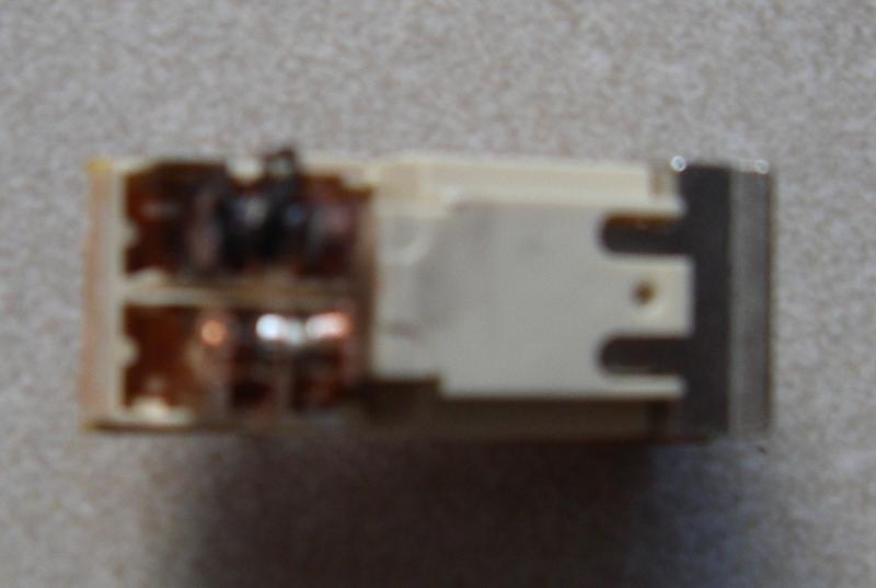

I cut away 6K1's plastic housing sufficiently to get a view of the epicentre of the fault :)
http://i220.photobucket.com/albums/dd257/harrykiri/EL200D6K1RelayContacts04.jpg
http://i220.photobucket.com/albums/dd257/harrykiri/EL200D6K1RelayContacts02.jpg
What a mess!
I suspect that many EL200D faults will be attributable to the failure of this relay. I will give some thought to how to reduce arcing across these contacts when I get more time.
Given this relay was the cause of failure of two machines at least, in this thread, 6K1 and the "micro fuse" should be the first two items to be suspected in EL200D board failures in any Miele washing machine variant. Not forgetting brushes can cause similar symptoms.

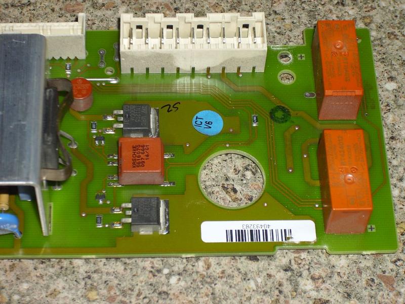

I also was able to test the relay (6K1 from the schematic).
To do this, first find the relay (see photos below)
6K1 is on bottom right of this picture.

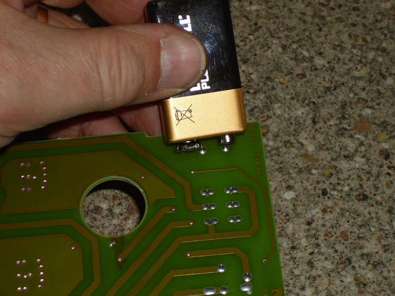

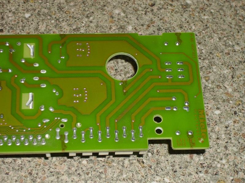

Then turn the board over
And apply a PP3 battery to the coil terminals as shown here
If the relay is OK, it will click-click as you touch the terminals. However note that to fully test the relay you should use a meter between the contacts to make sure the contacts switch over cleanly when you connect the battery. I found when doing this that one contact had welded itself shut and the other was free to move. The result was that the relay was actually shorting out the mains when energised and therefore blowing the fuse in the process. Now, having replaced the fuse and the relay, we have a working machine again. Costs for parts were less than £10.
