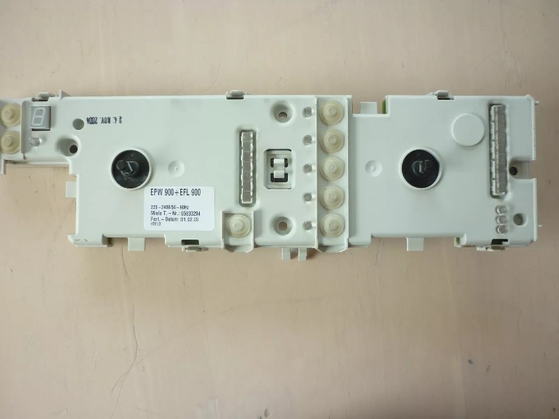

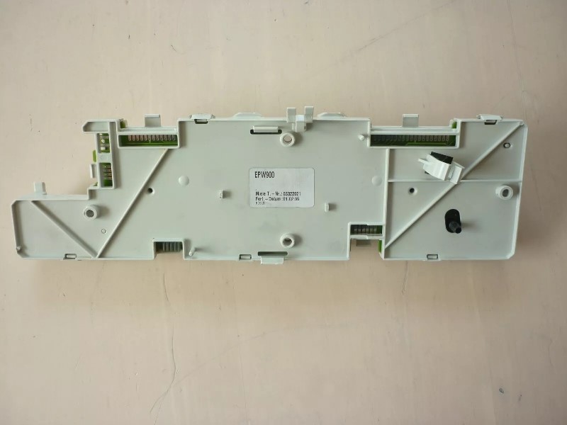

Is this PCB - EPW 900 - which I would possibly need to change? it looks complete, no requiring any soldering or such.. just putting in some plugs/connectors
forgot to mention that it works fine when spinning.. in spin mode, just pump starts when it has finished spinning and keeps going/pumping
Miele are a closed shop, repair info is not available and neither are the parts. If you want a repair then you contact Miele and pay them.Has anyone removed the pcb board on a miele before?
