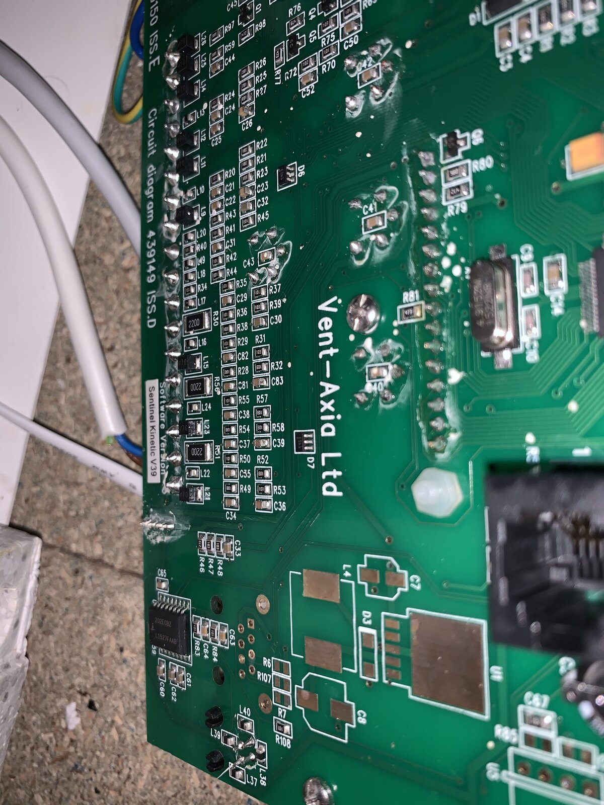

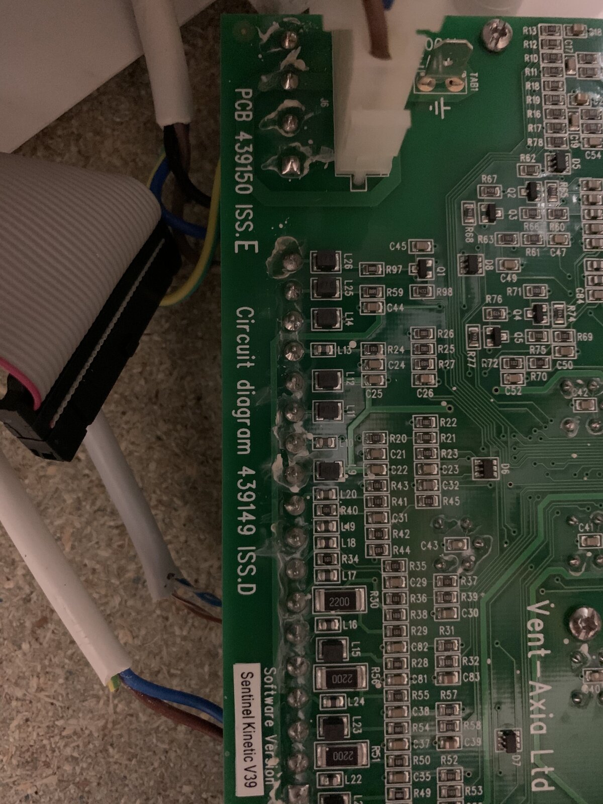

    I've poked around the unit a little more.... Im reasonably confident with electronics, however have never needed to clean up a circuit board, does this one look salvageable with a reasonable amount of work? I am now thinking it never got 'wet' but water was below it, and condensation left it on the board.

    The back of the board looks water stained.
    Someone has cut the earth conductors from those flexes.

    Best course of action from here...? :)

    As already advised - just give it a good wash down to get that water staining off, finally a good rinse, a good dry off, then decide whether to spray it with WD40 to stop any corrosion.
    I'm seeing some water damage on the top side of the PCB as well, when I zoom in.

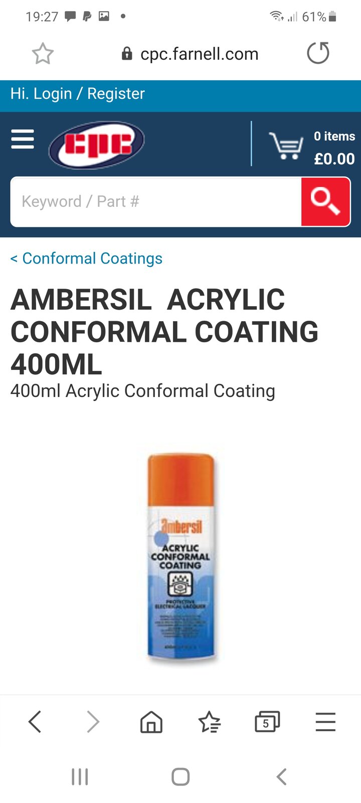

    You can spray it with conformal coating after cleaning and drying to waterproof it.
