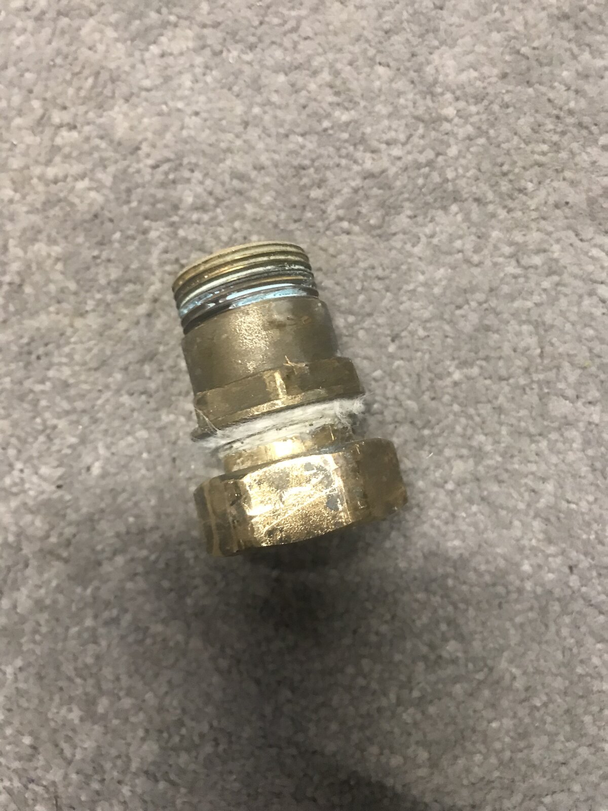

Minidue is leaking
Here are pics of the fittings in question

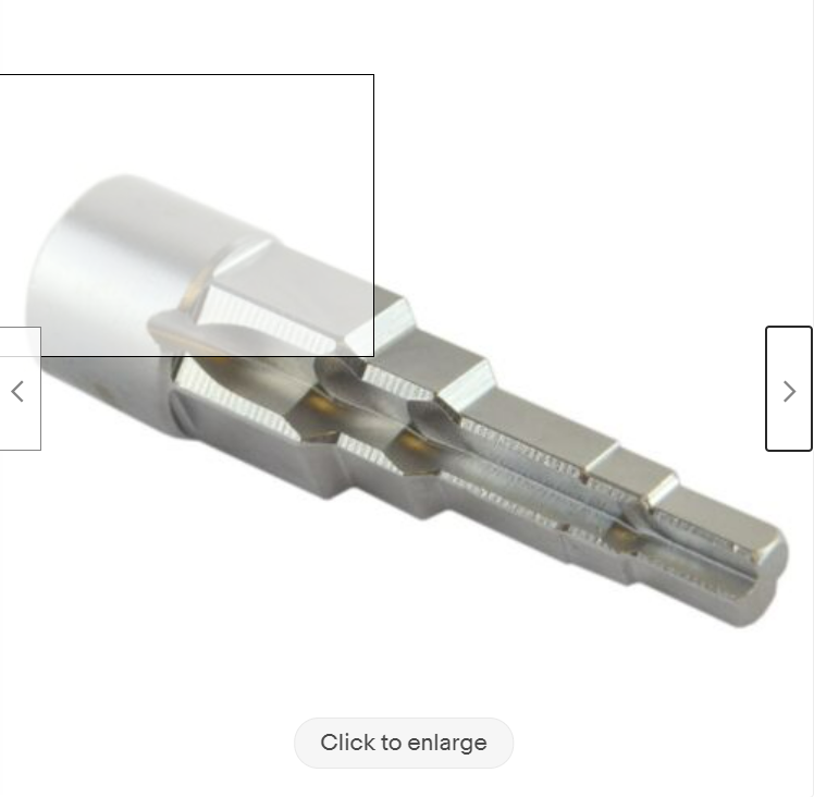

Whoa there Harry...the issue is how to hold the flat faced union whilst you remake the threaded connection.
Google image "spud key" and you'll see various keys with slots down the sides.
do I need to buy a ratchet for this method or can it be done with two adjustables that I currently own?

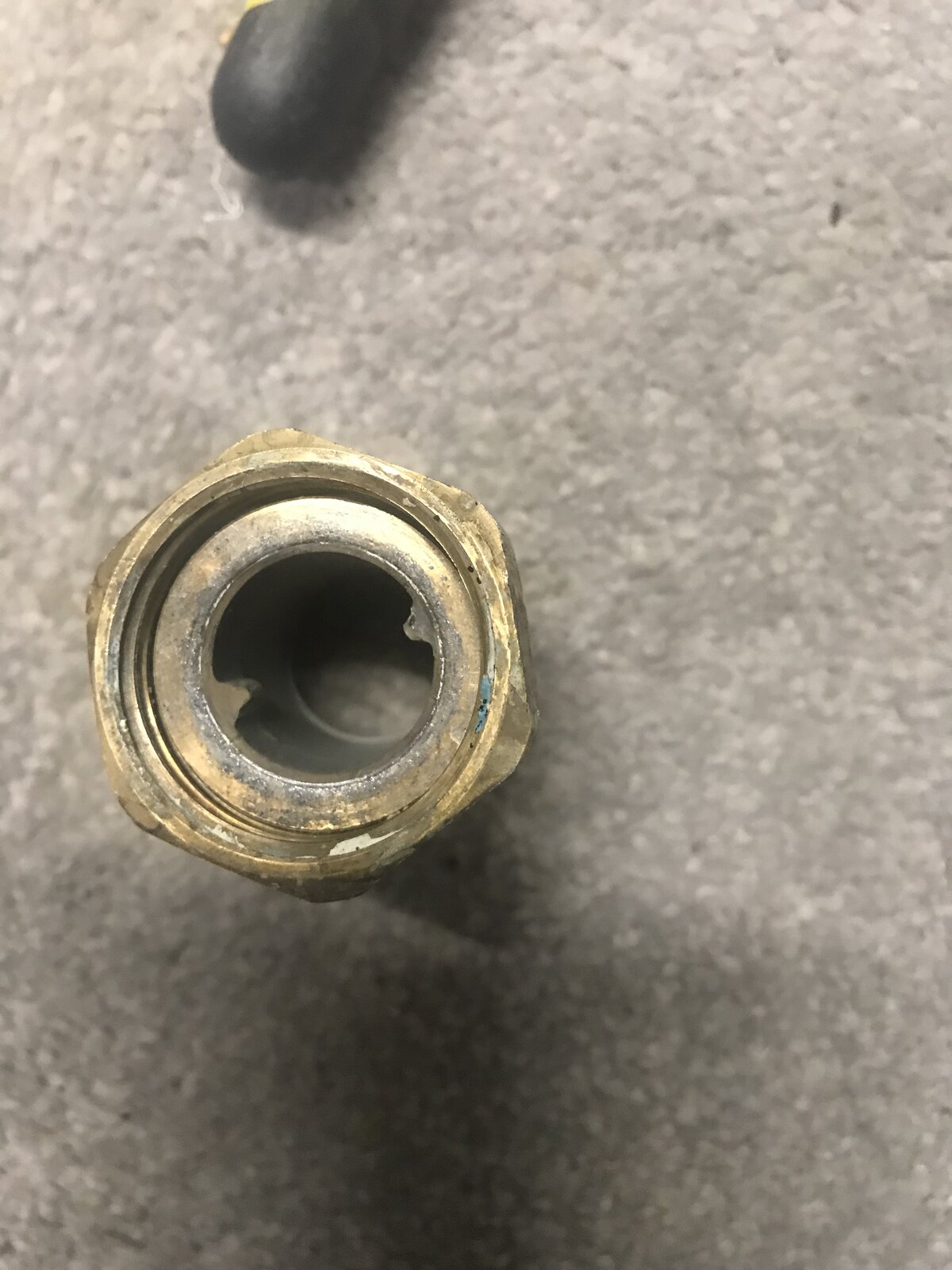

Is the Spud key and a ratchet my only option for these fittings? I don’t own either and wanted to check if there was an alternative approach.
Placed an order for these two and hoping to fix this over the weekend.
But that's just a plain hex key...yoyr picture showed a circular hole with 2 lugs...so you need a corresponding key.
