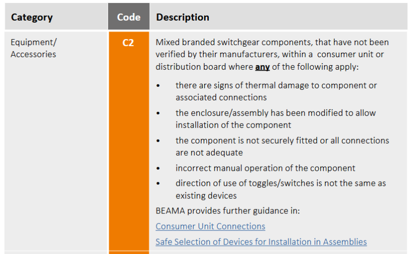

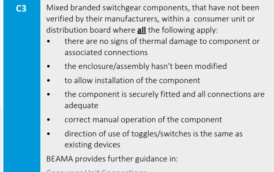

Square D MCBs fitted to an MK board...
They do physically fit correctly, so there has ben no hacking of the front panel, or bending of the busbars, so no IP breach or poor connections have been caused.
Would you code it C2 or C3?
Different make of a MCB only breach manufacturers instructions however a consumer unit will not comply with BS7671 if filled with different makes. Every different type MCB are type tested to their breaking capacity with their own make of devices.
Quick think, the exit point for the arc during a fault current is also manufacturer specific. They will insure nothing impedes this in there consumer units. Fitting different devices in a consumer unit could impede this.
So its a tasty C2.
If it fits perfectly there's no immediate danger and it's not potentially dangerous (is it) but you could improve it if you wanted to.
