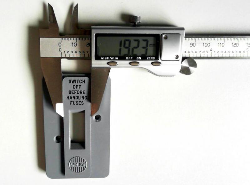

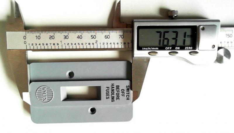

This may be what you want - dimensions (mm) shown are the raised piece, which should be the size of the hole in the switchfuse cover
Have several of these so can post one to you if it's the right size.
That is very generous of you! I have measured, and yes its the correct size.
Not sure if there is a way on this forum to send you a private message as I don't especially wish to publish my email address on the open forum.
I will be happy to pay you P+P for this :)
Cheers
