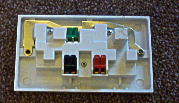

I'm no real fan of 'screwless terminals', so would not be very impressed by that (it takes only a few seconds to tighten a terminal screw), but I've always been in favour of the idea of 'one conductor per terminal', so might be interested in them for that reason. Donkeys' years ago, one could get ones like this (and I still have a couple on my shelf), but (although maybe I haven't looked hard enough1) I haven't seen anything like this for very many years (and sets of 3, rather than just 2, terminals would be even better, in case one wants to run a spur from the socket) ....

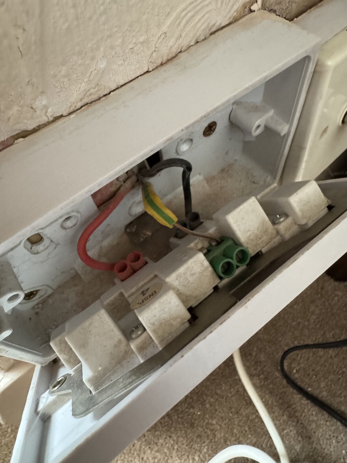

Funnily enough I was looking for images of this socket type as I removed one yesterday as I wondered how old it was?
I replaced it with one of those MK Logic Plus Rapid Fix sockets, I won’t be using them again, the Logic Plus range varies and some versions of the MK sockets are made in the UK and others in Malaysia, I will stick to Hager Sollysta or Scolmore Click Mode.

How old was that old socket you added a picture of?
No idea ... but it's been 'on my shelf' for many years, although I can't recall where it came from or why I happen to have it. However, as you've seen, the L and N connector blocks are coloured red and black, which probably means that it is pre-harmonisation - hence at least 20 years old..
Hang on ... I'll see if it is still there :-) ....
... yep, it is :-) It looks totally unused, but bears very few markings - certainly no indication of the manufacturer. Other than L, N & E markings it has just "Made in England", "PROV PAT" (which I guess probably means "provisional patent"?) and, interestingly for a double socket "13A".
